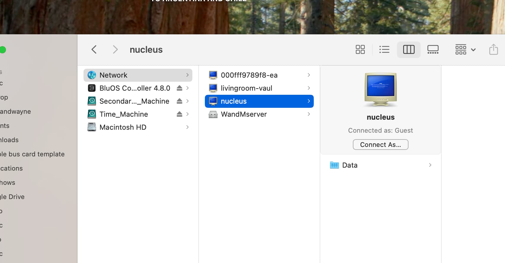

Hi Daniel. Not sure what you did but I actually had Roon working normally for a short time. But it went looking for the network again and became unfunctional.
I checked the network and didn’t find nucleus. But when I went back a few minutes later this is what I saw:

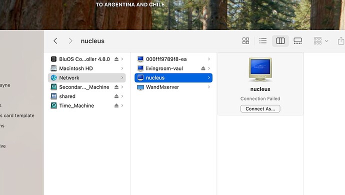

Daniel: Here is another screen shot with failed connection

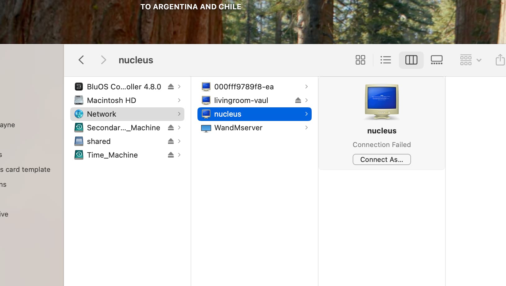

Daniel:
Not sure if first earlier screenshot showing connection got through. Here it is:

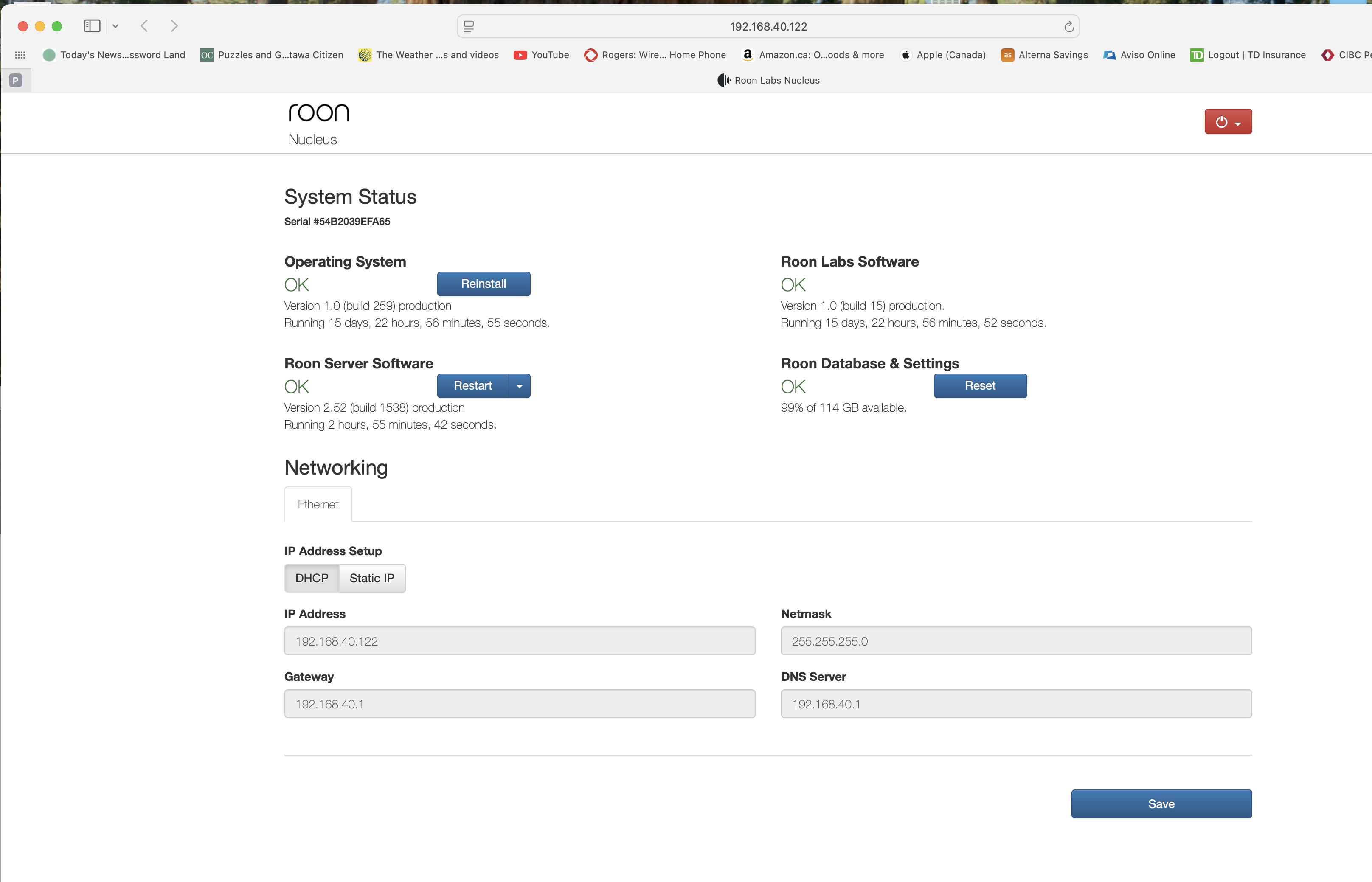

Hi @Wayne_Richardson,
Taking a few steps back here, let’s see if you can access the webUI of your Nucleus - here’s more info on how to do so:
https://help.roonlabs.com/portal/en/kb/articles/roonos-webui
The Web Interface can also be accessed by:
  1. Typing in the IP Address of the RoonOS Device in a Web Browser
  2. Typing the hostname of the device, for example  [url=http://nucleus]http://nucleus[/url]
  3. Typing the .local suffix for the device, for example [url=http://nucleus.local]http://nucleus.local[/url] ,
If you’re able to connect, can you share a screenshot? Thank you!

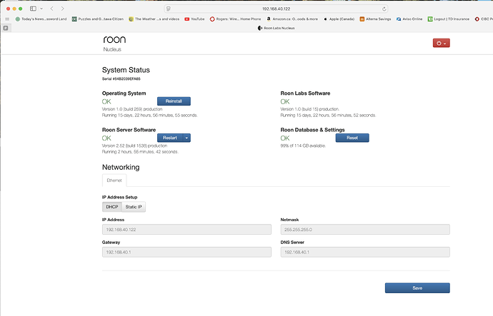

Is this the screenshot you wanted?
Wayne
Benjamin:
That last screenshot was from the desktop.

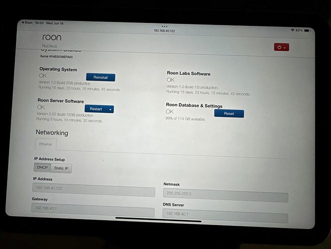

Benjamin:
I rebooted my iPad which gave me a short window to access the web interface. Below is screenshot from my iPad before it locked up:
Not sure if this is useful for you?
Hello @Wayne_Richardson,
Thank you for the update.
Based on the diagnostic data from your account, it appears that your network is segmented into two separate subnets: 192.168.40.0/24 and 10.0.0.0/24. This kind of setup can interfere with Roon’s ability to connect properly across devices.
Could you please provide more details about your network configuration? Specifically, let us know if there are any routes set up between these subnets, and whether any protocols are enabled to allow multicast traffic to pass between them.
