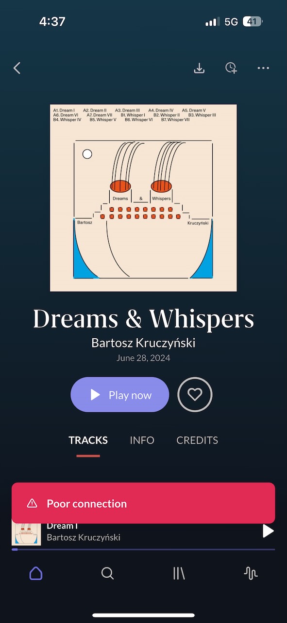

I've been excited about Roon for a long time, but finally signed up a little over a year ago after reading about ARC. As someone who buys a decent amount of digital music to support artists, I thought I would finally have a way to stream my collection both inside my house and on the road. Unfortunately, ARC has yet to pan out for me. This morning, I got Tailscale set up on ROCK and my iphone and I thought I was over the hump. I rebooted ROCK and logged out/back into ARC. Everything looked good! I turned off the wifi on my iphone to give it a test, but unfortunately got the dreaded red banner "Poor connection" pop-up. I read some threads on the Roon community support and tried a few of the suggestions (deleted/re-installed ARC on my iphone, let it sit for most of the day to re-sync my collection), but nothing has helped. I'm hopeful you can help me out! Thanks in advance. I

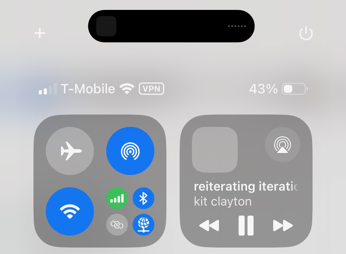

Can you verify that you’re using Tailscale on this phone? iOS 18.3.3 usually shows the “VPN” icon in the status bar when Tailscale is active. If ARC isn’t in the Tailnet, it won’t be able to reach a Tailscale-activated ROCK instance.

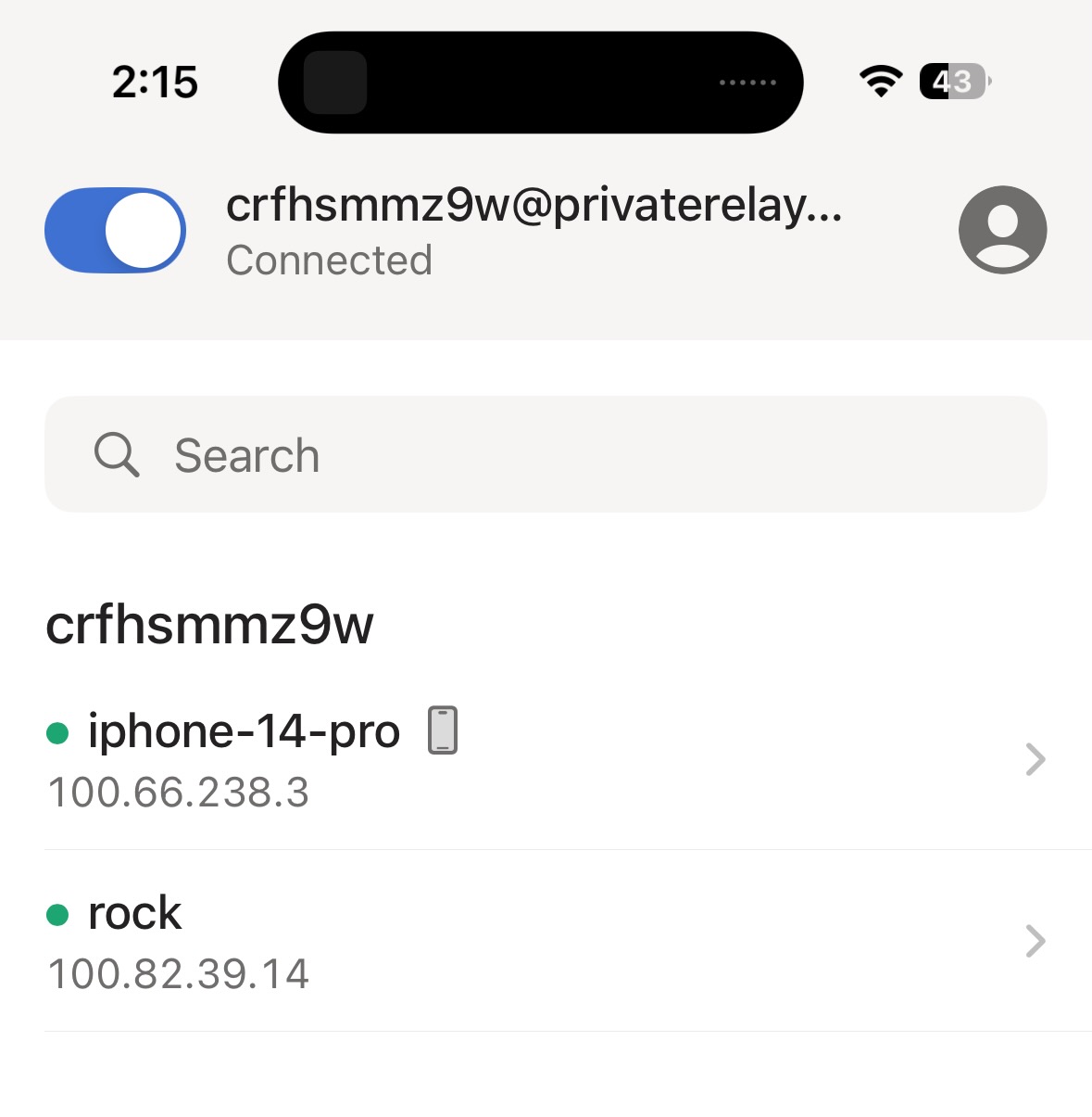

Thanks for the quick responses and suggestions! I’ll try to address them one-by-one. First, the latest iOS version available for my phone is 18.3.1. Yes, I can confirm I’m using Tailscale on the iphone (and on ROCK) and that it’s turned on (see screenshots) below.

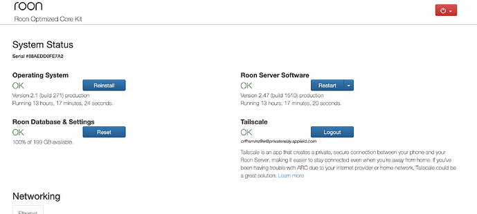

Regarding your question about being signed into Tailscale in the ROCK webui, I think I’m set there too:

However, one last due diligence item. In Tailscale on the iPhone, make sure the VPN-On-Demand settings aren’t automatically switching off the VPN connection when you enable cellular data.
Thanks again, Connor! I checked to make sure the VPN connection isn’t switching off when I turn off wifi (i.e. enable cellular data). I’ll stay tuned and appreciate your responsiveness and the team investigating this. I can’t wait to use Roon while I’m on the road.

Diagnostics indicate the ARC framework records a poor connection state shortly after you disable the WiFi. Based on your screenshots showing a strong 5G connection.
We’re investigating with developers whether the connection is experiencing interference causing timeouts (and its potential cause) or if a connectivity protocol issue is being exposed under these specific conditions.
