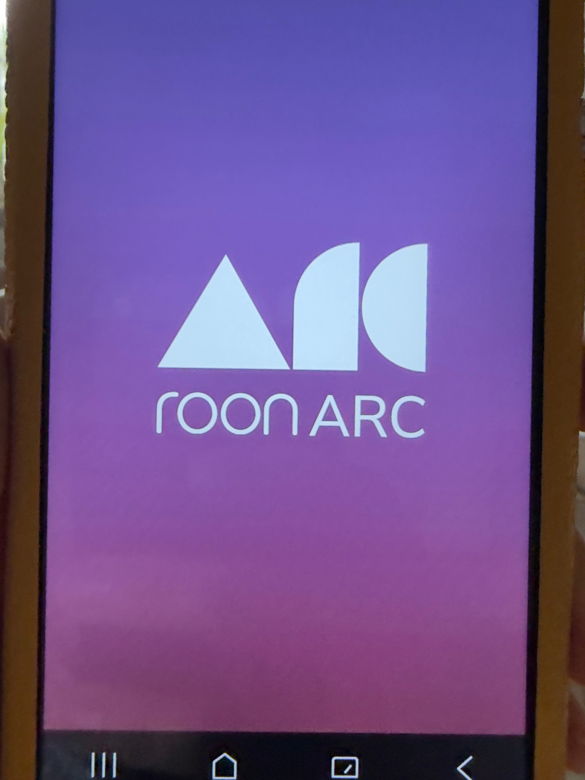

That all what is spine after reinstalling it
Firmware is 1.25CM

Hello @Radoslaw_Goscimski,
Thank you for the photo. That tells us ARC starts but never gets past the splash screen.
Please clear ARC’s saved data and try once more: open Settings > Apps > Roon ARC > Storage, tap Clear storage (or Clear data), then close ARC completely and open it again. On a clean start ARC should show its terms or sign-in screen within a few seconds. Please let us know whether it gets that far or stays on the splash screen, and whether this copy of ARC came from the Play Store or from an APK file.
