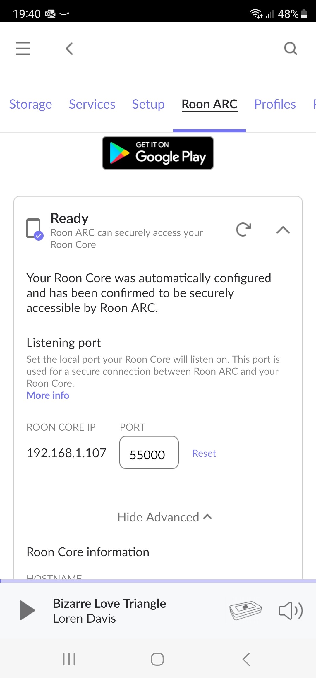

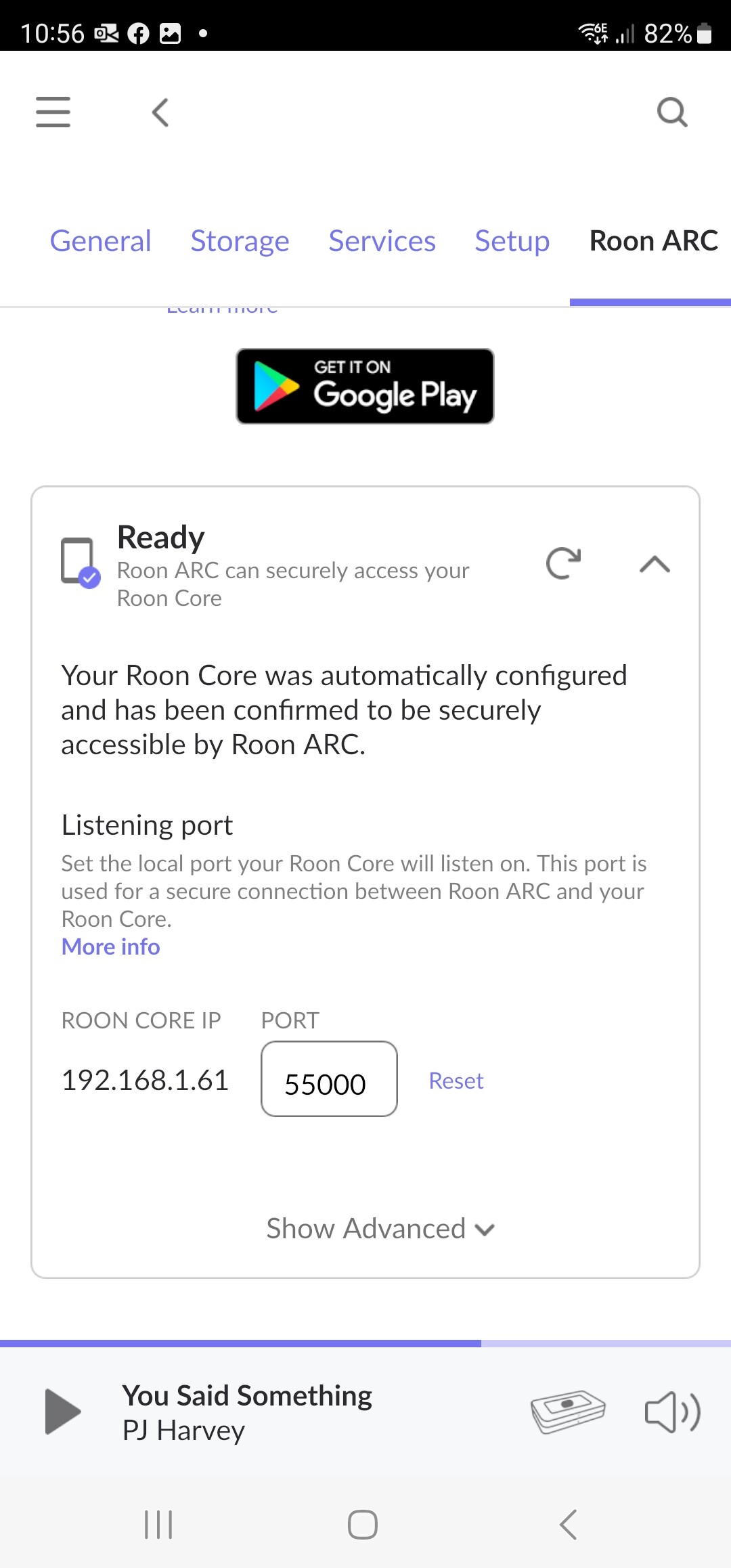

Are you seeing a diagnostic message under Roon > Settings > Roon ARC?
No, it says its all good

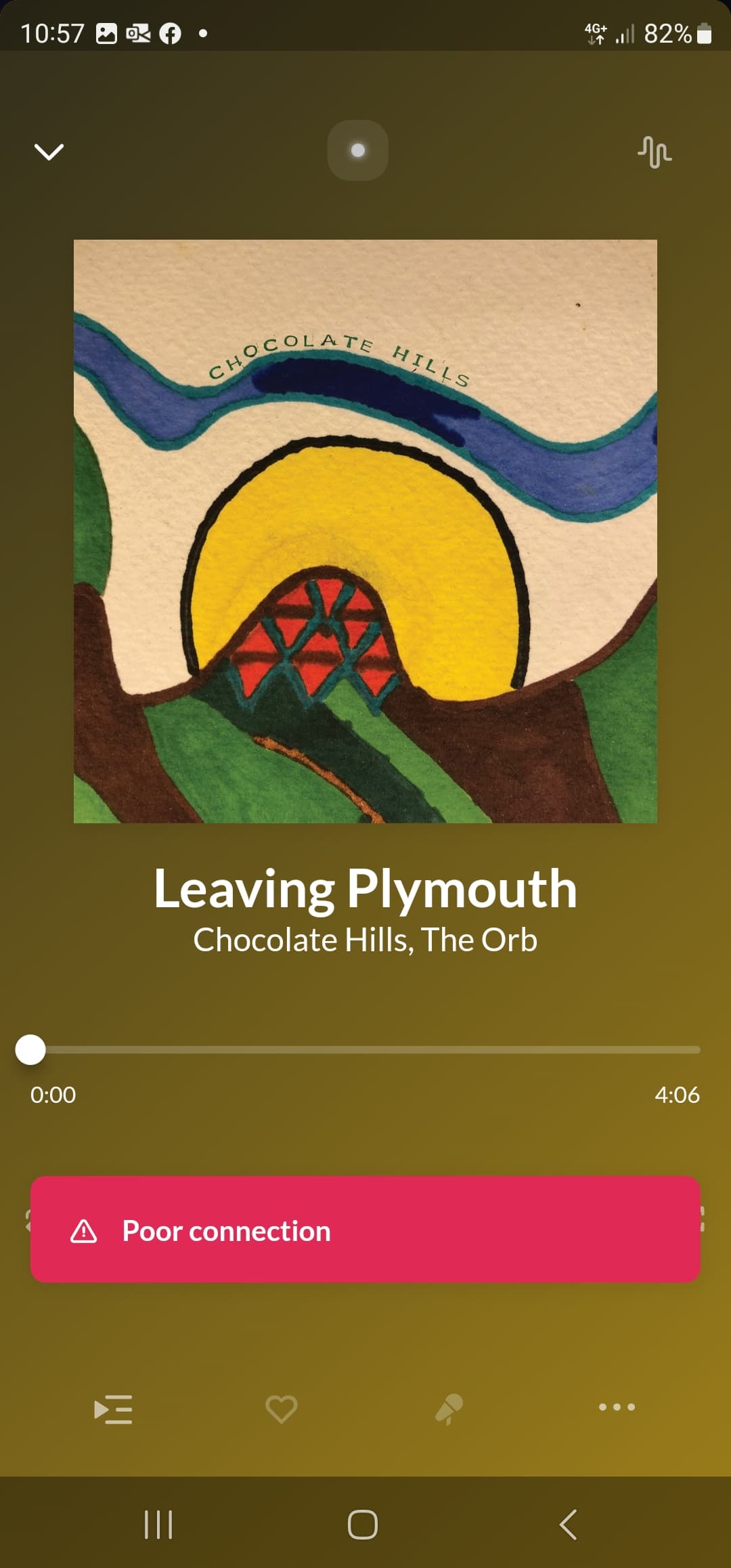

Thanks for writing in and I’m sorry you’re having issues with Arc. While our team continues to investigate this issue, could you please share a specified date and time when you experience the poor connection pop up?
With that, if you could share the track name as well, that would be helpful.

I’ve just changed router and still the same, I’ve got a Vodafone Ultra Hub and I’ve turned on the relevant settings and get the green light in the Arc Settings to say it’s working but still nothing…
Hi… The time stamps are on the screen shots below. Thanks
