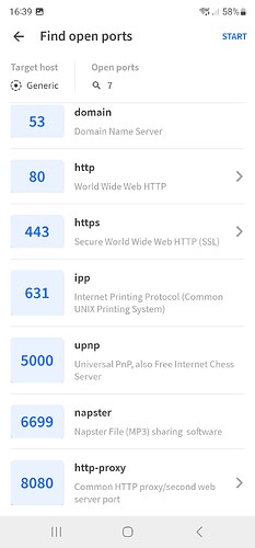

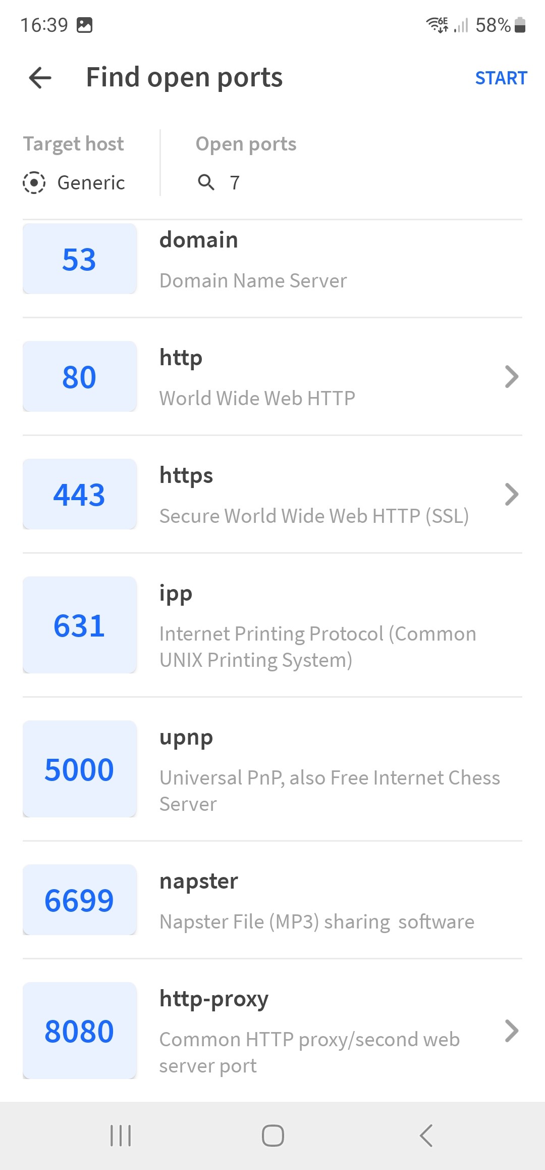

I turned WiFi off and looked and there are 7 open ports but 55000 wasnt one of them. I can’t turn off 55000 off on the dynamic port to open it in static to see if that makes a difference
What are the 7 open ports. There are different port ranges for different things, e.g. some (the lower ones below 1000) are reserved for certain services, the very high ones like 55000 are freely available. ISPs may treat these ranges differently. I’m wondering if there is a pattern to which are open

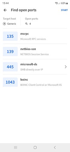

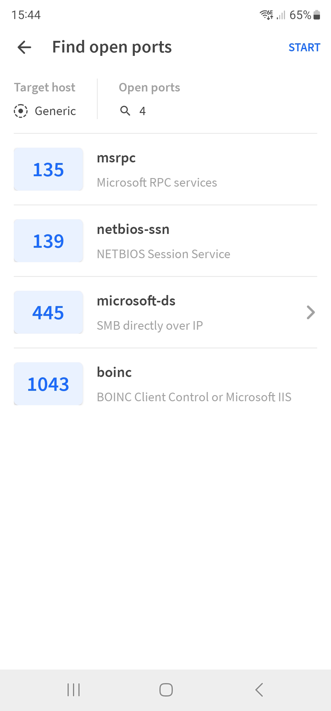

There’s only 4 now, I’ve attached a screenshot, one of the others was my sons chess game
Here are the open ones if I test when my phone is on the WiFi… I don’t know why they would be different
If you phone is on the router’s wifi, i.e., on the LAN, then it’s not affected by which ports the router has open to the internet. So this will show any ports that various software has open on the LAN
OK, so these are all well-known ports and apparently the ISP / mobile provider allows them. They are however, a bit concerning unless you know that you need them open and have them properly secured.
  • Port 135 is the Microsoft RPC Endpoint Mapper service. It is a service that allows other systems to discover what services are advertised on a machine and what port to find them on. It is mostly associated with remote access and remote management.
  • Ports 139 and 445 are NetBIOS and SMB for Windows file sharing.
  • 1043 is either BOINC or Microsoft IIS web server. Are you running an IIS web server?
Anyways, no other ports are shown at all, neither open nor closed. Are you sure that your portscanner app scanned 55000? Many mobile scanner apps only scan well-known ports by default (because a full-range scan is several ten thousands of ports and a lot of traffic). As mentioned, perform a specific scan to 55000 on the external IP. It should appear with some state in the scan result, either open, closed, or blocked.
