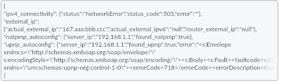

Hello, after installing the Nuleus One server, Arc connected remotely immediately, and after transferring my backups from my PC to the Nucleus server, it is no longer possible to connect remotely. I have the following message: {
"ipv4_connectivity": {"status":"NetworkError","status_code":503,"error":""},
"external_ip": {"actual_external_ip":"167.aaa.bbb.ccc","actual_external_ipv6":"null","router_external_ip":"null"},
"natpmp_autoconfig": {"server_ip":"192.168.1.1","found_natpmp":true},
"upnp_autoconfig": {"server_ip":"192.168.1.1","found_upnp":true,"error":"s:ClientUPnPError718ConflictInMappingEntry"}
Coaxial internet modem, Routeur ASUS RT-AC1900P, serveur Nucleus One
Your roon server shouldn’t be 192.168.1.1, that should be your router. Did you set a static IP?
You might try resetting the One’s network setting. You can follow directions below to reset network settings on it.
Hello @Mario_Langlois ,
That IP address of 192.168.1.1 is indeed your router, it is strange that it shows up in your Roon settings. I suggest to check the Web UI to ensure that you have set DHCP and not static IP as @Rugby suggested.
Hello
By retrying ARC Port Forwarding, as recommended by Roon, I solved my problem. Thanks for your help.
