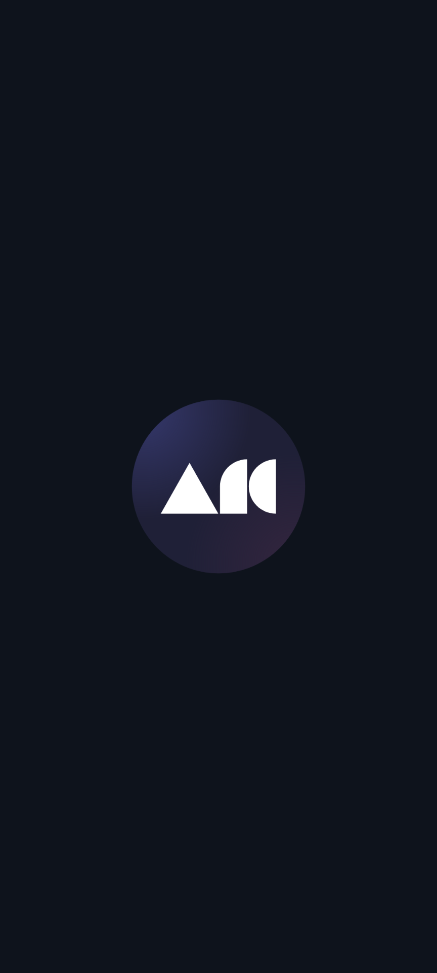

· Router is tplink Archer BE550. Extender is Archer RE315. Computer is connected to the network via cable from computer directly plugged into the router. ISP is Verizon Fios. Tailscale connection is active on both the server and ARC client device (Google Pixel 8). There are no switches or VPNs. Server Computer is GMKTec mini computer with Ryzen 5 CPU and 16 GB RAM

Can you please share a screenshot of what you encounter within the ARC app?
Diagnostics show the initial sync between RoonServer and ARC due to timeouts. Often, this is a sign that the mobile phone’s operating system is imposing data transfer limits on the app itself, usually because the Roon library contains a large number of tracks (over about 100,000).
Have you previously synced ARC without issue on the same device?
I just get the opening screen for Roon ARC and nothing happens. See the attached screenshot. I was able to start it successfully several months ago, then at some point I wasn’t able to. I got frustrated and gave up on it until today. I do have a large library (about 150,000 tracks). Your reply indicates this may be the source of my problems. When does library become “too big”? If I need to cull my drive, what is the upper limit for tracks or gigabytes of storage? Thank you!

We have analyzed the diagnostics for your account and can see that there are no ARC-related entries in our logs.
This suggests that the ARC app on your phone most likely wasn’t logged in.
Could you please try deleting the Roon ARC app from your phone and testing both the APK and the Play Store installations?
