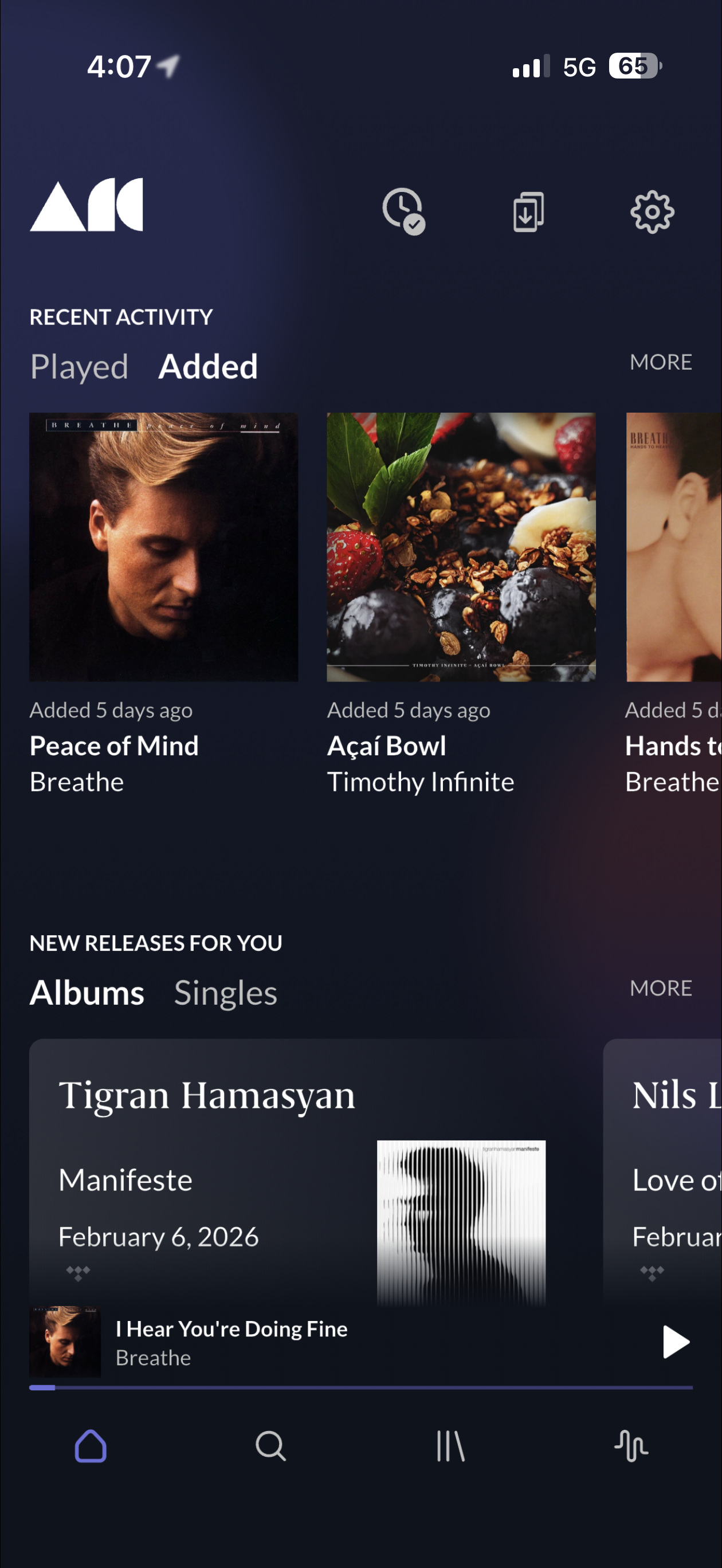

· Roon shows me that ARC is not available from outside my local network, but it is available from outside
· I have nothing, no switches, no extenders, no VPN, nothing
