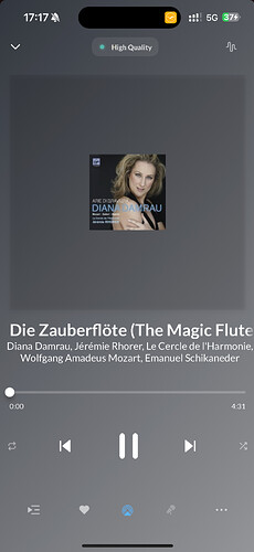

For a screen that should look like this:
the screen is flickering heavily, with sections of the screen on the right upper and lower edge having white squares about 2cm x 1cm of corruption. If you would like the video can you suggest how to send (or maybe allow small .mp4 on the forums?).
