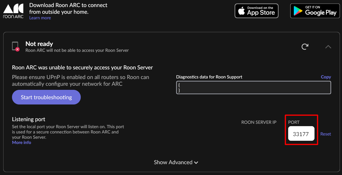

· I have problems with Roon ARC. I have an always On Roon ROCK OS v2.1-build-271 (on an Intel_NUC8i5BEH, ca. 30000 tracks so 'small') where I have installed Tailscale [Roon Server Software v2.62-build-1641]. I have also installed Tailscale and ARC on my iPhone 15.
To test I have turned Off WiFi on my phone and ARC reports “There’s an issue with your Roon Server”.
Roon app on my PC shows (Settings - ARC): “Not ready”. PC is connected to ROCK via Ethernet cable and can of course play w/o problems. Noticed that port no. is not important when using Tailscale (still tried to set it to 0 but no effect).

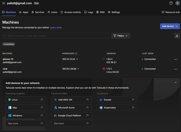

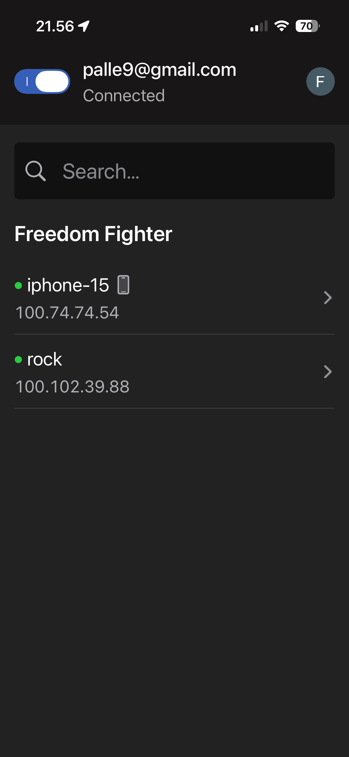

Tailscale.com reports “Done! Your devices can now connect from anywhere” and shows a green dot for both iphone-15 and rock

Additionally, could you share a screenshot of the Tailscale admin panel?

After starting my PC and running Roon-app on it, Roon ARC Port was set to 33177.

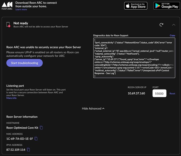

Changing ARC Port to 55000 it looked better, but still Roon ARC is “Not ready”:
“ipv4_connectivity”: {“status”:“NetworkError”,“status_code”:504,“error”:“error code: 504”},
“external_ip”: {“actual_external_ip”:“87.aaa.bbb.ccc”,“actual_external_ipv6”:“null”,“router_external_ip”:“null”},
“upnp_autoconfig”: {“server_ip”:“10.69.37.1”,“found_upnp”:true,“error”:“<s:Envelope xmlns:s="http://schemas.xmlsoap.org/soap/envelope/\” s:encodingStyle="http://schemas.xmlsoap.org/soap/encoding/\“><s:Body><s:Fault>s:ClientUPnPError501ActionFailed</s:Fault></s:Body></s:Envelope>”},
“multinat_autoconfig”: {“status”:“Failed”,“error”:“Unexpected uPnP Control Response - See Log”}

  1. Ignore the “Not Ready” Error
Since you are using Tailscale, you can safely ignore the red “Not Ready” message and the JSON error in your Roon settings. That test only checks for traditional Port Forwarding. Tailscale creates a private “tunnel” that bypasses the need for open ports entirely.
Furthermore, your logs show a UPnP request to 10.69.37.1, which suggests you are behind CGNAT (a shared ISP IP). In this environment, standard port forwarding usually fails, making Tailscale your best option.
