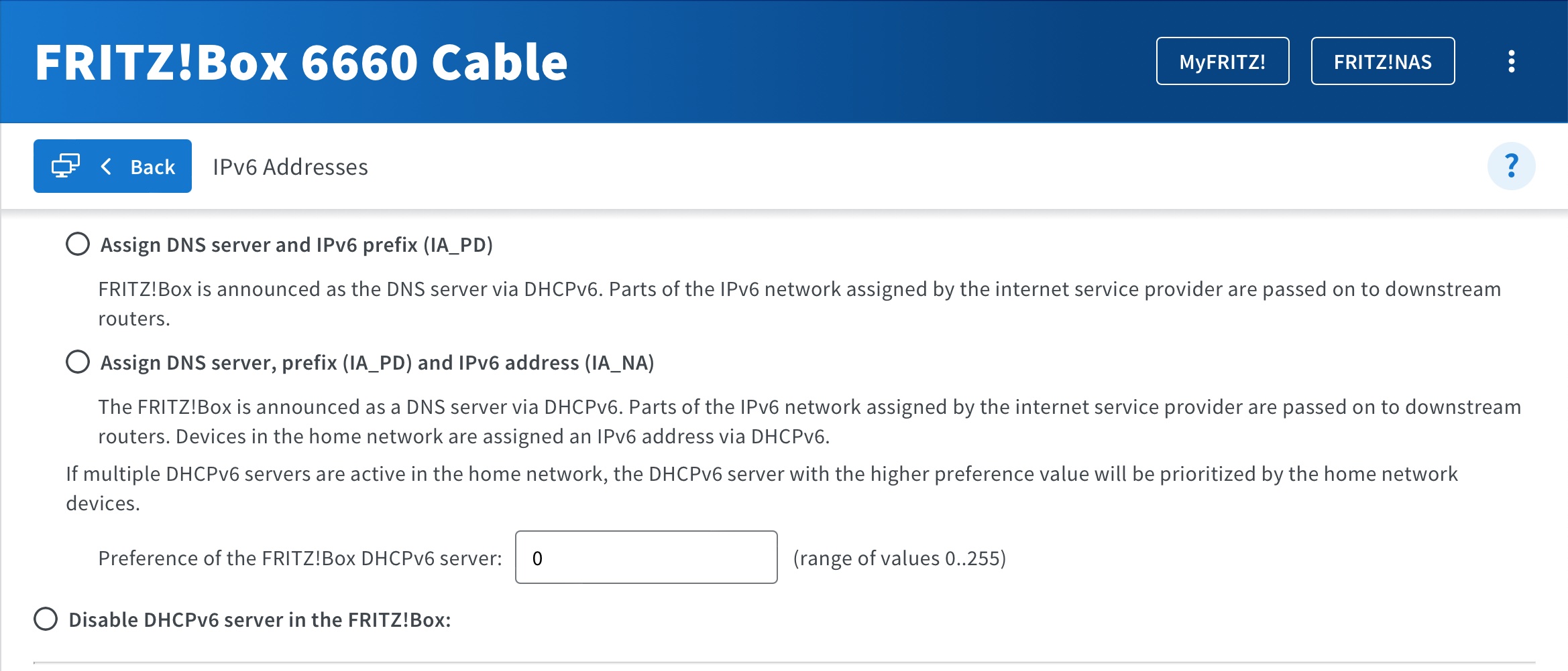

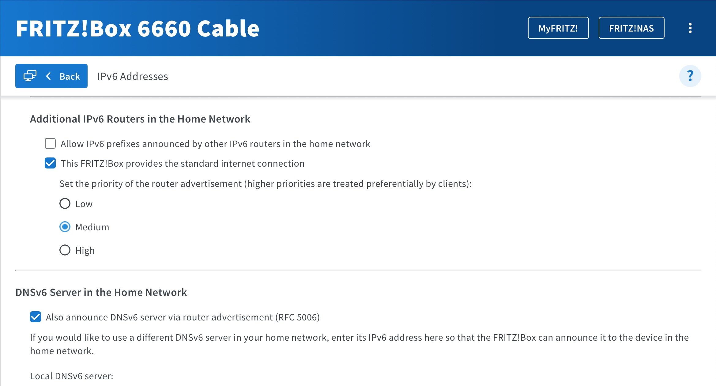

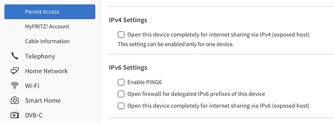

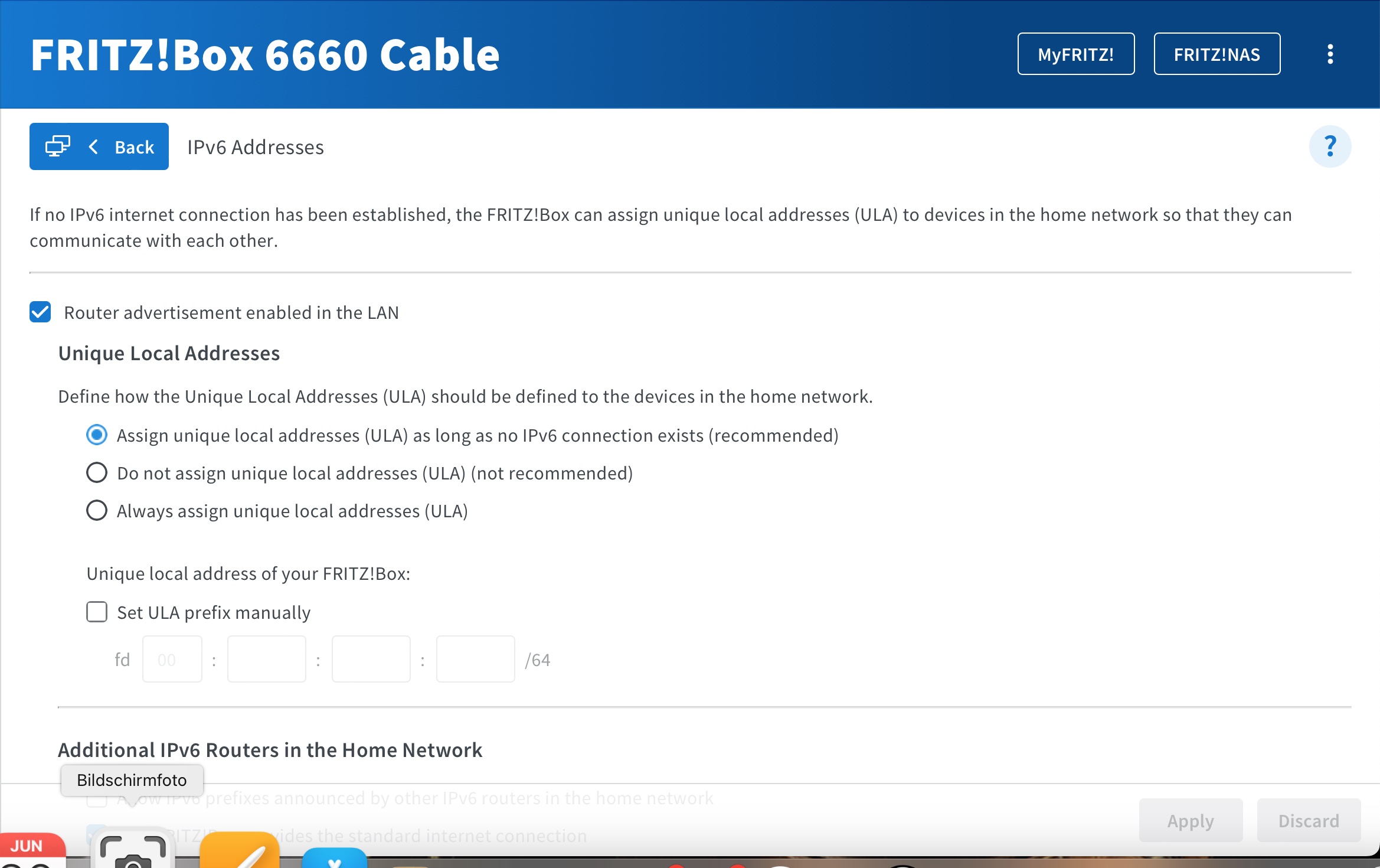

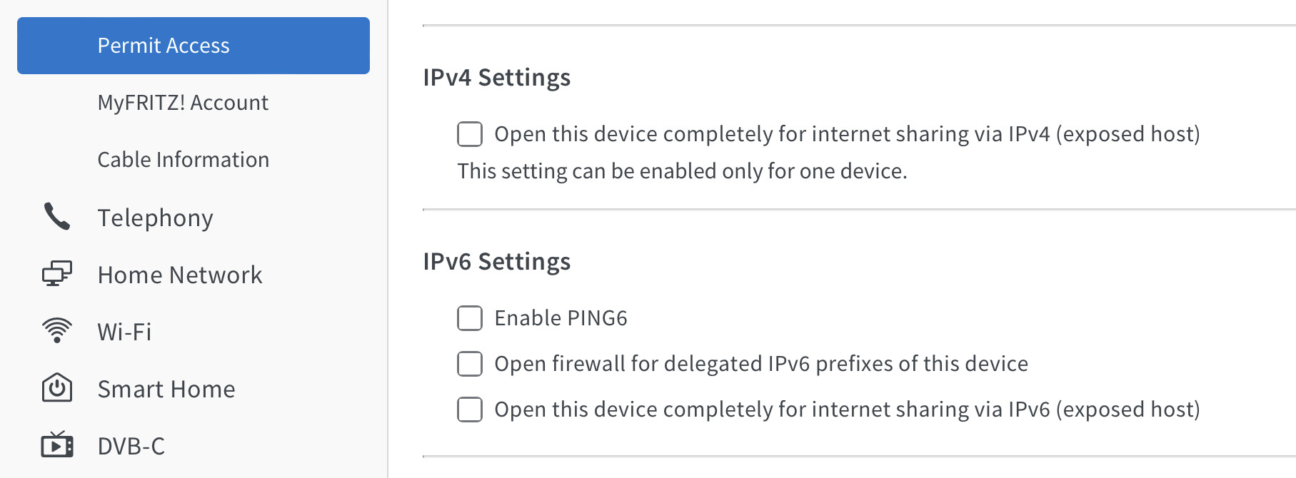

Thanks for your assistance! @connor
Please find some screenshots of the section below. As I donā€˜t know if this is security relevant I have removed the ā€žLocal DNS Serverā€œ address from the screenshot.
My mobile provider is Deutsche Telekom/T Mobile.
@connor could you pls have a look at the screenshots you requested?
Thanks in advance!
Hi @Tom_Kramer,
Thank you for your patience. Please try enabling ā€œAssign DNS server and IPv6 prefix (IA_PD)ā€. If Vodafone is properly prefixing, then you should be able to reach ARC via the available IPv6 address.

Thanks for the advice @connor , but it did not change anything unfortunately. It is still the case that the Roon remote app shows that ARC should work and then ARC states that the Core cannot be reached…

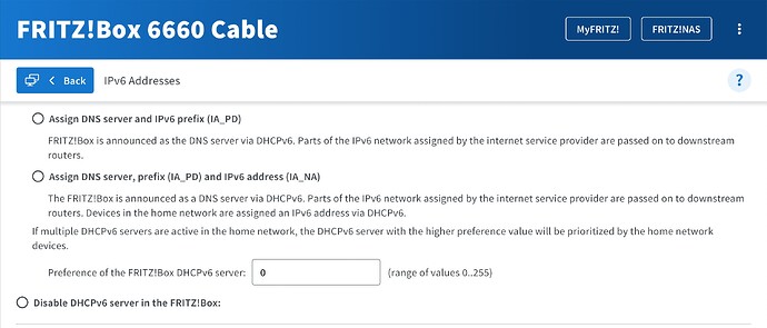

@Tom_Kramer, there’s likely something still improperly prefixed. I suggest you try enabling the other settings related to IPv6 Prefixing - Assign DNS Server, Prefix (IA_PD) and IPv6 Address (IA_NA). and performing router restart.
Thanks @connor I will try that today.
Besides the settings you are referring to, are these of any relevance?
Edit: The 3rd option you mentioned as to Prefixing does not work either (after router restart), unfortunately.
