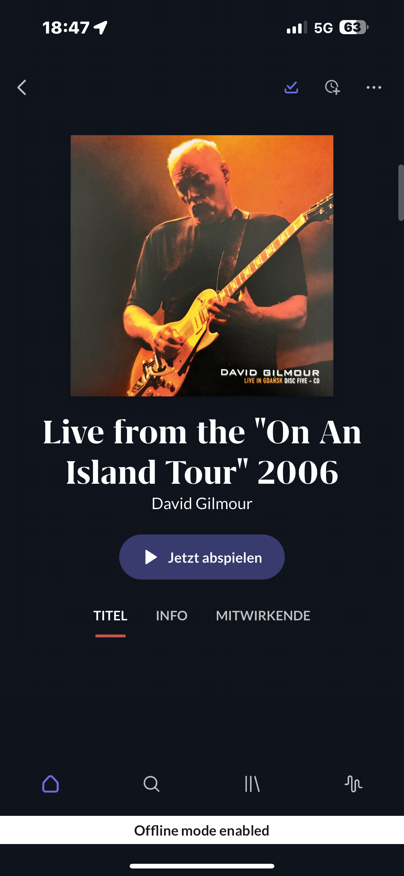

Why is ARC not playing my downloaded files, once i leave my home WLAN? I thought ARC is exactly capable of this, but hitting „Play“ or accessing the Downloads-Folder in ARC, the app remains dead silent.
I have enabled the „Offline-Mode“ checkbox, but same Problem.
What’s going on here?!

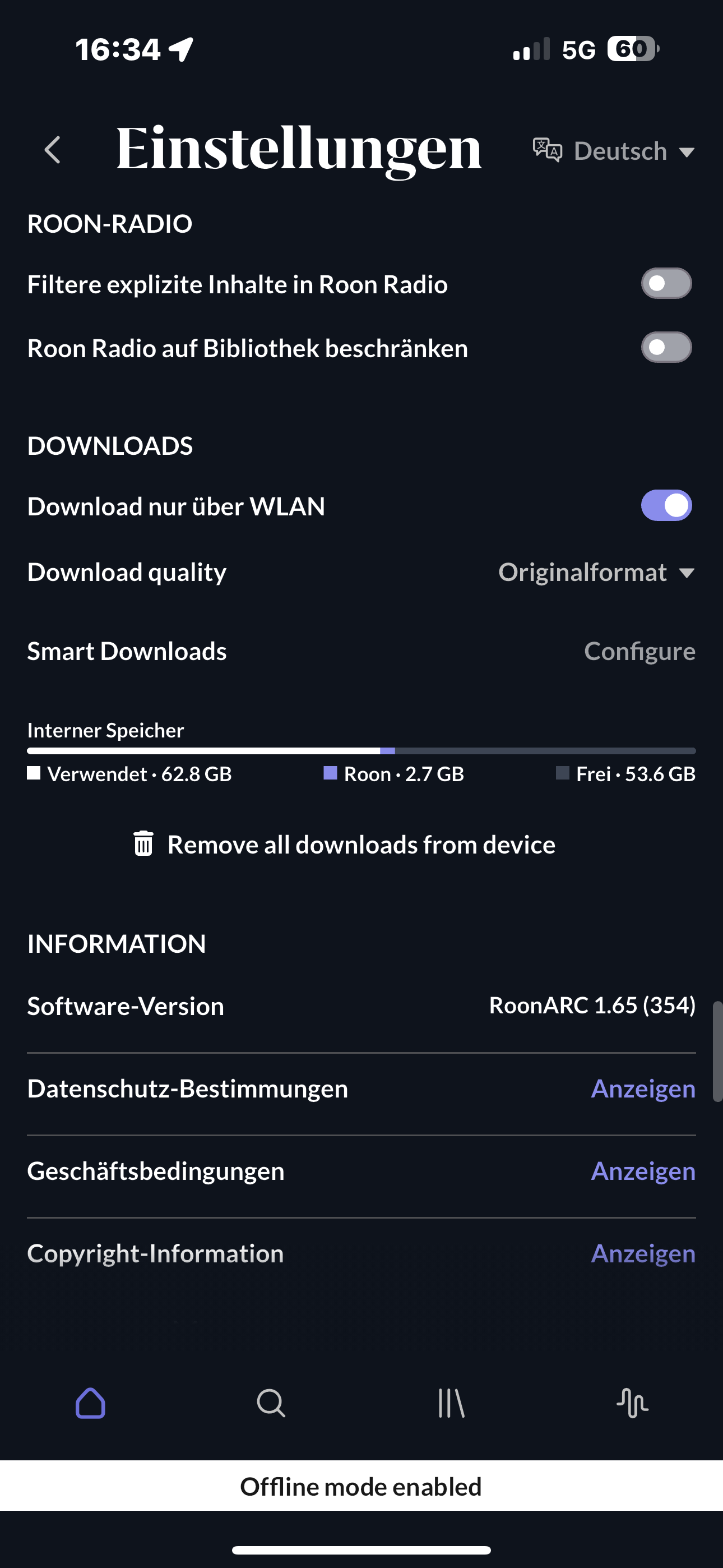

Thank you for your report. That’s definitely not expected behavior for ARC, as anything locally downloaded to the phone should be accessible in Offline Mode. Just to confirm, is there available storage space in ARC Settings?

Hello Connor, thanks for your reply. Enclosed find a screenshot, there is plenty of Space left, so all downloads were saved.
Unfortunately, logging out and back in of my Room Server did not help., I have tried this last week.

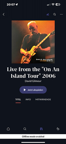

When you click on tracks under the album cover on the phone, are the tracks there?

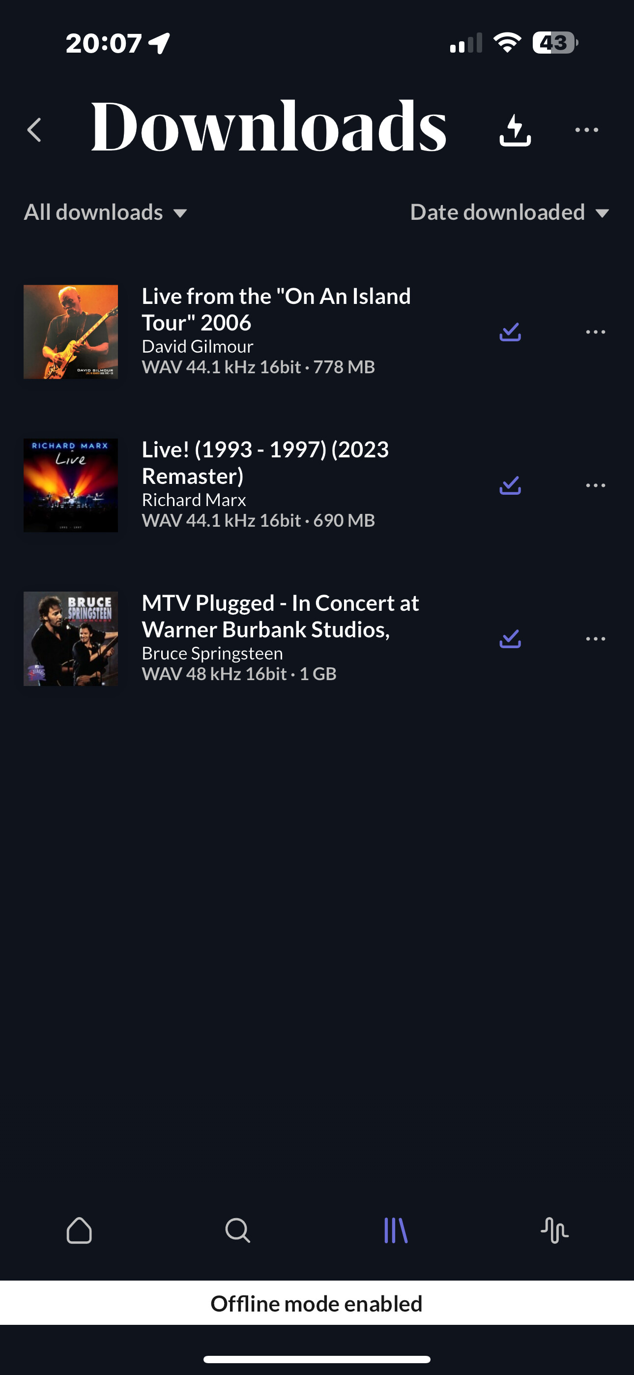

No, there are no Tracks at any time visible once my Roon server ist off. The Tracks only appear with the downloaded tracks when I am connected to the Roon Server.
With the enclosed screenshots you can see that all three Albums are downloaded completely and there are no tracks visible whatsoever.
