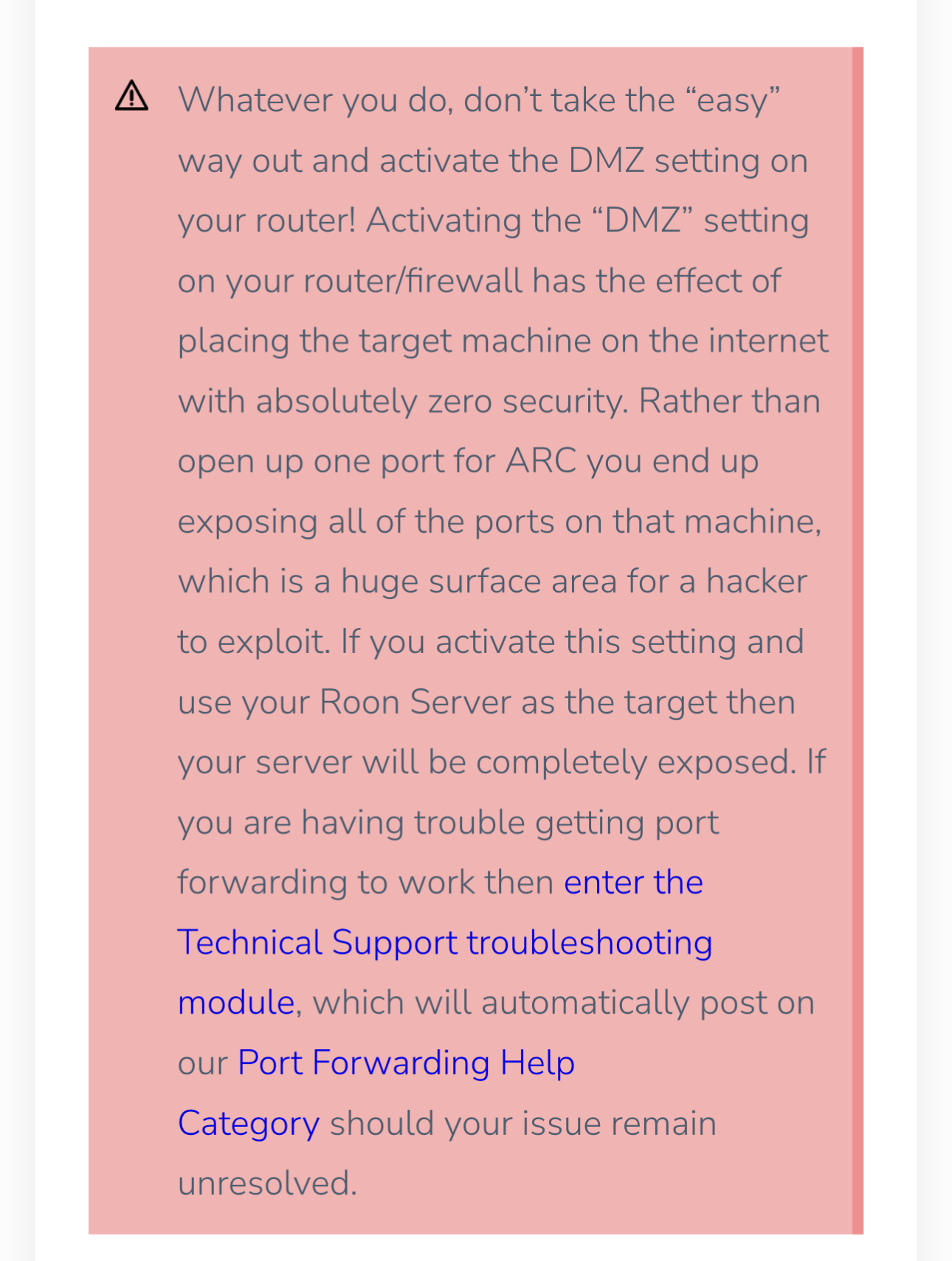

We tried using the DMZ to point the router, but that didn't work either!

Please don’t do that and turn it off again. It exposes your whole machine to the whole internet without protection
From:
The problem is this in the error message (and DMZ doesn’t help with that anyway):

First off, it’s imperative that you re-enable the router’s firewall and not expose any of your devices by placing them in the DMZ. This is your home network’s basic line of defense against intrusion from the broader internet, and you don’t need to disable it for ARC to work.
