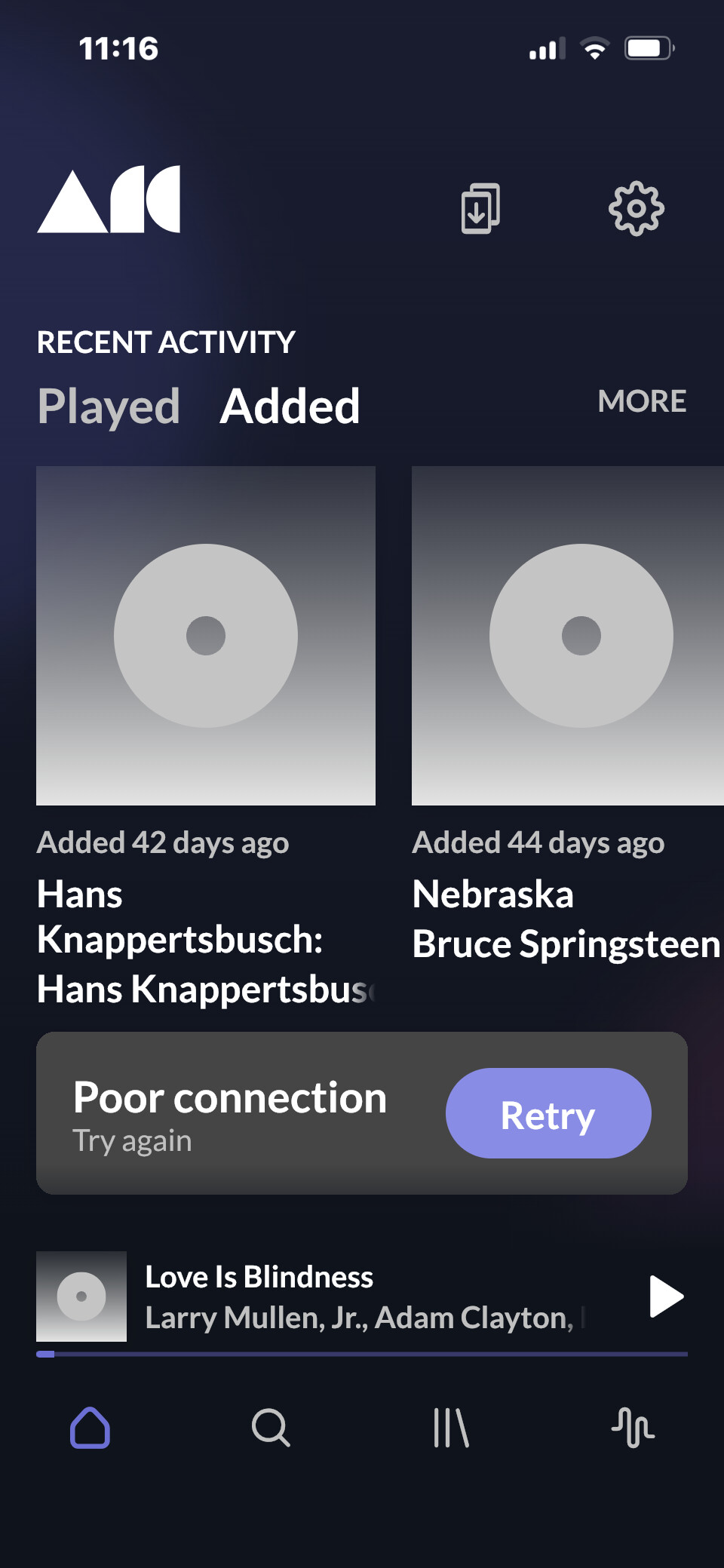

ARC: Poor Connection Popup after Updating to ARC MUSE release [Update ARC]
I have a connectivity problem with ARC away from home I receive poor connection’ message. I then try Qobuz or Spotify and no issue is present. It’s particularly annoying, but doesn’t happen all the time. Any ideas on how to rectify please :pray:
