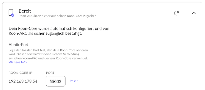

ARC - Roon software states all is good for ARC, but my mobile can not connect
Fritzbox 7590 with provider 1&1 in Germany
  • Configured for UPNP Status transfer
  • Roon Core with IPV4 and IPV6 (HTTPS, Port 55002, TCP) – both port releases show “Green”
The Roon software shows, that it is ready (Roon-ARC can safely access my Core, My core has been automatically configured and Roon-ARC is confirmed for save access)
So far, all good

So there is no diagnostic message on the Roon ARC tab in Settings?
Yes, the ARC tab in the settings says all is good.
