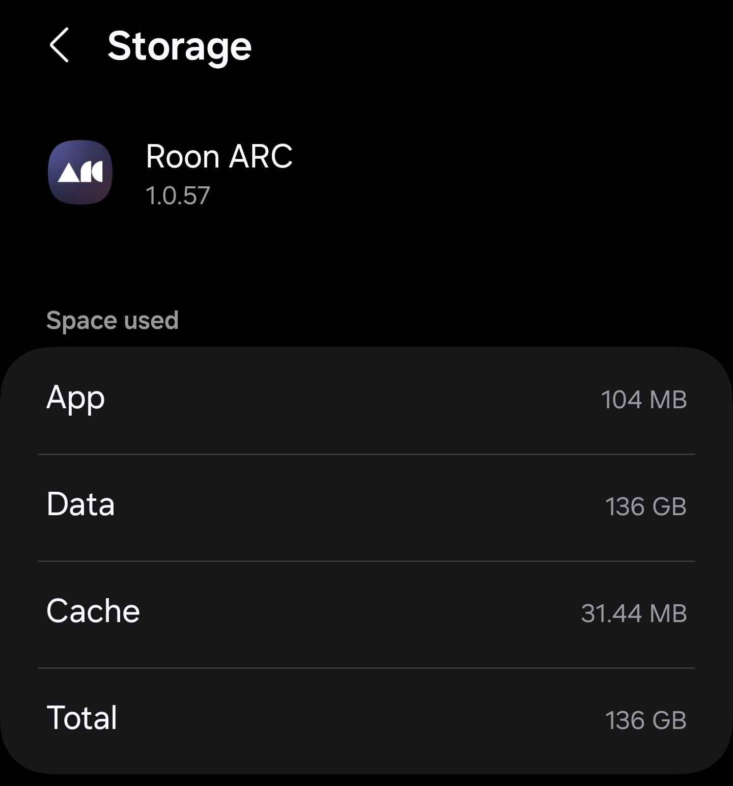

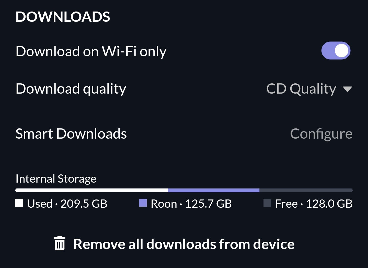

I started to use smart downloads a few months ago. Even though I allowed Arc to use 220GB of storage, it only used 125GB in total, while my phone still has plenty of storage left. Screenshots below.
I’m sure that it’s not that the downloads are throttled, because A) it’s been like that for months. B) at some point I removed some downloaded albums and Arc downloaded other albums instead to take up the freed storage, but it still reached the same limited capacity which is a lot less than I configured.
What’s going on here?

Hi @Chikolad,
In logs, ARC reports only 0.048GB available for SDL on the phone, not the 128GB listed in the second screenshot.
We’re syncing with development to determine what’s happening and will report back as soon as possible with further clarification.
Thanks @connor!
I will add that the phone itself reports 136GB of available space.
