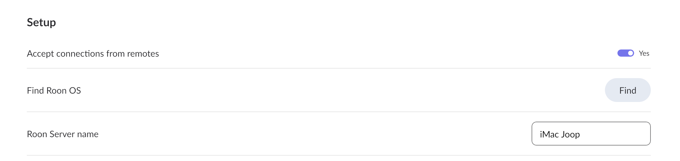

When I look into the setup, the iMac cannot find the Roon OS (no idea if this has something to do with it?)
