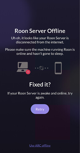

This morning Arc stopped working and shows this message:

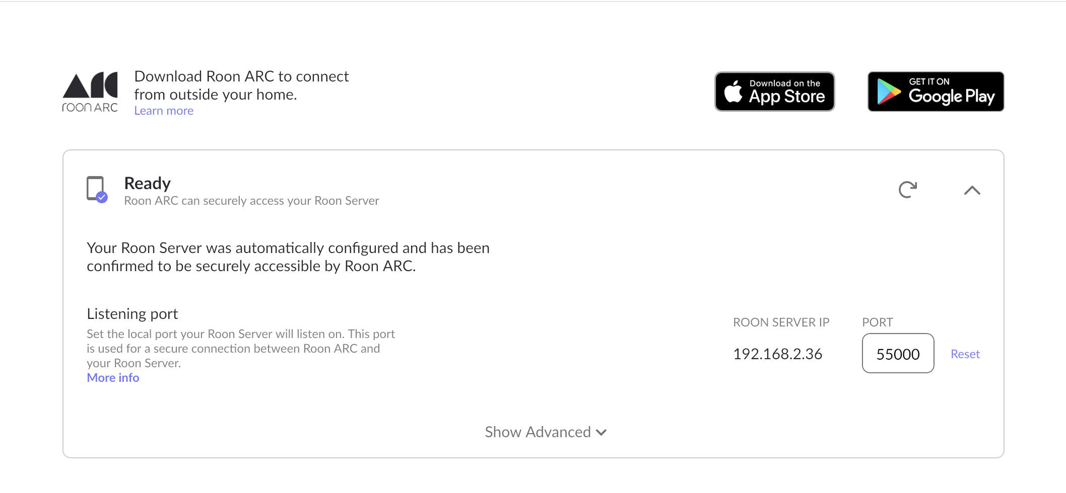

Retrying does not do anything. Restarting phone brings up same message. Restarting Roon server (on Mac) and testing Arc gives this confirmation:

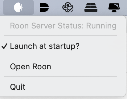

Roon server is confirmed as running:
