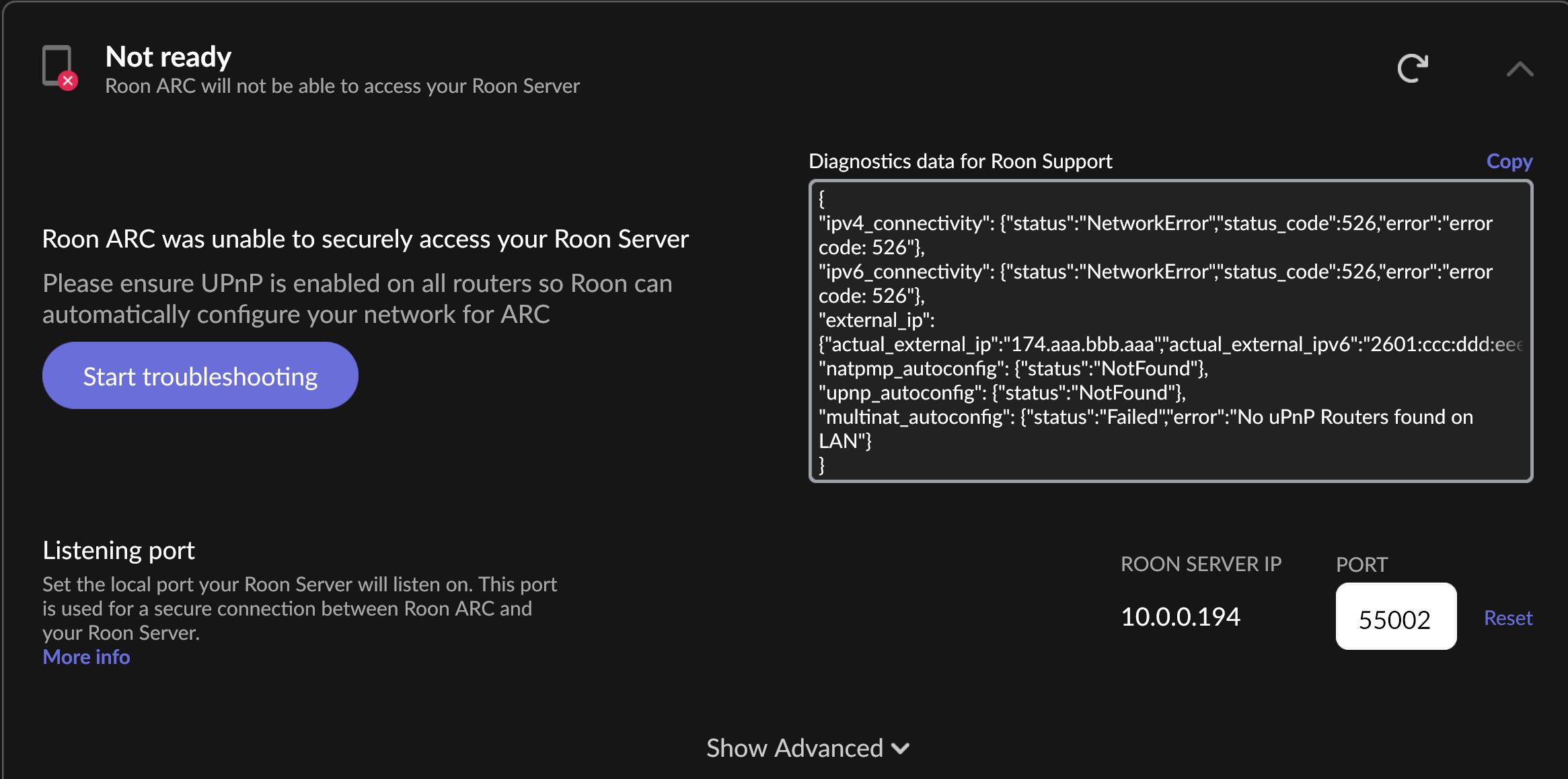

I’m also having the same issue:
“ipv4_connectivity”: {“status”:“NetworkError”,“status_code”:526,“error”:“error code: 526”},
“ipv6_connectivity”: {“status”:“NetworkError”,“status_code”:526,“error”:“error code: 526”},
“external_ip”: {“actual_external_ip”:“194.aaa.bbb.ccc”,“actual_external_ipv6”:“2a07:ddd:eee:fff:ggg:hhh:iii:jjj”,“router_external_ip”:“null”},
“upnp_autoconfig”: {“status”:“NotFound”},
“multinat_autoconfig”: {“status”:“Failed”,“error”:“No uPnP Routers found on LAN”}
Additionally, here, ARC does not even work when connected to the home network. Edit: Disconnecting, clearing ARC storage and cache (I use android) and restarting ARC fixed the local connection issue but the outside access issue remains.

Update:
After doing the clean restart of ARC (after clearing ARC storage and cache on android), I have found that ARC will connect to my server when my mobile is connected through cellular and works fine.
However the normal Roon client Roon ARC settings page continues to report ‘Not Ready’ with the 526 error.
Thus this would appear to be a fault in the connectivity test rather than with the connectivity itself.

Just a heads-up: the “Error 526” that @Wade_Oram is seeing is actually a widespread display glitch on our end right now. Since your issue has been going on for a year, yours is almost certainly a local configuration setting rather than a cloud bug.
@Leighton_Freeze Since you are using the Xfinity XB8, the “Advanced Security” feature (usually found in the xFi app) is the most likely culprit here—it loves to block ARC. Definitely try turning that off temporarily to see if the connection goes through.
Also, regarding Tailscale: if your “Poor Man’s Nucleus” is running Roon OS (ROCK) in UEFI mode, you can use the tailscale.https://help.roonlabs.com/portal/en/kb/articles/tailscale-setup-instructions-roonos-roonserver
@Wade_Oram please ignore the 526 error code for now—it’s a red herring. Since you are on OPNsense and it’s actually failing to connect remotely, just double-check that your WAN firewall rule matches the port listed in Roon Settings > ARC. Sometimes Roon decides to reset that port back to default (55000) after an update, breaking your manual rule.
