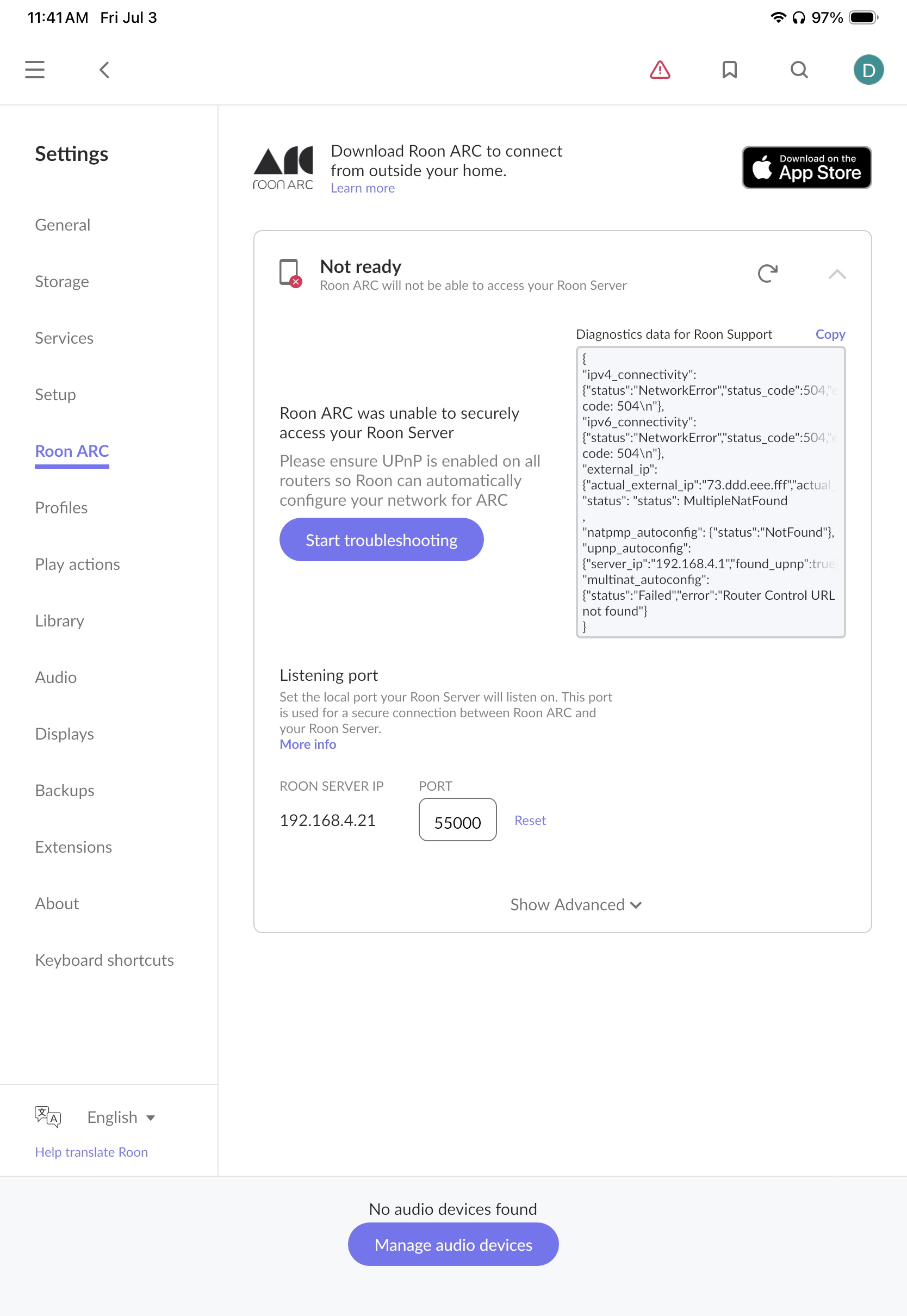

· I’m no expert and I think this is a bit complicated. I have an Arris G36 router which feeds an Eero mesh network and I also I have a Ring Gateway Pro - which I think provides cellular backup for Ring devices. It looks like I have multiple NAT issues, but no idea how to fix

ARC not reaching your Roon Server after a move usually points to the new network layout rather than ARC itself. With an Arris G36 feeding Eero, plus the Ring Gateway Pro in the mix, you may be dealing with double NAT or even triple NAT which can block inbound connections to Roon ARC.

I was able to get ARC to see the Roon server. Not sure if this was best way, but I was able to enable port forwarding on the ISP modem upstream from Eero which also has port forwarding enabled

Glad to hear ARC is working! The double port forwarding setup (on both the ISP modem and the Eero) can work but is not ideal long-term - you have double NAT between the Raspberry Pi and the internet. If you ever run into issues again, the cleaner fix would be to put the Eero in bridge mode so only one device is doing NAT, then set up port forwarding just on the ISP modem.
