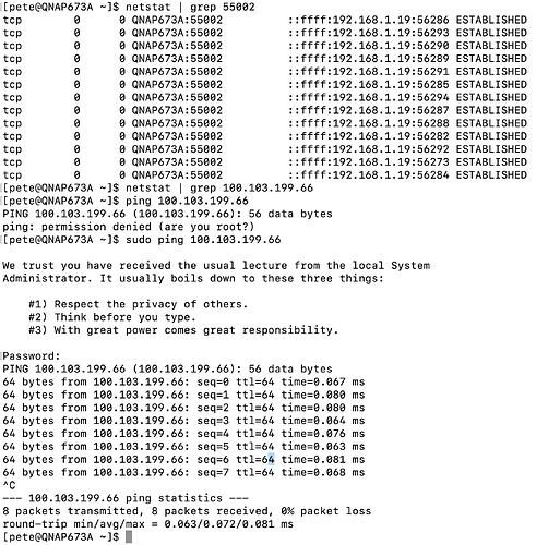

I’ve verified that the VPN is active and working on my iPhone but the packets sent from it through the Tailscale VPN are timing out when sent to the Roon Server and work fine to 8.8.8.8 with help from Tailscale support. They have indicated the WireGaurd tunnel is functioning as expected. It appears ARC is still using port 55002 even after setting the zero in the ARC setting. Here’s how things look using SSH to interigate the QNAP server (192.168.1.19 is my iPhone on the local network and 100.103.199.66 is the address Tailscale assigned to my QNAP server machine:
The problem is QNAP supplies an old problematic version of Tailscale in its app center. I pull the most recent stable image and it worked out of the box
