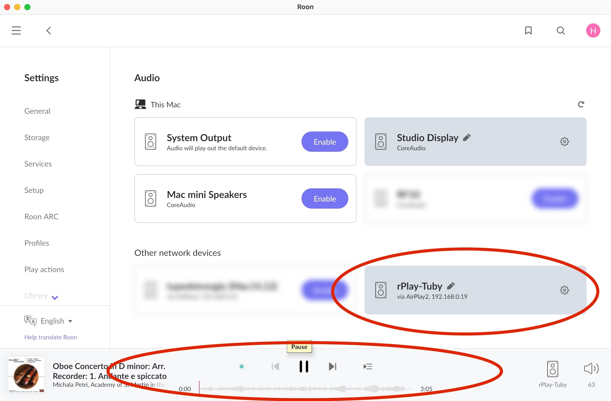

I am using an ARCAM rPLAY which appears as an AirPlay device on my network. In Roon I can see the device as well (in the Audio list).
However when I try to play music in Roon through it, the music never starts.
I'm using a Netgear D6200 router after an NBN box. Roon server (on Synology NAS) is cable-wired to the Netgear, Mac mini with Roon client (used as its own audio endpoint as well) is cable wired too. ARCAM rPLAY is cable-wired. iPad and iPhone WIreless connected to Netgear.
I’m adding a screenshot of the Mac Roon client:
It shows both the rPlay appearing in the Audio List and the music is not playing through the device despite being the selected zone.

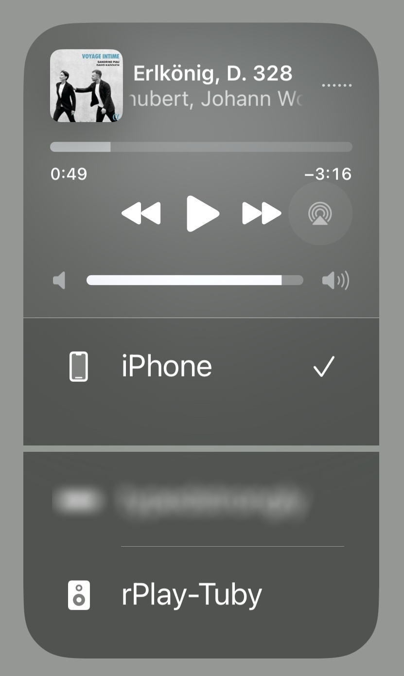

Also, I can access the ARCAM streamer as an AirPlay device from my iOS devices:
And I can play through it too (even in Roon Arc!). This indicates that the firewall works fine. So I guess, the issues are very much Roon Audio Zones-related. How can I solve them?
