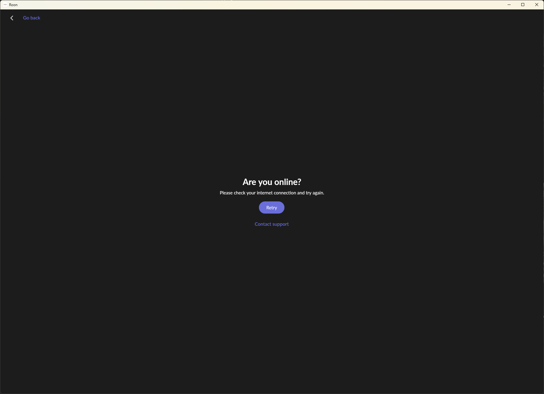

'Are you online?' displayed until server restart (ref#54YEDF)
'Are you online?' displayed after a day until roon server service is restarted
Wired Ethernet, Roon Server on a Linux VM with dedicated and fixed IP address and DNS hostname setup

Is this entry about the broker failing to authenticate maybe related to this issue?
12/14 16:37:26 Trace: [Broker:Misc] [broker/accounts] Updating Machine Allocation machineid=54da9762-e473-58bb-35a8-ba86358ffdb8 hwserial= machinename=linux-host-1 machinetype=Server
12/14 16:37:26 Trace: [Broker:Misc] [fiveaccountserver] POST https://accounts5.roonlabs.com/accounts/3/machineallocate
12/14 16:37:26 Trace: [Broker:Misc] [fiveaccountserver] BODY token=68cb4383-0a7c-4220-a6d6-685242e5a54f&machine=54da9762-e473-58bb-35a8-ba86358ffdb8&name=linux-host-1&type=Server
12/14 16:37:27 Debug: [.NET ThreadPool Worker] [easyhttp] [1849] POST to https://api.roonlabs.net/accounts5/accounts/3/machineallocate returned after 207 ms, status code: 200, request body size: 117 B
12/14 16:37:27 Trace: [Broker:Misc] [fiveaccountserver] GOT {“status”:“Success”,“licenseid”:“99ca764a-d50b-4854-b08b-bc49e9be2abe”}
12/14 16:37:27 Warn: [Broker:Misc] [broker/accounts] failed to auth: Result[Status=Unauthorized]

I don’t think it’s any network or VM configuration in my case since the server returns without issue when restarted. I don’t have a solid theory what this could be cause by but I would like to exclude that the following lines in the logs are a symptom of something failing that shouldn’t:
It looks like some kind of machine registration (probably to enforce a single server per license / account) succeeds.
The next line however seems to indicate a failure in the same subsystem Broker:Misc:
Is that something you and other users with reliable servers are seeing as well?
