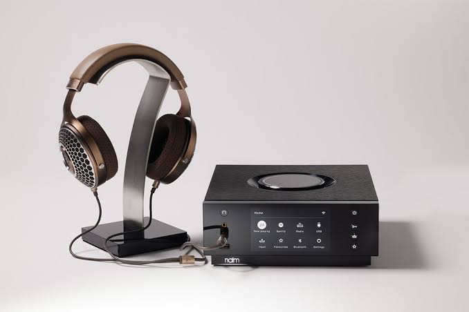

Naim Uniti Atom HE , perfect just add power , network, and a pair of headphones , maybe even the focal Clear Mg
Minimalist but …
