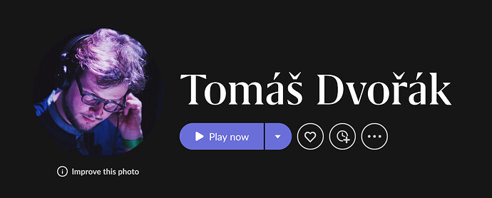

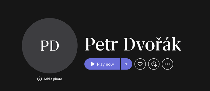

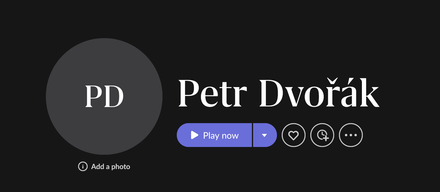

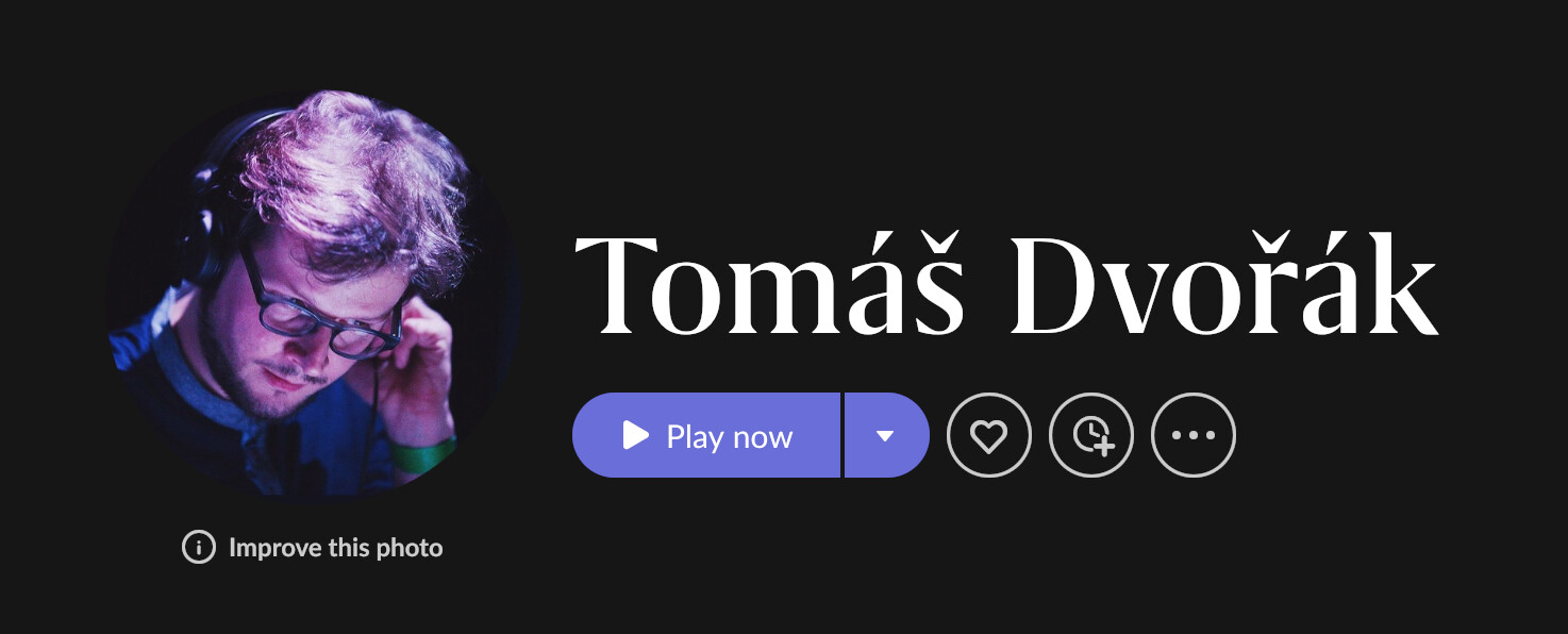

Hmmm, I don’t know if it’s the accents. For instance, I can edit these guys without a problem:

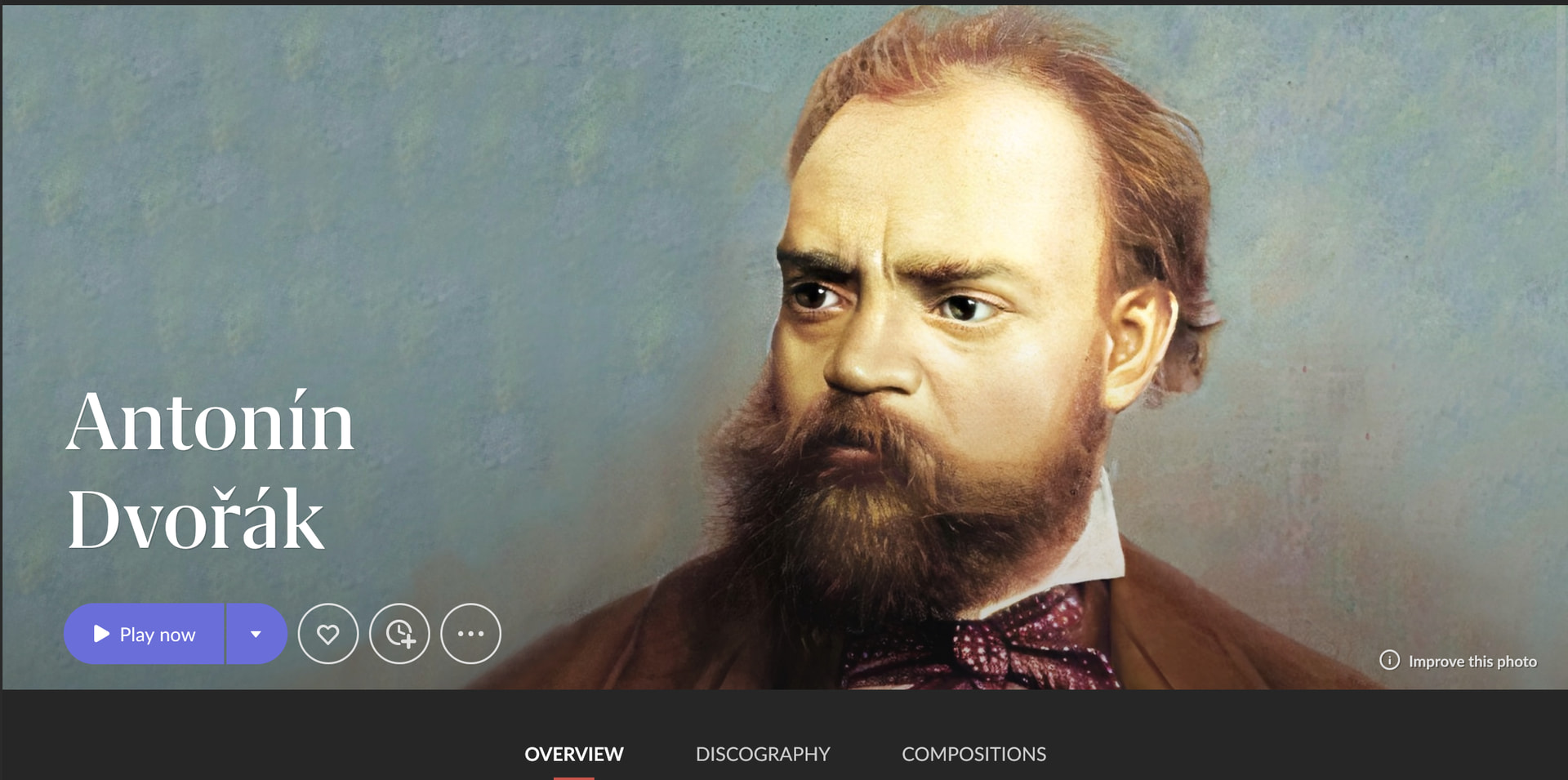

I can’t edit Antonin Dvorak, though, and the editor hangs:

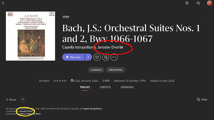

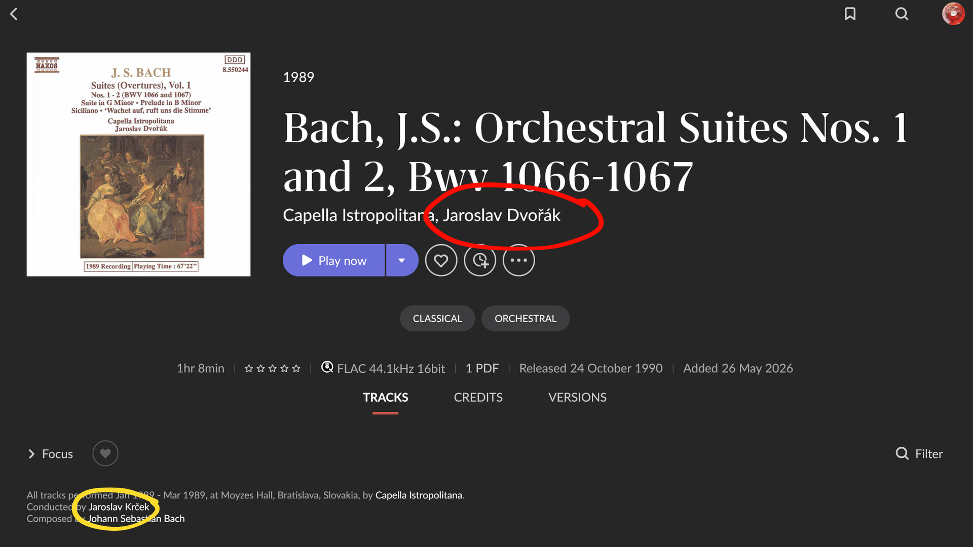

Side note: I don’t know what’s going on with Jaroslav Krcek. (Edit: I do now, see below). There are albums where he is credited as conductor (yellow highlight in the following screenshot) and Jaroslav Dvorak is the Primary Artist link (red highlight in the following screenshot):

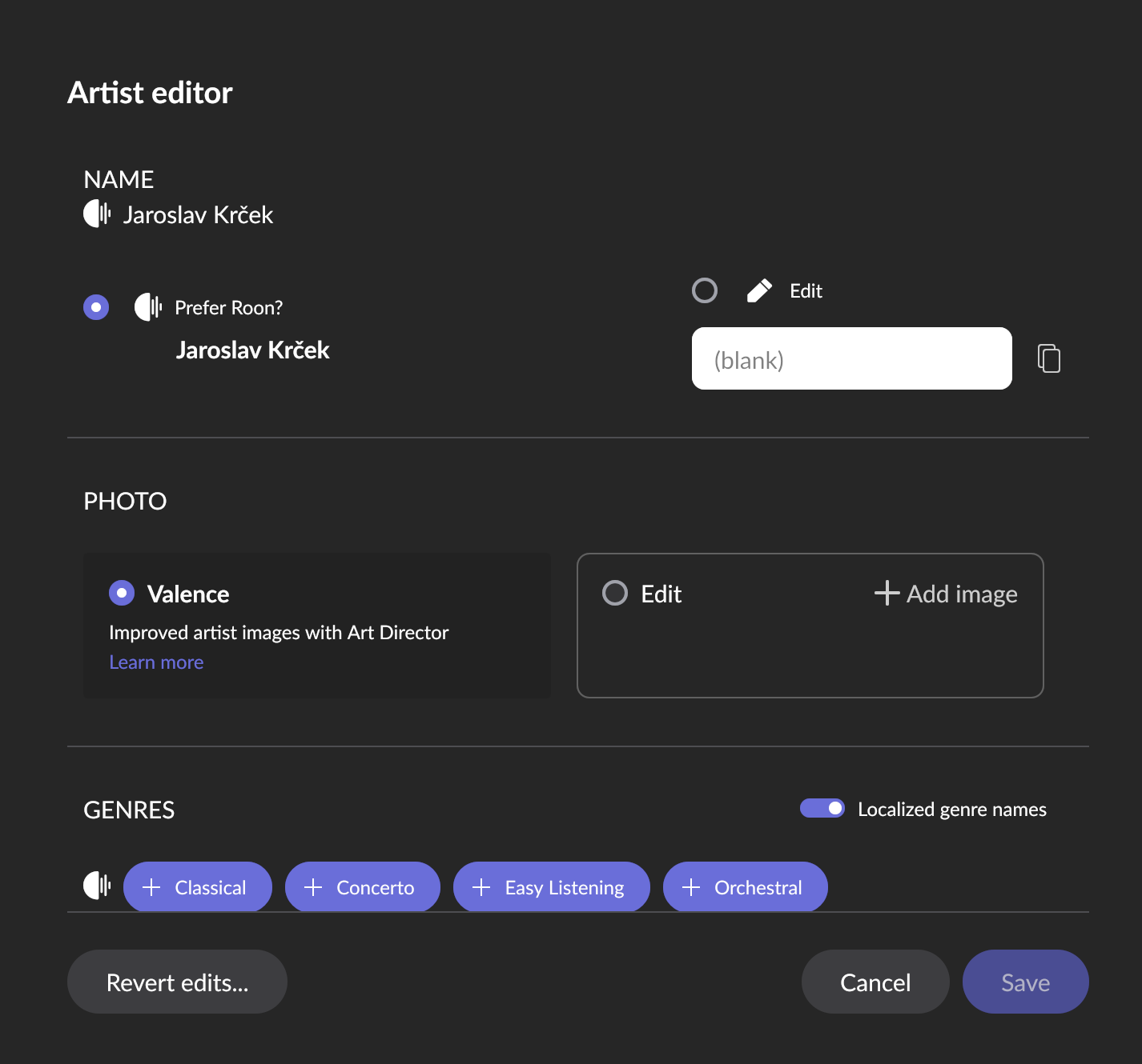

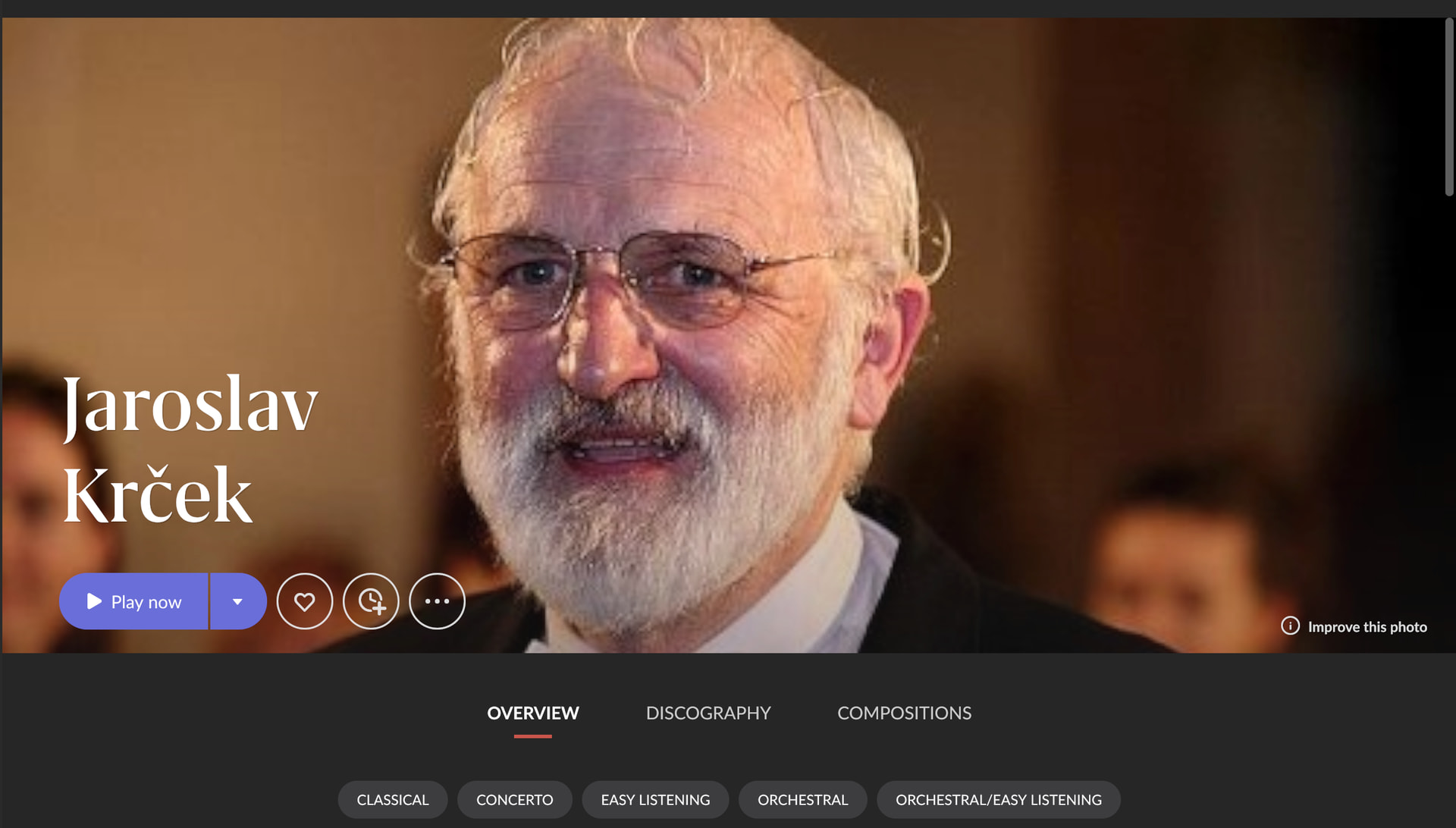

However, BOTH links go to the same artist page, named Jaroslav Krcek in my case. I have definitely not merged them and I have no idea why my artist page is Krcek and @tripleCrotchet’s is Dvorak. In any case, I can edit my version:

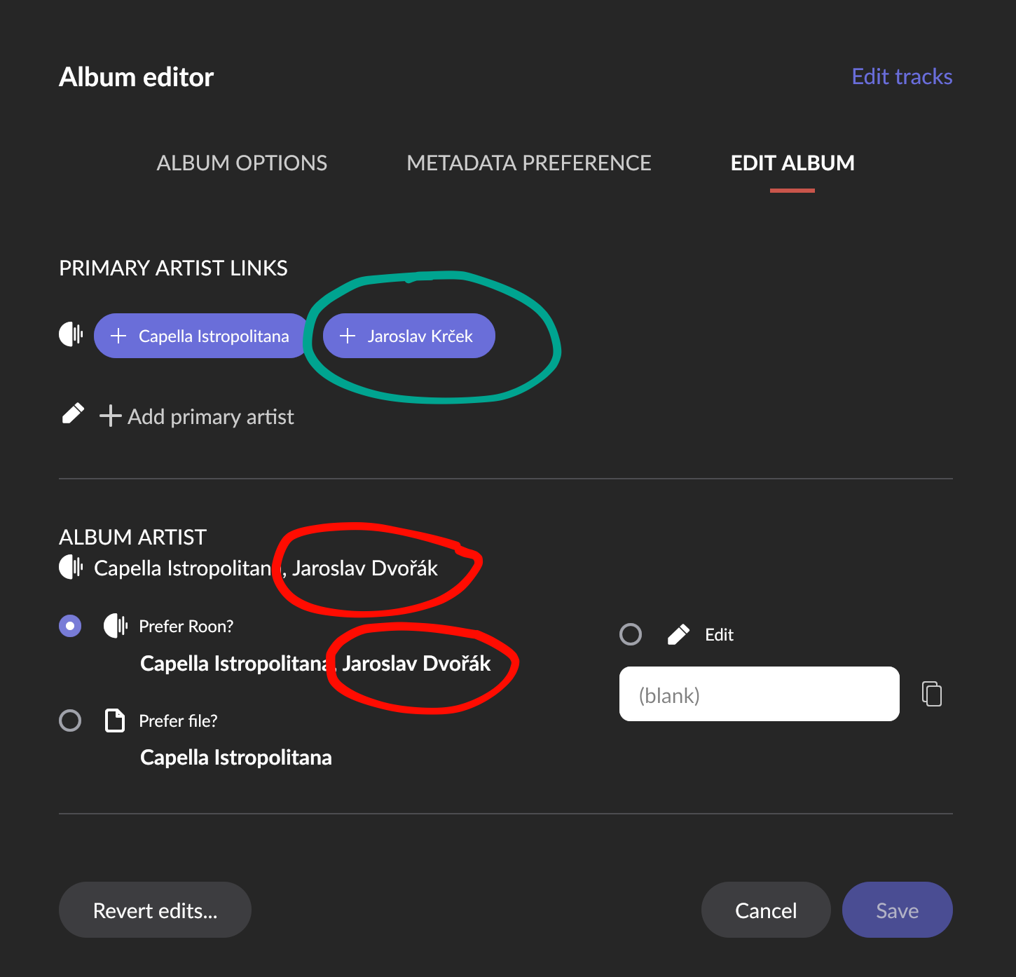

EDIT: I found out why there is the name confusion: this is apparently a Roon metadata error. Checking the albums where the primary artist link is shown as Dvorak, I found that the actual Primary Artist link in the album editor is the correct Jaroslav Krcek, but the Album Artist field is (apparently in error) given as Jaroslav Dvorak:
Hence why it shows Jaroslav Dvorak as the Primary Artist name on the album page, but if you click it, it goes to Jaroslav Krcek
