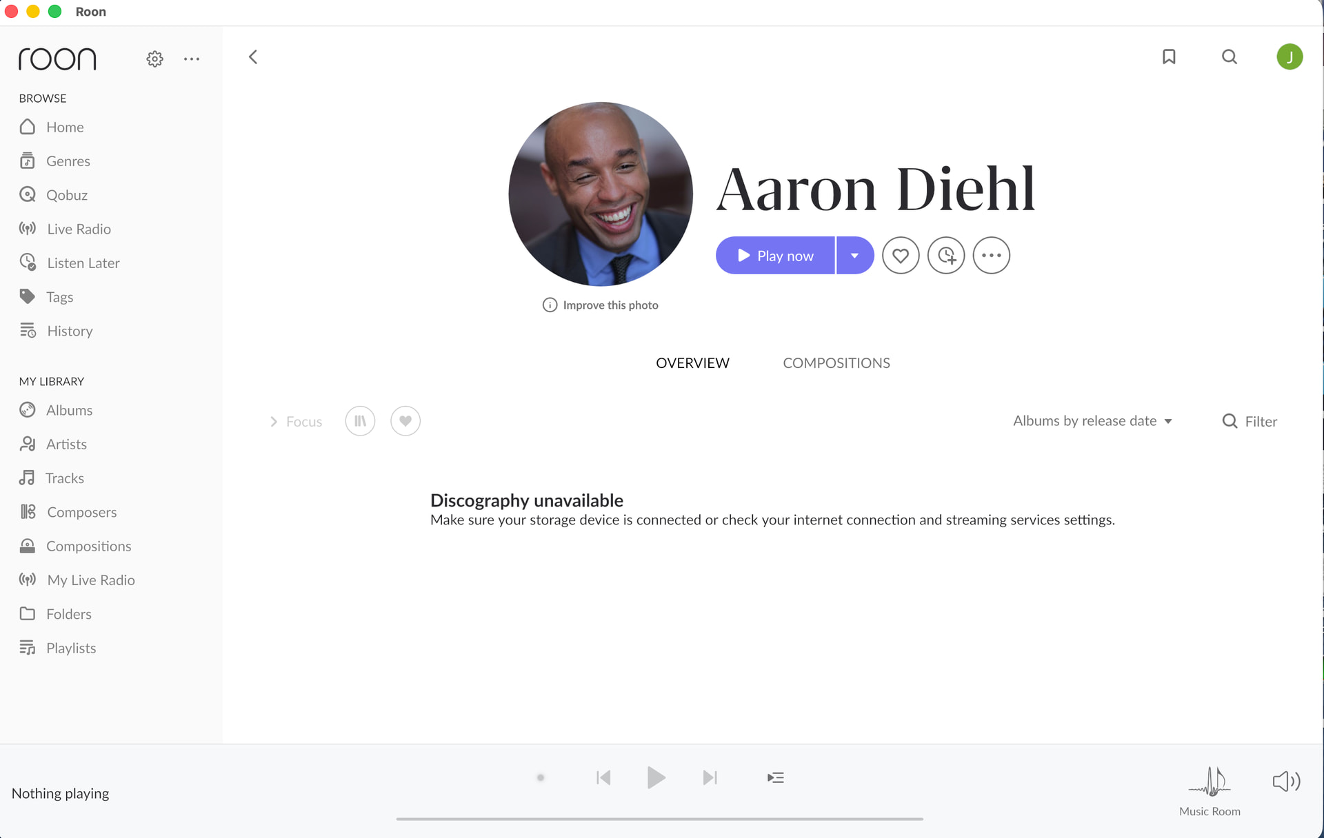

Artist Overview and Search Functionality Issues in Roon (ref#IPLW9G)
· Artist overview and discography unavailable, artist search doesn't work
· Router: TP-link Archer AX6000, switch: Trendnet TRG-S50g, no VPN

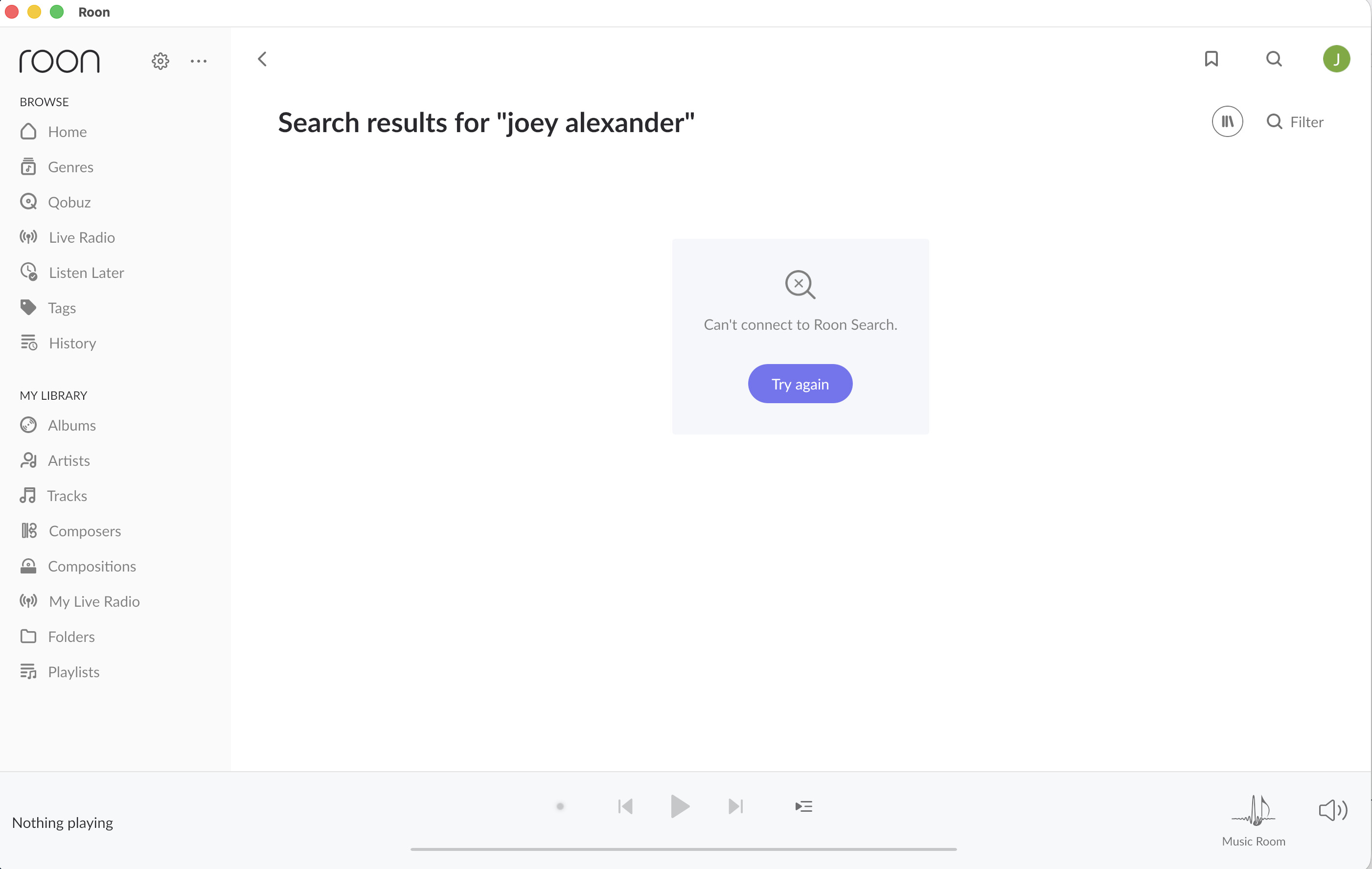

Image above shows non-functioning artist overview. Images below show non-functioning artist discography and can’t connect to Roon search.

The images I sent were from the Roon remote, a MacBook, not the Mac mini. So the artist overview failure looks like it does in the image above with the Roon logo spinning. The discography failure looks like the image above with the message discography unavailable, and the search failure looks like the image above.

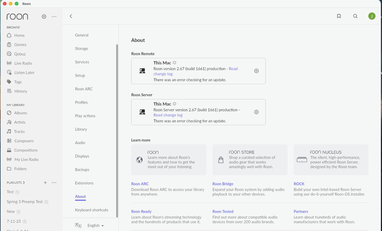

When I browse my local library in album view, the first few rows show the album cover while subsequent rows do not. Clicking on an album that shows the cover or one that does not takes me to that album and it plays.

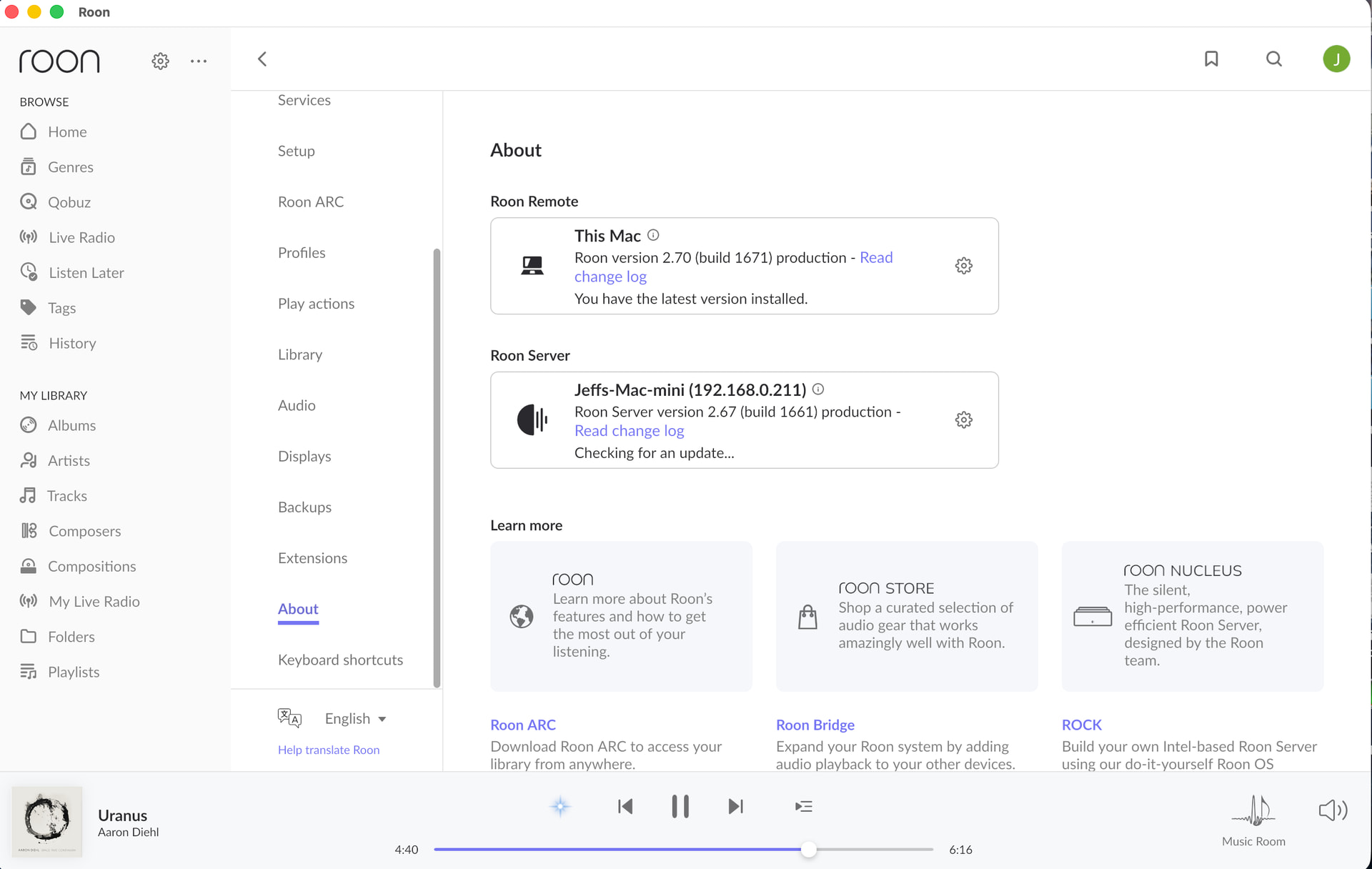

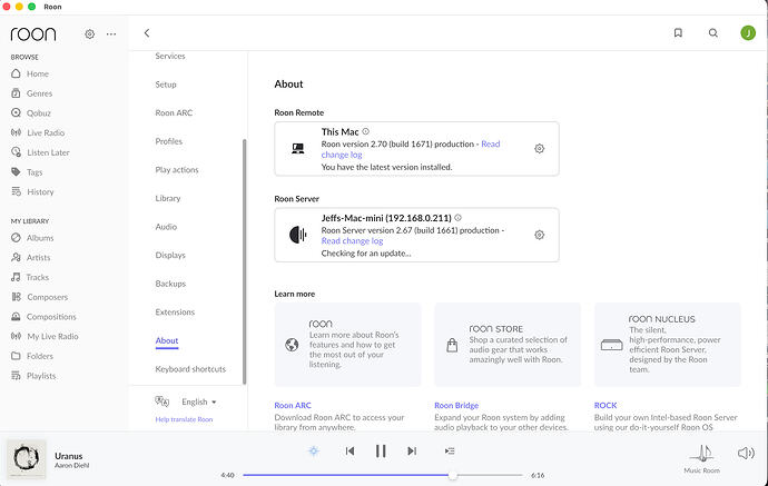

I notice that my MacBook (Roon remote) has latest version, while Roon Server (Mac mini) does not as shown in first image below. Looking at a monitor attached to the Mac mini, that machine is not able to update to the latest version as shown in second image below. Web pages open instantly on the Mac mini except for Roon web pages. I was thinking of going to the Roon download page and re-installing Roon Sever on the Mac mini. Are there any precautions when doing that?

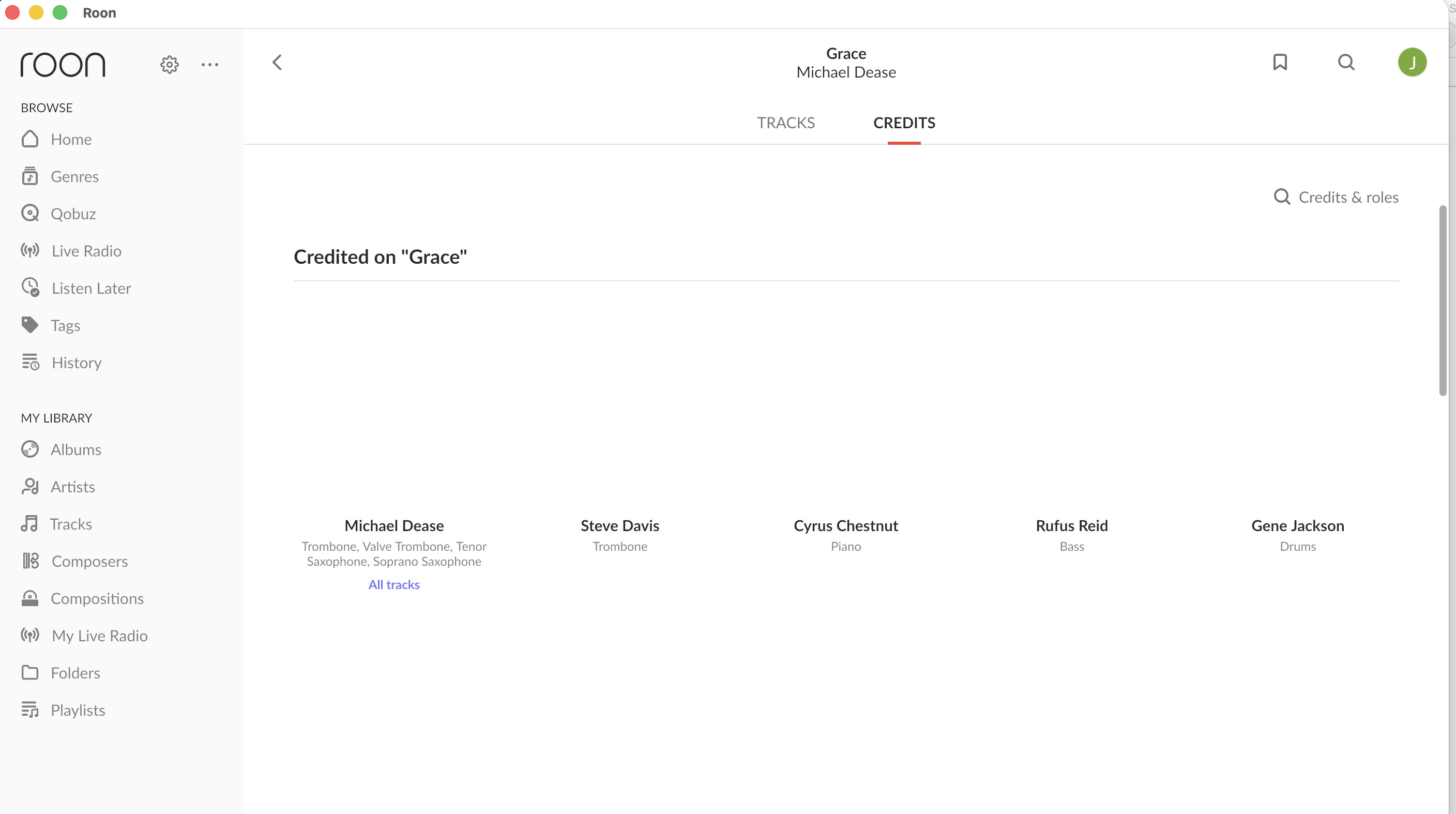

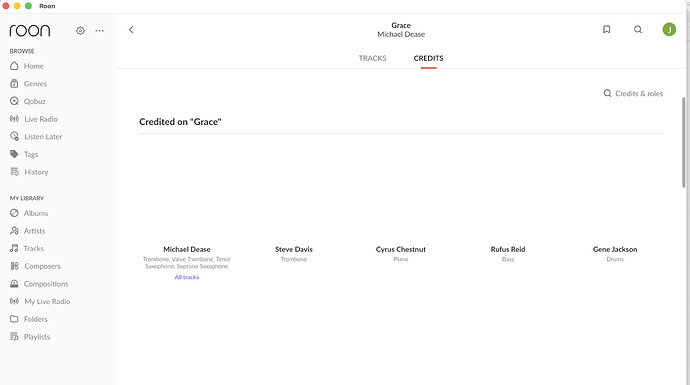

Something else I’ve noticed, on the Room remote the artist listed as credited on an album have blank pictures when initially looking at the page. After a minute or two it fills in.

From your account admin, it looks like your Roon Server instance hans’t reached out servers in about two weeks now.
With this, can you please use the directions found here and send over a set of Roon Server logs to our File Uploader? Once logs have been uploaded, please let us know so that we can check the server for your files, thanks!

One quick note: your server is actually already on the current production version (2.67), so no need to worry about reinstalling, the update prompt you saw was just a side effect of the connection problem, and it'll sort itself out once connectivity is restored.

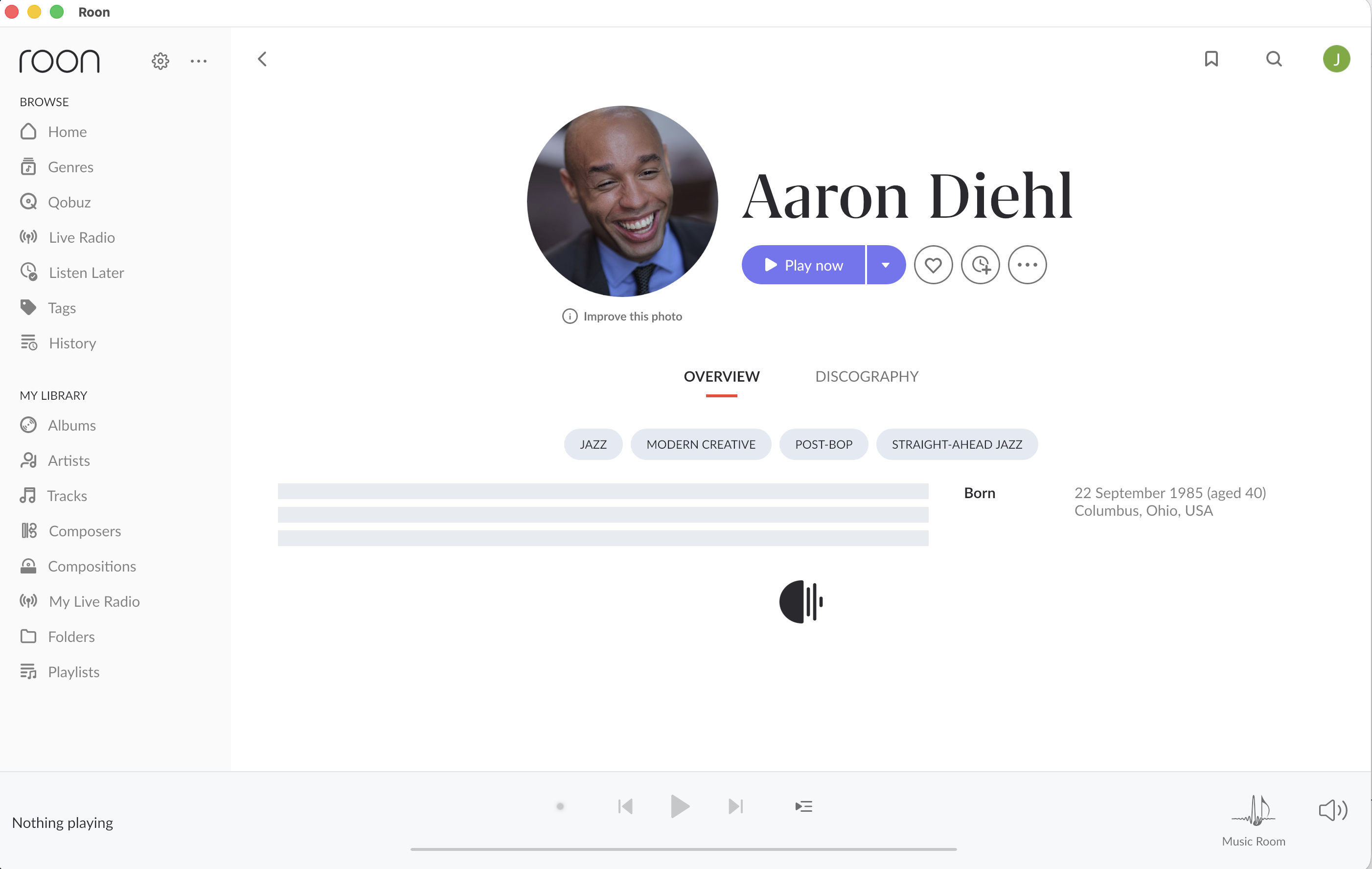

In the router I disabled intrusion prevention and restarted Roon server. When I started Roon on my Roon remote the update available window opened so I suspected problem solved. The mini now has version 2.70 and I tested artist overview, search etc. and they work.

That’s exactly the result we were hoping for, nice work confirming .211 is the mini, and glad to see it jump to 2.70 with artist overview and search all working again. That pins the cause squarely on the router’s intrusion prevention misreading Roon Server’s normal cloud traffic.
