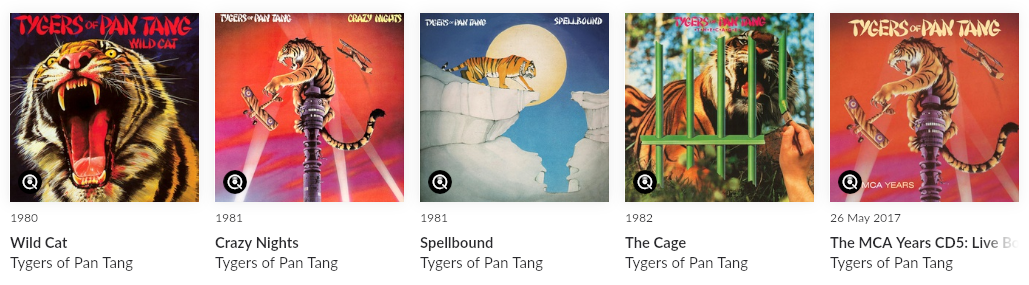

It’s not easy but I’ve been able to take an example (the box set on streaming is Tygers of Pan Tang - The MCA Years), because Wild Cat (disc 1) as a separate album (which is what I want) is not on Qobuz.
If you edit The MCA Years → fix track grouping → remove the other 4 discs and save it as a 1 disc album → re-identify it as Wild Cat, you can separate Wild Cat out and assign it the proper art and track metadata/links. Then you can open The MCA Years again and isolate the second disc, and so on.
You do kind of have to keep everything in the streaming box set in your library though (remove any one of the separate entries and your streaming favourite is removed and it will all go away). So I have separated out the 5 albums (as I would do if I owned the CD box set) and they are 5 albums with correct metadata and art in Roon, from a single Qobuz album (and the algo doesn’t recommend me Crazy Nights or Spellbound for example, even though they exist separately on Qobuz, as they are correctly identified and so it knows I have them.)
