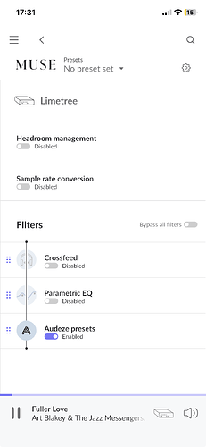

I can’t find the Audeze Presets menu, only the option to enable it. Anyone know where to find it in the options? I know I saw it once ages ago but didn’t have headphones at the time but now I have some LCD-2 Classic for my Naim NAIT 50.
I’ve just read the Knowledge Base article about Audeze Presets but when I enable it the headphones list does not appear like the article shows.
You need to use a tablet or PC to access the detail settings of DSP plugins. Create Presets if you need to switch DSP configurations on the go (with a phone).
Thanks for this. I had a hunch that might be the case so checked in my iPad and it shows the full menus. Shall have a play now…
