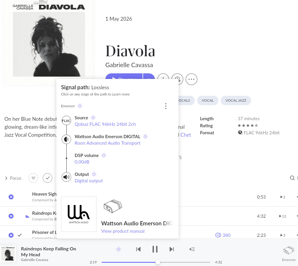

In the interest of improving this integration, I would also like to point out that Roon’s Signal Path always displays ‘DSP Volume: 0.00dB’, whether the volume is set to Fixed or Device Volume, as shown in the attached image.
I truly hope Wattson Audio is following this thread and will work to resolve these issues; they are currently penalizing a device using Roon, that is otherwise a sonic masterpiece.
