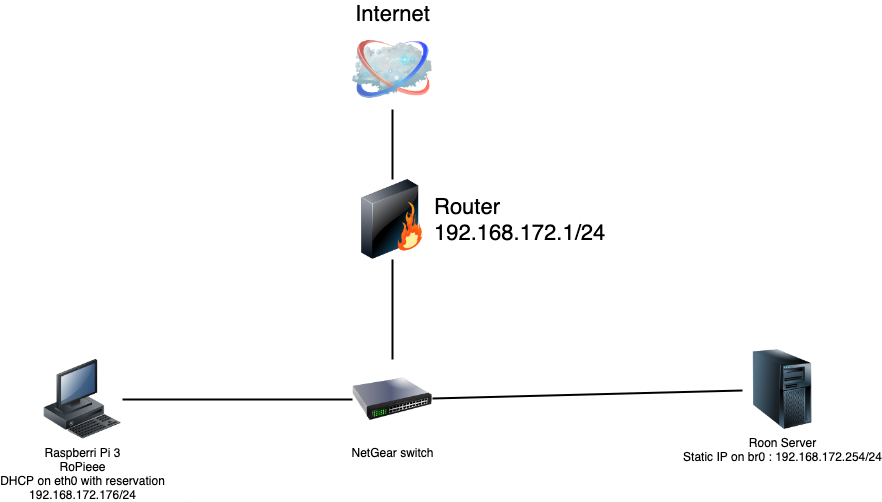

Regarding the wrong IP: what is happening is that from any Roon Control i SEE the Roon Bridge AS having the IP of Roon Core, but in the meanwhile (from a network perspective) I can reach their real IP.
This is not a case where for some funny reason the box hosting Roon Bridge takes the same IP as Roon Core, since also during the problem I can ping the clients, SSH on them, and reach their web interface amd all. The problem is on Roon Core that is Showing the Clients with Roon Core IP, and is not able to command them anymore, not playing music, etc.
As for the infrastructure is as simple as it can be, I’ve tried to boil all down to 2 boxes connected via wired cable to the same LAN switch, as you can see from the attached image
Hope this helps

Hello @Matthew_Dew,
Roon uses the OS level network interfaces for discovery. If Roon is reporting that it can discover a device via the local machine’s IP address, that means that the device is responding to the Roon multicast discovery packets from the core IP address. Based on your logs, it appears that you may be running Roon in a container on a Linux machine. I recommend temporarily running your Roon Core instance on a Mac or PC with a native install of Roon to see if there is something in your configuration that is causing this behavior.
-John
