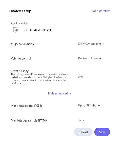

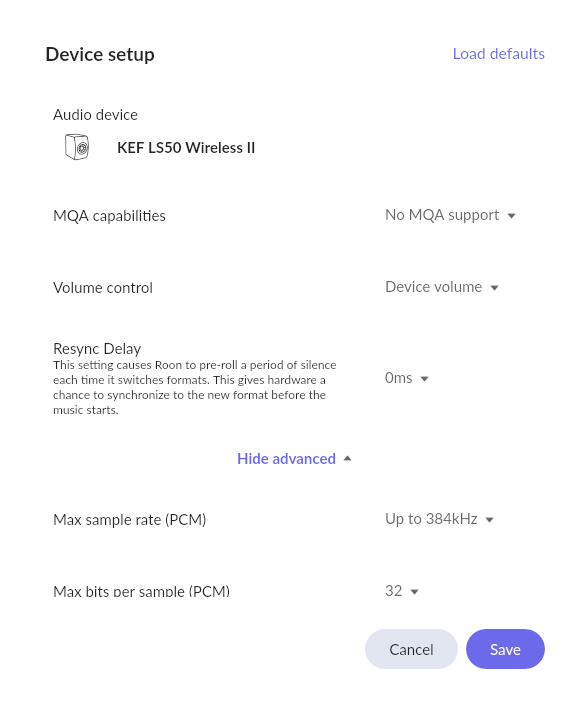

Set KEF device in Roon to “No MQA support”

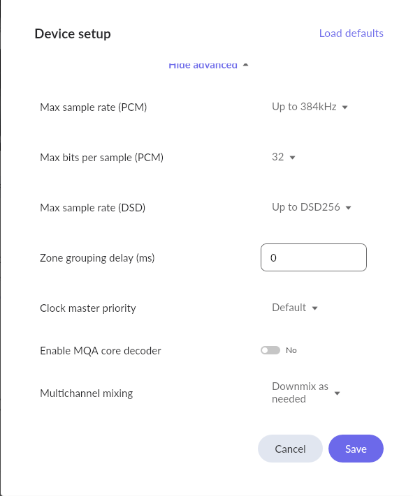

Disabled MQA core decoder

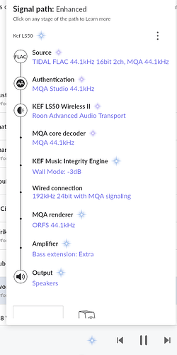

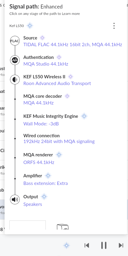

Even after disabling MQA support in Device Setup, the live Signal Path intermittently continued to display:
MQA core decoder
MQA renderer
MQA signaling
The Signal Path UI appeared to mutate dynamically while expanded, which seemed abnormal.

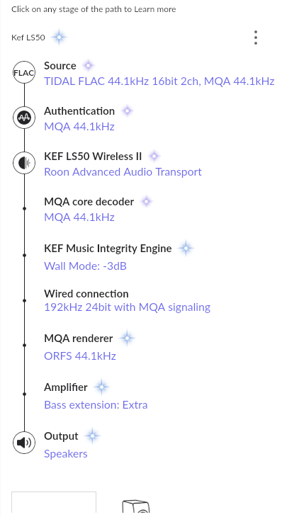

· unifi dms. all cat 6 wired

N.B. MQA disabled. All diagnostics (reboot/relogin) performed and still shows this path
another example now playing swords - leftfield, rhythm and stealth - same path, same problem
Mac mini is connected to UDM SE via USW pro max (2.5gbe wired)
Hi @fruity-crux-6p,
Thank you for providing the screenshot of your Signal Path! This details exactly what is happening under the hood, and it gives us a very solid lead.
Looking at the Signal Path, we can see a clear conflict in how the MQA stream and the speaker’s internal DSP are interacting over RAAT.
Even though you have MQA disabled in the device settings, Roon is still running the MQA Core Decoder, followed immediately by the KEF Wall Mode DSP (kef_wall_mode).
In a standard deployment, applying any DSP or volume adjustment modifies the audio data, which should break the MQA chain.
However, Roon is still sending this stream over the network with an active MQA flag (IsMqa=True), causing the KEF speakers to activate their MQA Renderer on a modified PCM stream.
This desynchronization is almost certainly what is causing the “gargling”, phase shifts, and audio artifacts you are hearing.

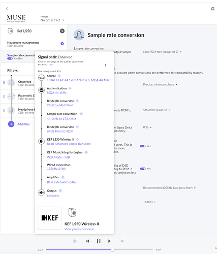

To help us definitively isolate this bug, could you perform a quick 10-second test for us? We want to completely strip the MQA signaling from the stream before it reaches the KEFs.
Here is what to do:
  1. Open the Signal Path for your KEF zone in Roon.
  2. Click on MUSE (or DSP settings).
  3. Enable Sample Rate Conversion.
  4. Set the Configuration to Custom and force the output to a fixed rate, for example, 192kHz (or choose Max PCM Rate - Power of 2).
  5. Play one of the affected tracks (like Sky at Night or Swords).
What this test does: By forcing a fixed PCM upsampling in MUSE, Roon will completely overwrite and strip out any residual MQA signaling flags.
The KEFs will receive a pure, heavy PCM stream and won’t attempt to engage the MQA Renderer.
Please let us know: Does the audio distortion completely disappear when this setting is active?
Your feedback on this will allow our engineering team to pinpoint exactly whether the issue lies in the RAAT flag handling or the KEF firmware’s renderer negotiation.
Looking forward to your results!

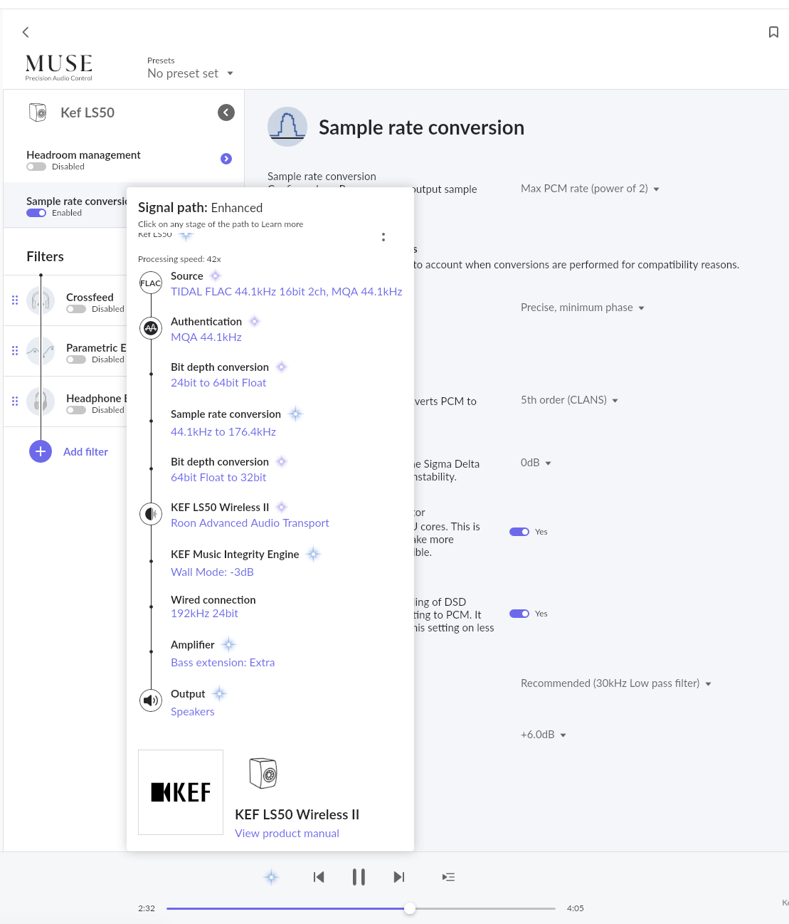

Hi Alex, yes. Audio distortion disappears with sample rate conversion of Max PCM rate (power of 2)
Lee
Hi @fruity-crux-6p,
Thank you for confirming — this is exactly the result we were hoping for!
The workaround is solid: enabling Sample Rate Conversion (Max PCM rate - Power of 2) in MUSE strips the MQA signaling from the stream entirely, so the KEF receives a clean PCM signal and the distortion disappears completely.
You can save this as a preset in MUSE so it applies automatically to your KEF zone every time — no need to think about it again.
Your workaround settings:
  • MUSE → Sample Rate Conversion: Enabled
  • Configuration: Max PCM Rate (Power of 2)
Thank you for the incredibly thorough troubleshooting you did upfront — it made isolating this so much easier. Enjoy the music! :musical_note:
