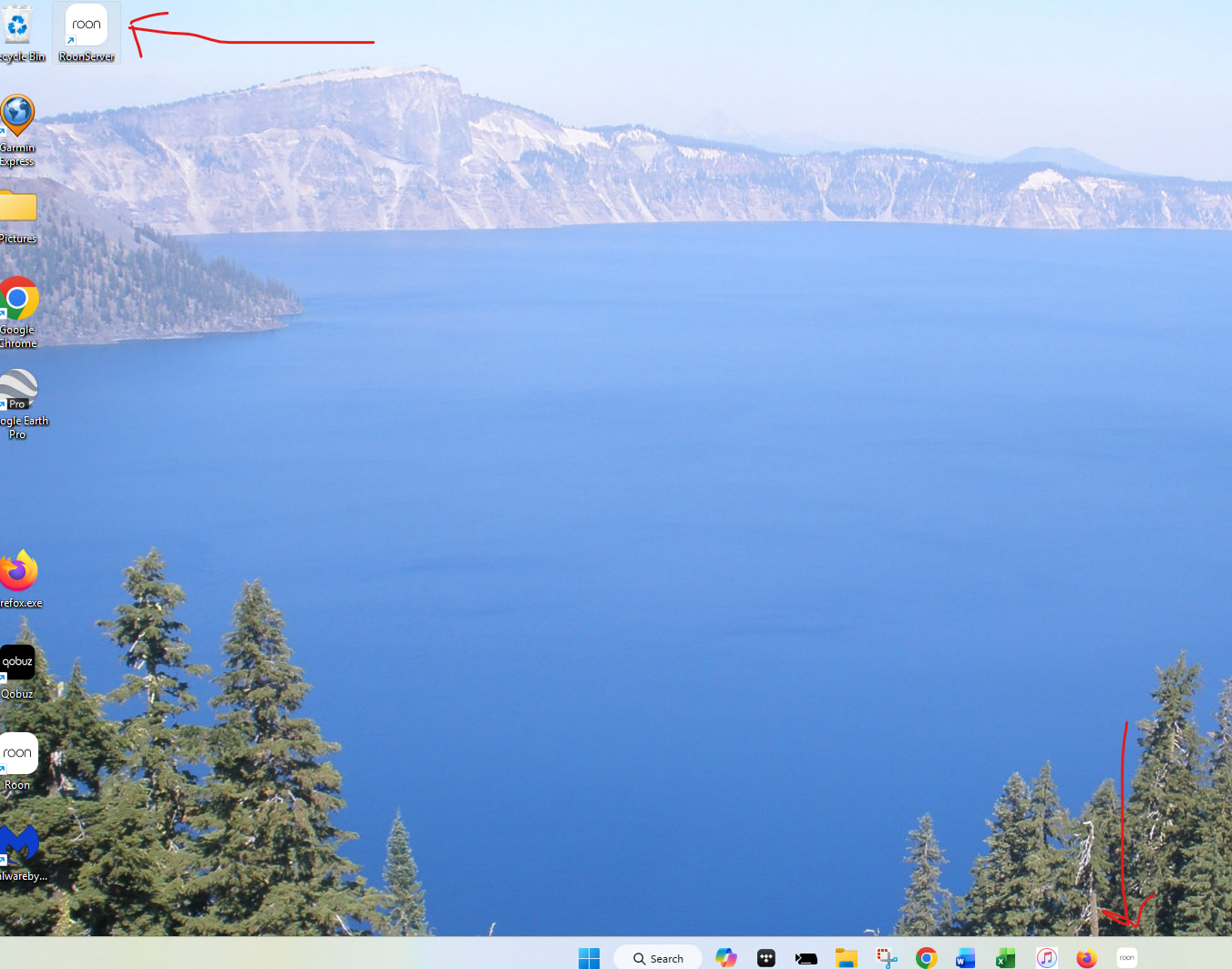

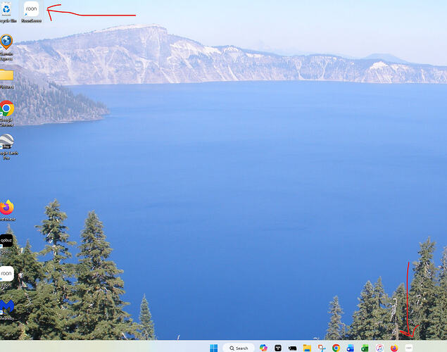

I just looked at the desktop of my PC and do see an icon labeled Roon Server in the upper left. When I click on it nothing opens or happens. When I use Roon on my PC I use is the control app -see icon shown on the lower right of my desktop screen shot. Maybe I unnecessarily downloaded the Roon Server software to my PC when I didn’t need to???

Thanks so much for the additional information and for the screenshot! Let’s first run through the following:
  • Confirm which server the PC control app is connected to. In the Roon app on the PC, go to Settings → General and note the name and machine of the currently connected server. It should be the Small Green Computer i7, not the PC itself.
  • Stop and disable the redundant Roon Server on the PC (steps below). This is the single most important fix. With only the i7 serving, the PC app has no competing local server to drift onto.

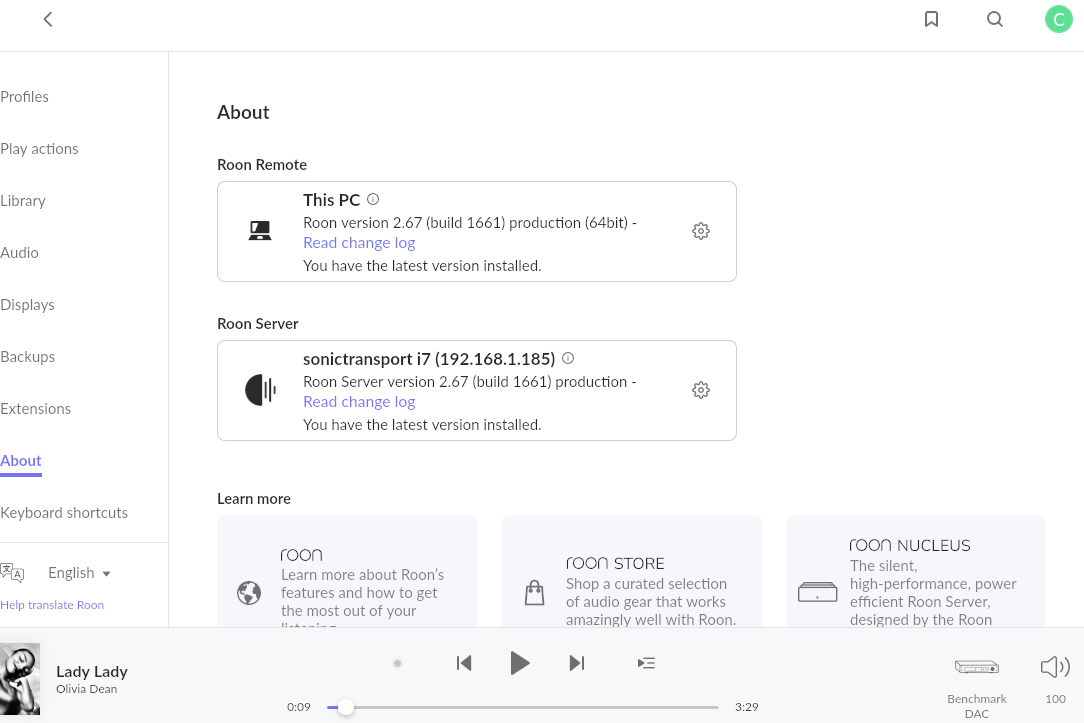

Also, I was poking around and went into Settings/About and saw this screen. Does this look correct?

Thanks for the screenshots and for closing Roon Server on the PC, that About screen is really helpful. Good news: it tells us a lot.
On your PC’s About page, under Roon Server you see your sonictransport i7 (192.168.1.185), and under Roon Remote you see “This PC.” That’s exactly the correct setup, your i7 is the server, and your PC and Mac are both remotes pointing at it. So you didn’t break anything, and the i7 is doing its job.
