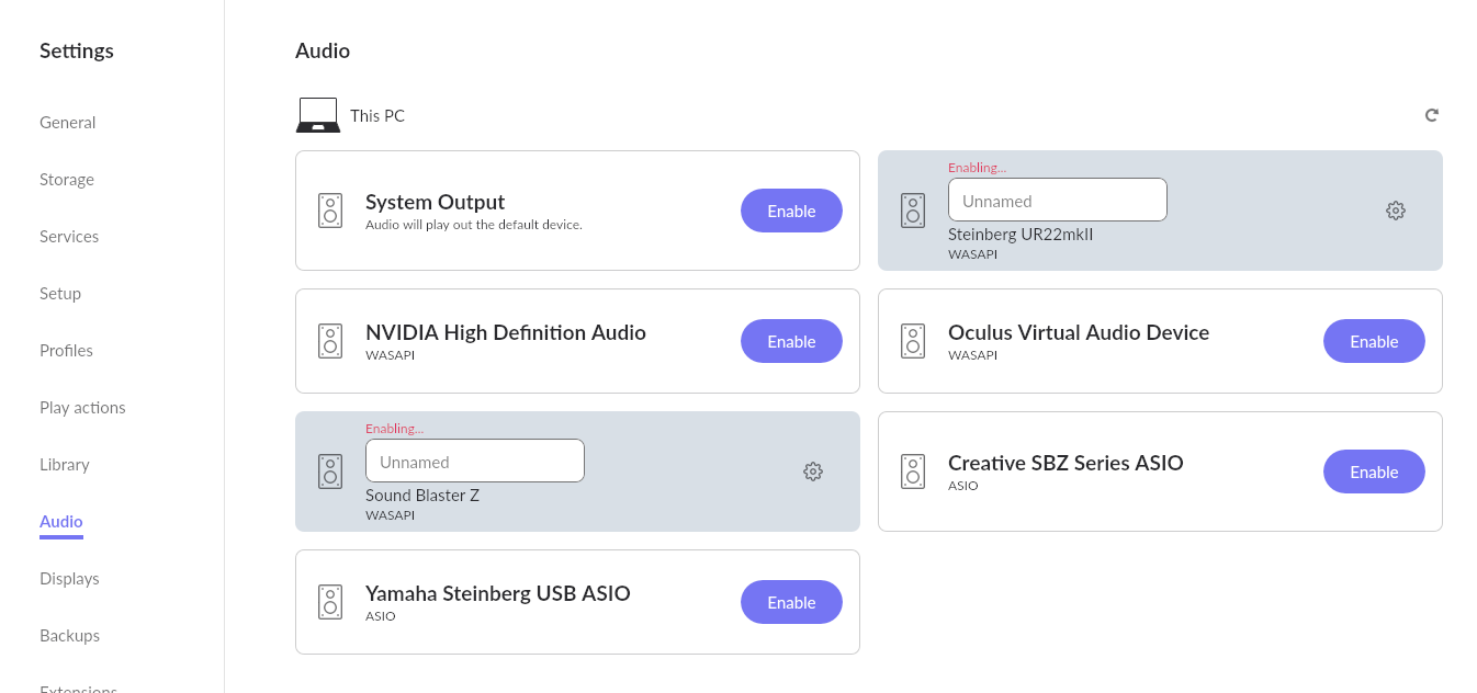

Would you also mind providing us with a screenshot of the Roon Settings → Audio page so that we can get a better look at your devices? I’m hoping that you’re able to provide a screenshot when the “red enabling” feature appears.

I’ve did what you asked and it’s still the same. I attached a screenshot, the devices with red test are the ones that I use, and after a few seconds every device disappears from “This PC”. Please help me out a bit quicker since I can’t use it on my main pc.
