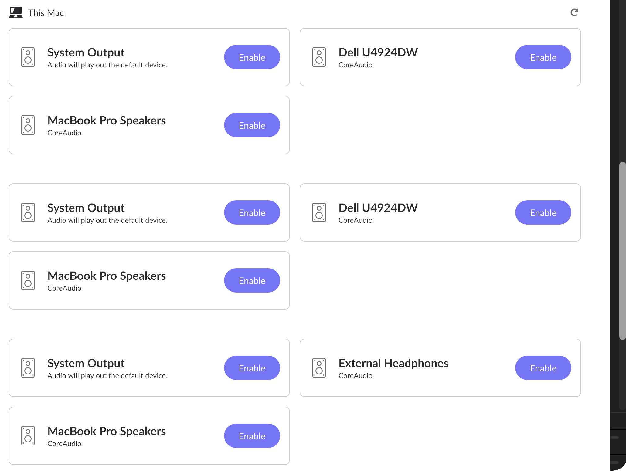

Hi Benjamin , this was tried when a chap on the forum recommended a clear and reinstall
Library/roon & /Library/Raatserver and the binary were removed from both macs (trash emptied )
And the client downloaded and reinstalled manually ( was brew installed before)
The screen shot was from after that procedure was completed

trying to rule out my server , built a new server based on your ROCK image.
performed the uninstall , delete RAATServer & Roon directories from Library reinstall dance
on corp machine started up the app , logged into the new server went to the setting audio panel
on home machine started up the app and left it (not even clicking on the get started button)
corp machine displays the additional audio devices from the home Mac
RAATServer_logs show the same machine_id !
So the behavior is the same with my server or rock. It behaves the same.
what’s next?

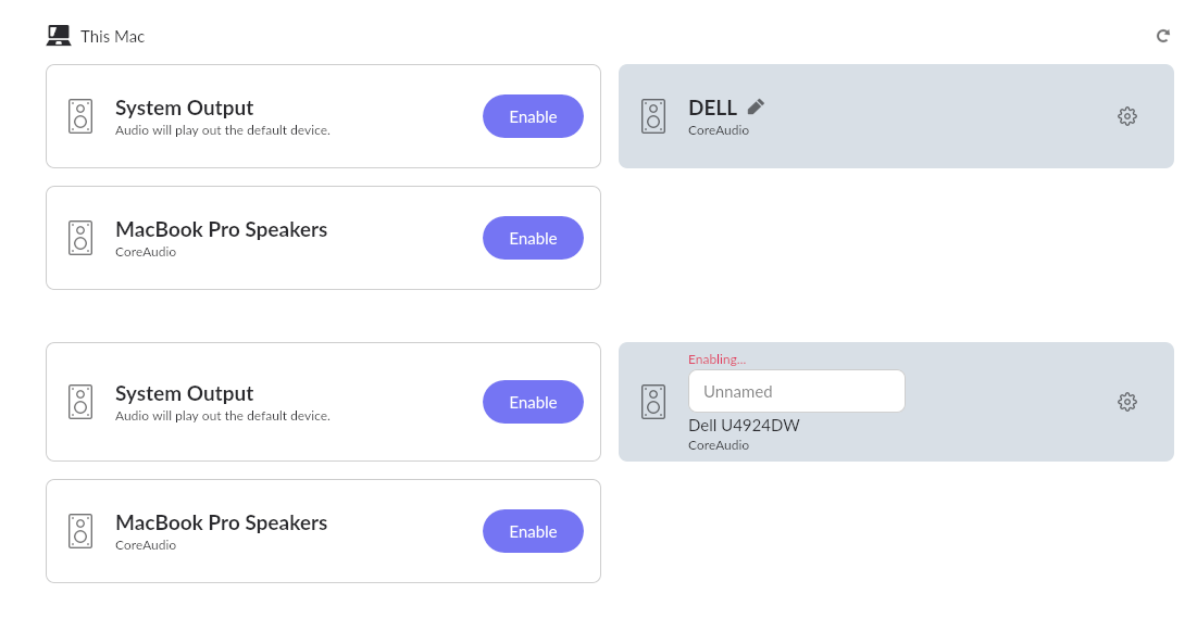

no ,The corporate Mac went to sleep and when it woke up it had both again. Although the machine ID hasn’t changed
Restarted the client and the machine ID has remained different.
