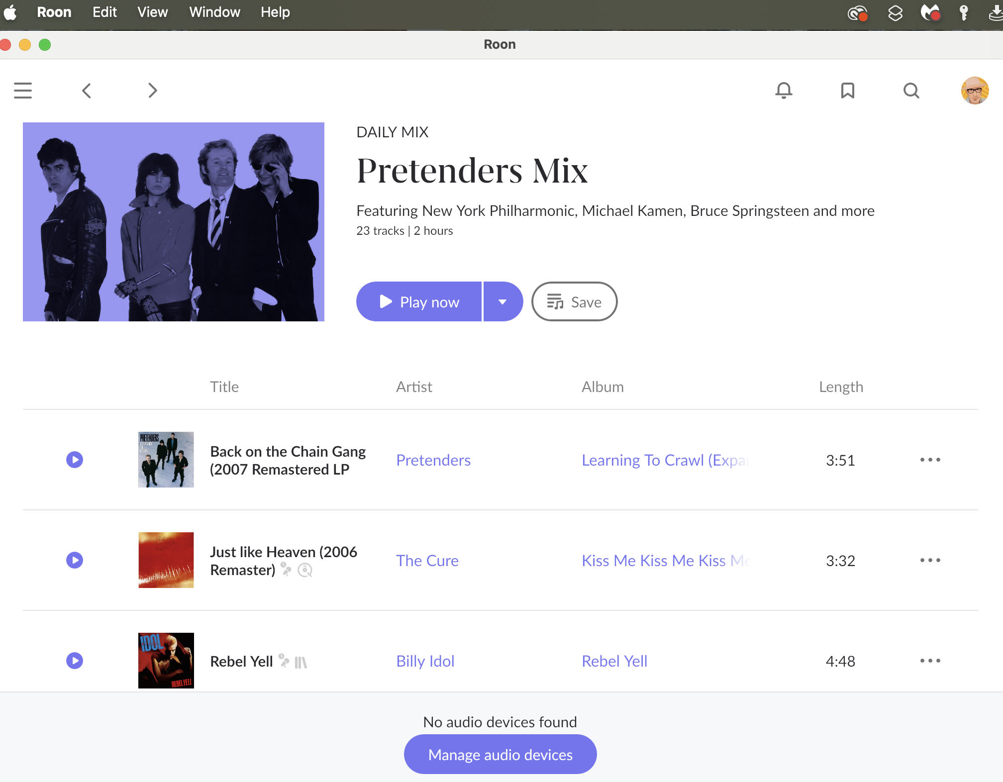

For the last several months, every time I update Roon and try to play music, Roon indicates that there are "No Audio Devices Found.” I then have to reinstall the Roon from a backup. Why does this continue to happen, and how can I permanently correct this annoying issue?

I checked, and both the Roon Server and Roon are in the Local Network, which was enabled on my iMac. I then toggled them both on/off, but the issue persists. Again, this has been happening with every update for months. To correct the issue and have Roon show my devices, historically, I have had to restore them from a backup, which I am not even sure provided the update. Please advise. Thanks!

Yes, I toggles and then quit, and reopened the Roon Server. I finally got Roon to discover my devices after restarting my Mac.
