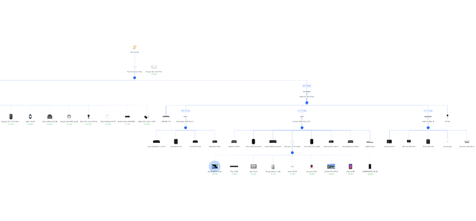

I have four managed switches in my network. Here’s a photo of my network topography.
I am not sure I understand your third question. I enabled multicast forwarding and now my devices were seen and able to be configured. It's odd you can't connect to my server. I enabled ARC and received a confirmation. I am guessing something is blocked by my network. Is there something I need to enable to allow you to check remotely?
