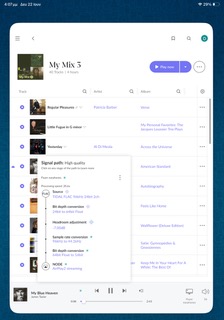

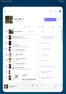

3. Share your Signal Path While music is playing and you are experiencing the issue, could you please click on the glowing light in the left side of the Roon app music control buttons and take a screenshot of your Signal Path? Please upload that screenshot here so we can see exactly how Roon is processing the audio.
4. Provide a Timestamp If the steps above do not resolve the issue, please note the exact local time and date (e.g., June 22 at 2:15 PM) when you next hear the hiss or clicking, and the name of the track you were playing. We can then activate diagnostics for your account and check the server logs for that exact moment.

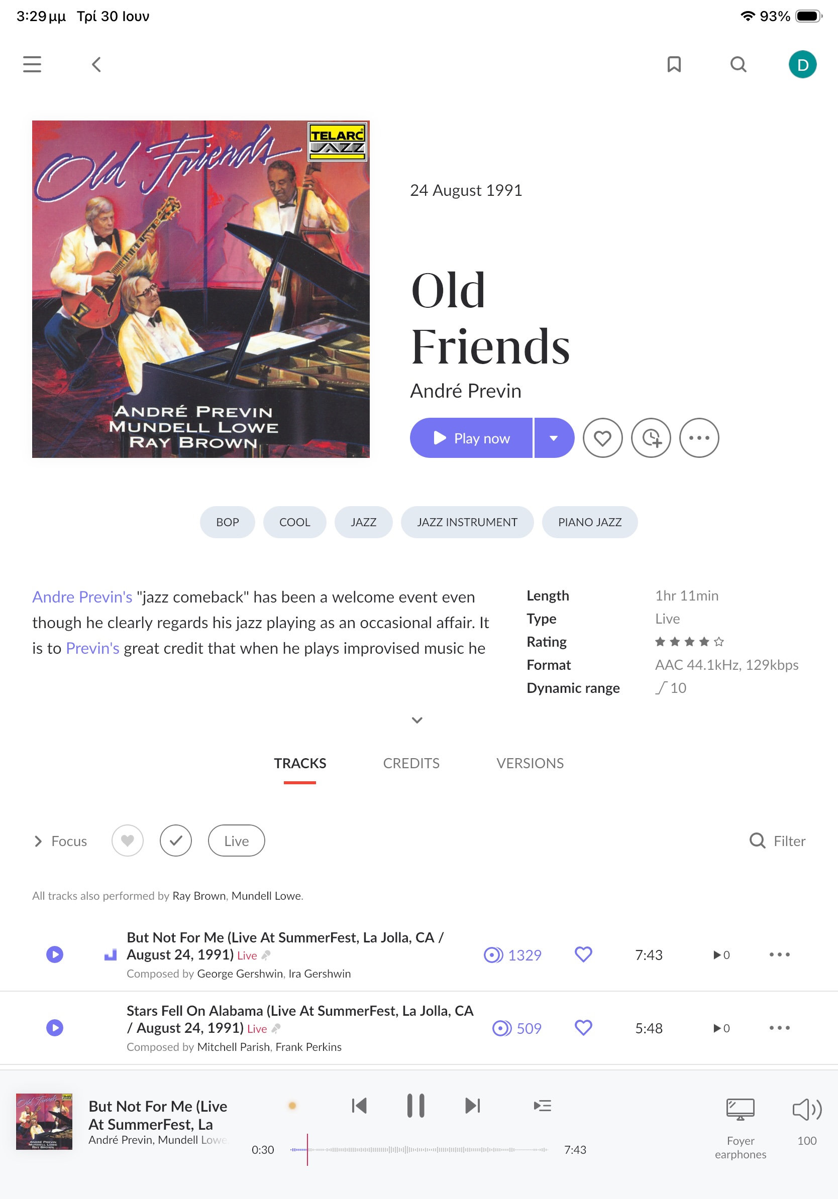

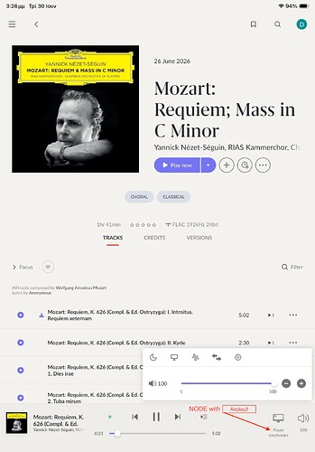

HELLO
The problems occur with music from:
1\. TIDAL  30/06/26 3:26.    NODE connected via Roon as Airplay 2
2. My network Library 30/06/26 3:29. NODE connected via Roon as Airplay 2
3. From live radio 30/06/26 3:35 ex. France Musique via Roon as Airplay 2

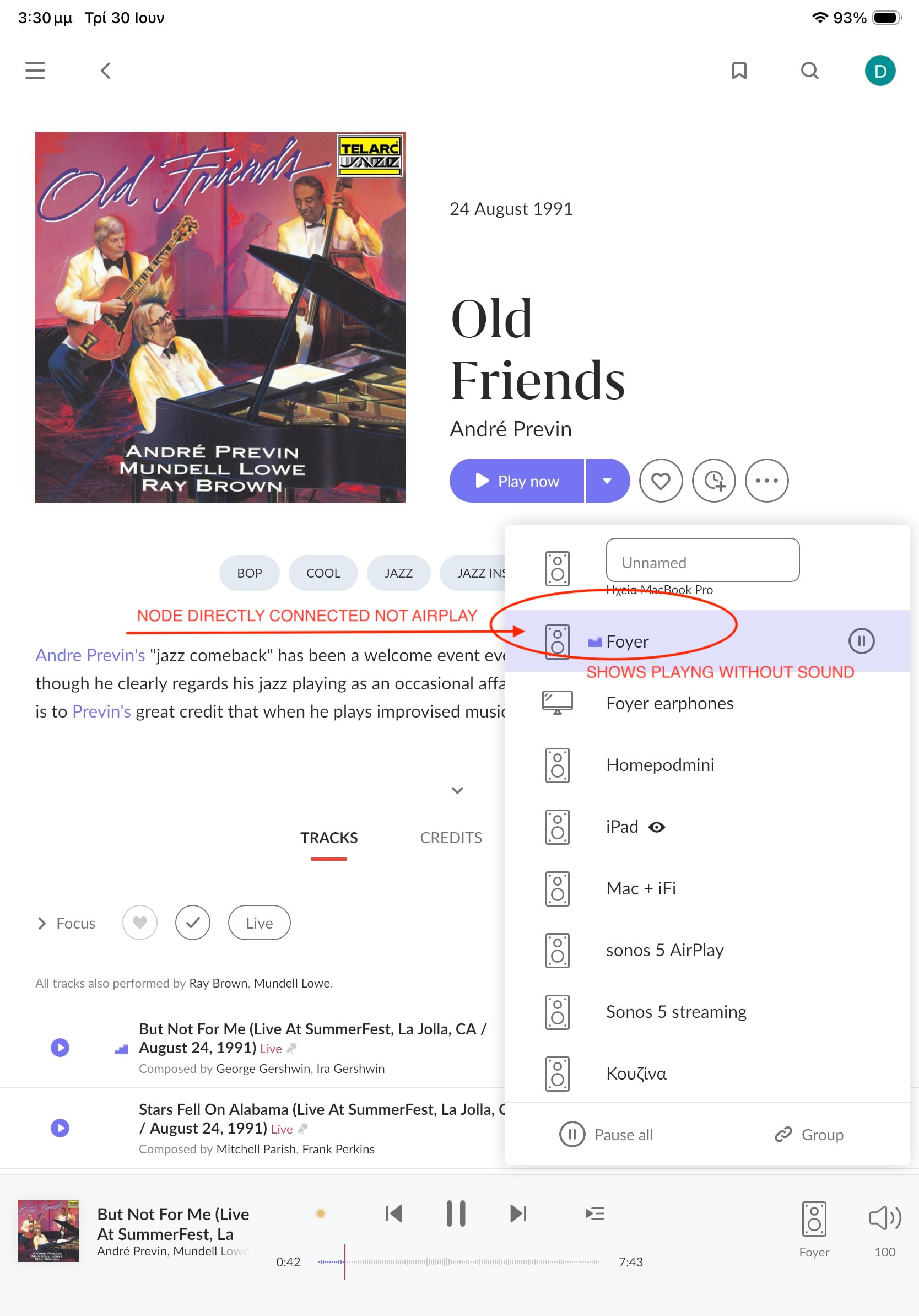

Initialy ROON started recognizing and playing NODE directly through the network (WIFI) with no problems.
For a while now recognizes the NODE directly, it seems to be connected (foto) but the sound comes as sporadic sort noise signals with big interruptions.
Τo address the problem I activated the AirPlay 2 connection with the known quality problems.

When you play to the NODE as a native Roon Ready endpoint (the “direct” zone, shown in your logs as “Foyer”), Roon and the NODE have to agree on a shared clock so audio stays sample-accurate. In your logs, that clock handshake is failing badly. Every sync between Roon Server and the NODE shows the NODE’s reported clock drifting by roughly a million parts per million, where a healthy endpoint drifts by only a handful. A few seconds into your local-file test at 15:30 on June 30, this built up until the NODE reported a dropout and Roon stopped and tore the stream down. That tear-down loop is what you hear as stops and noise on the direct connection. Importantly, we see the exact same broken clock pattern on every direct-playback attempt in the logs, including ones from June 27, so this is consistent rather than a one-off.
When you play via AirPlay 2 (the “Foyer earphones” zone), the clock problem goes away because AirPlay handles its own timing, which is why AirPlay plays. But we do see the NODE repeatedly renegotiating its AirPlay session during the day, which lines up with the occasional clicks you get on that path.
So the common factor is not Roon’s playback engine, which has not changed, but the timing handshake between Roon and this particular NODE, at the clock level. The most likely thing that changed around the time you noticed this is a BluOS firmware update on the NODE, since that is the part producing the clock values Roon is rejecting.

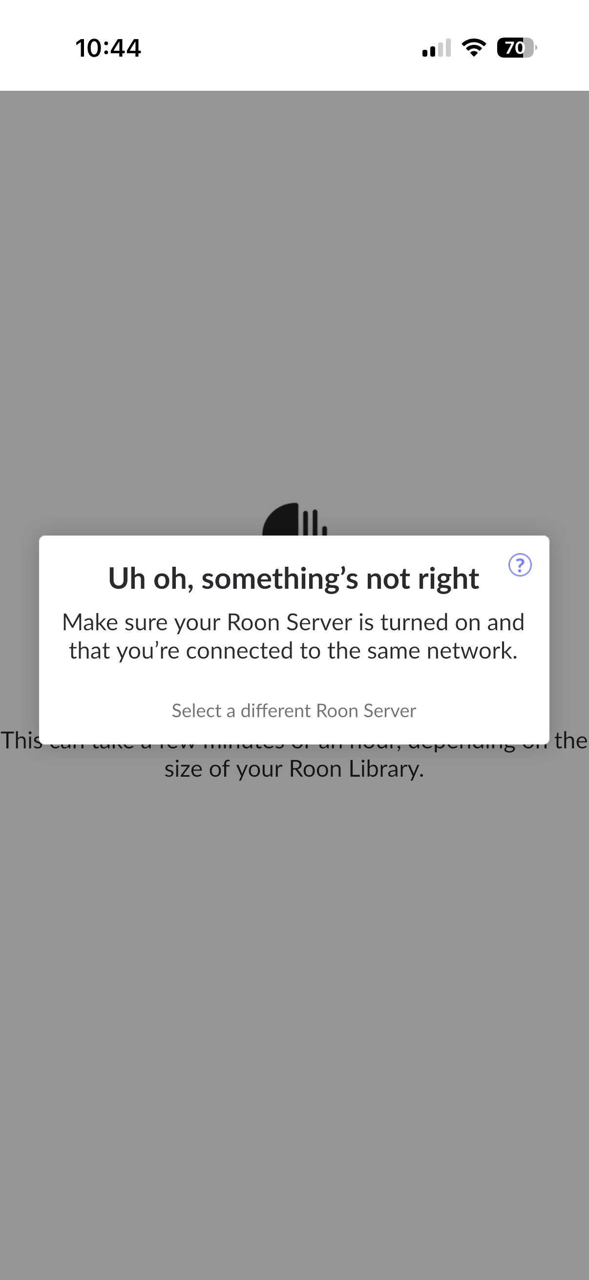

2\. Many times my iphone and iPad  don't find the Roon Server, although my M1 MacBook Pro (where Roon Server is runing remains continuously open connected with power.

2\. Many times my iPhone and iPad  don't find the Roon Server, although my M1 MacBook Pro remains continuously open (where Roon Server Is running), connected with power and no network problems occur.

2. iPhone and iPad not finding the Roon Server
This is related to macOS Local Network permissions. Please go to System Settings → Privacy & Security → Local Network and make sure Roon is listed and enabled. If it is already enabled, try toggling it off and back on, then restart Roon on the Mac. This should allow your iOS devices to discover the server reliably.
