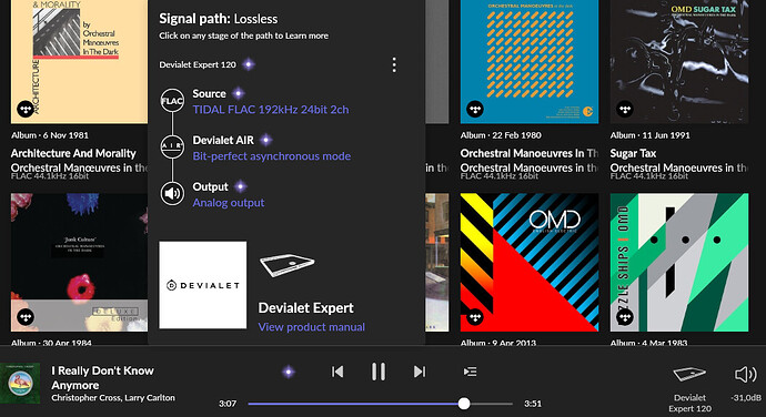

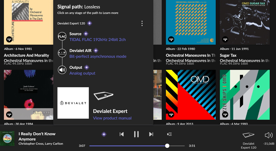

for example: 25-03-2026 at 22:02 local time. Track name: I really Don’t know anymore by Christopher Cross - Source TIDAL FLAC 192kHz 24bit 2ch
The issue appear at the moment when someone searches other songs at Roon app.

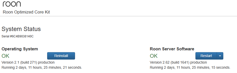

Roon Server running only 2 days:
