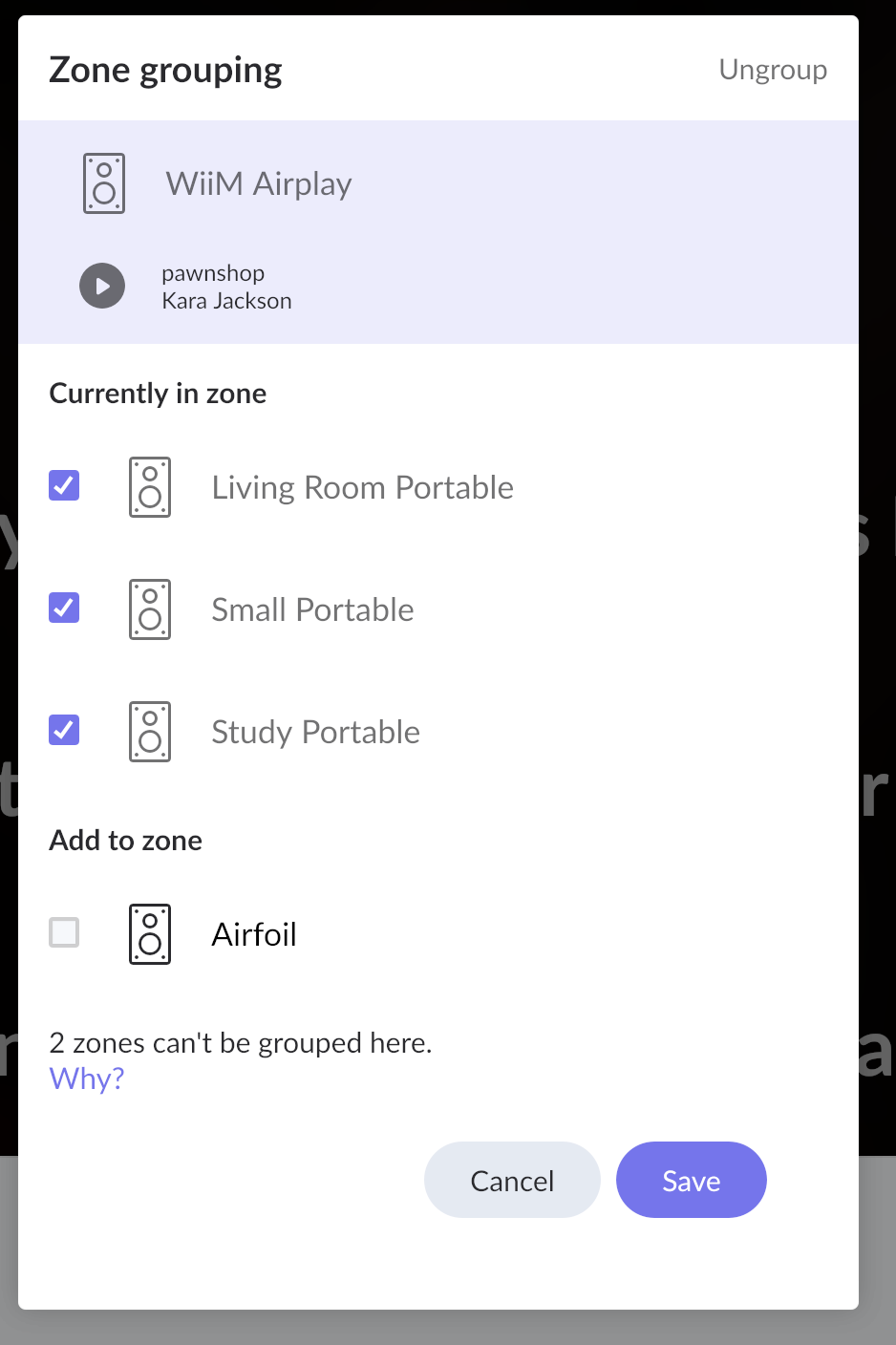

The issue happens when using grouping in Roon (see screenshots)
As a workaround, I have tried used Airfoil running on my mac to group the speakers and then output from Roon to Airfoil as a single output. The sync issue has never happened with Airfoil.
