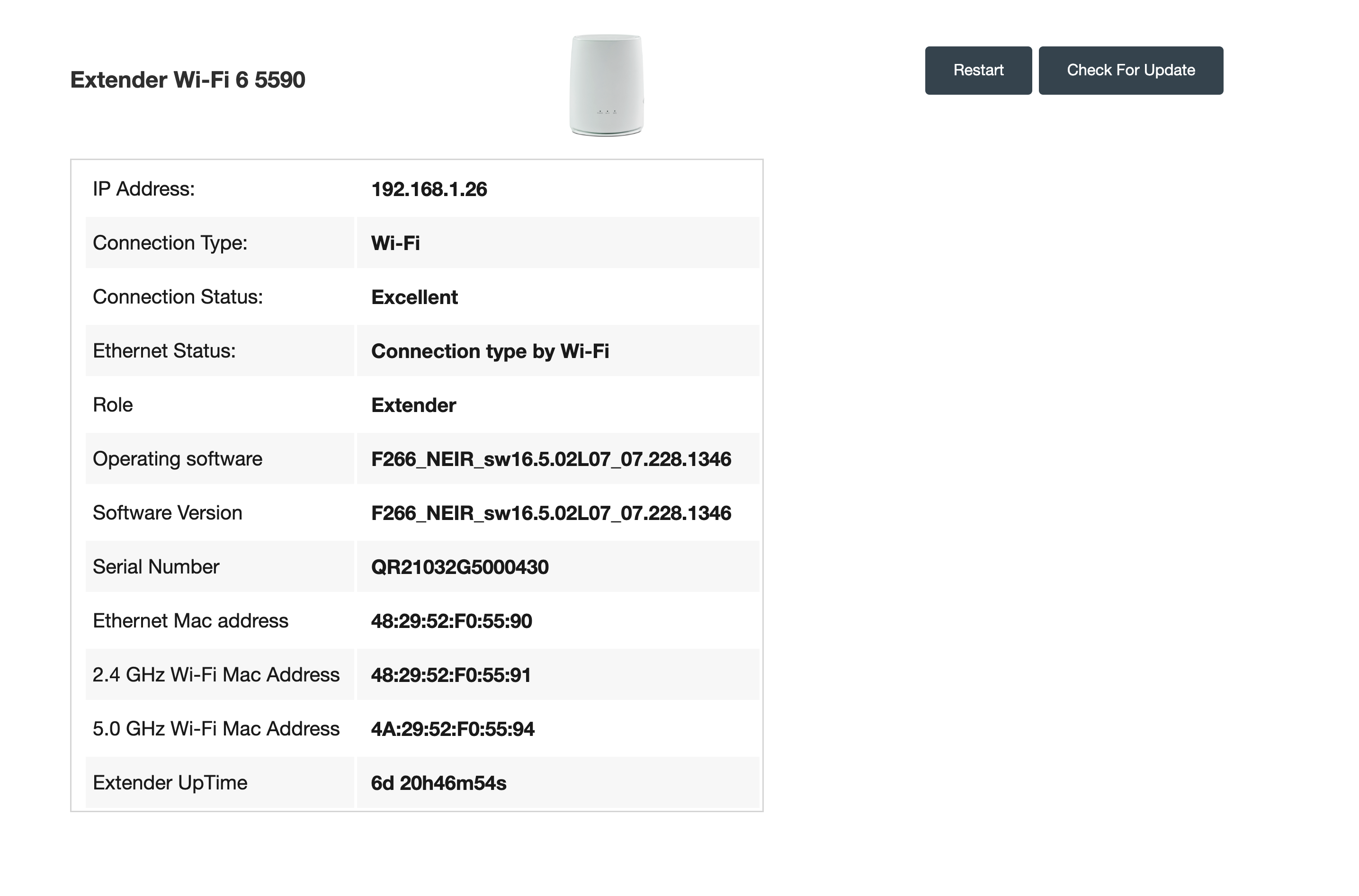

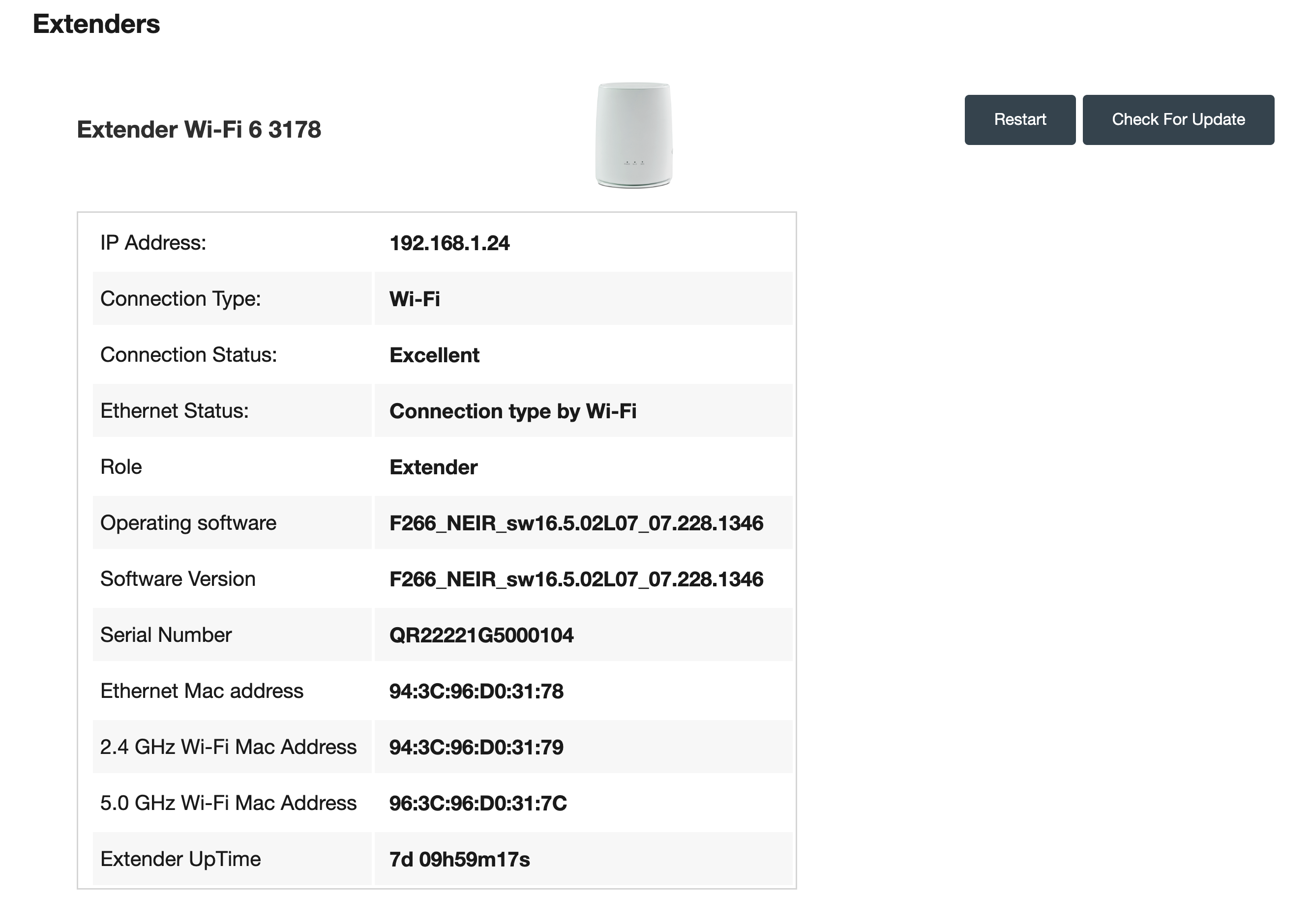

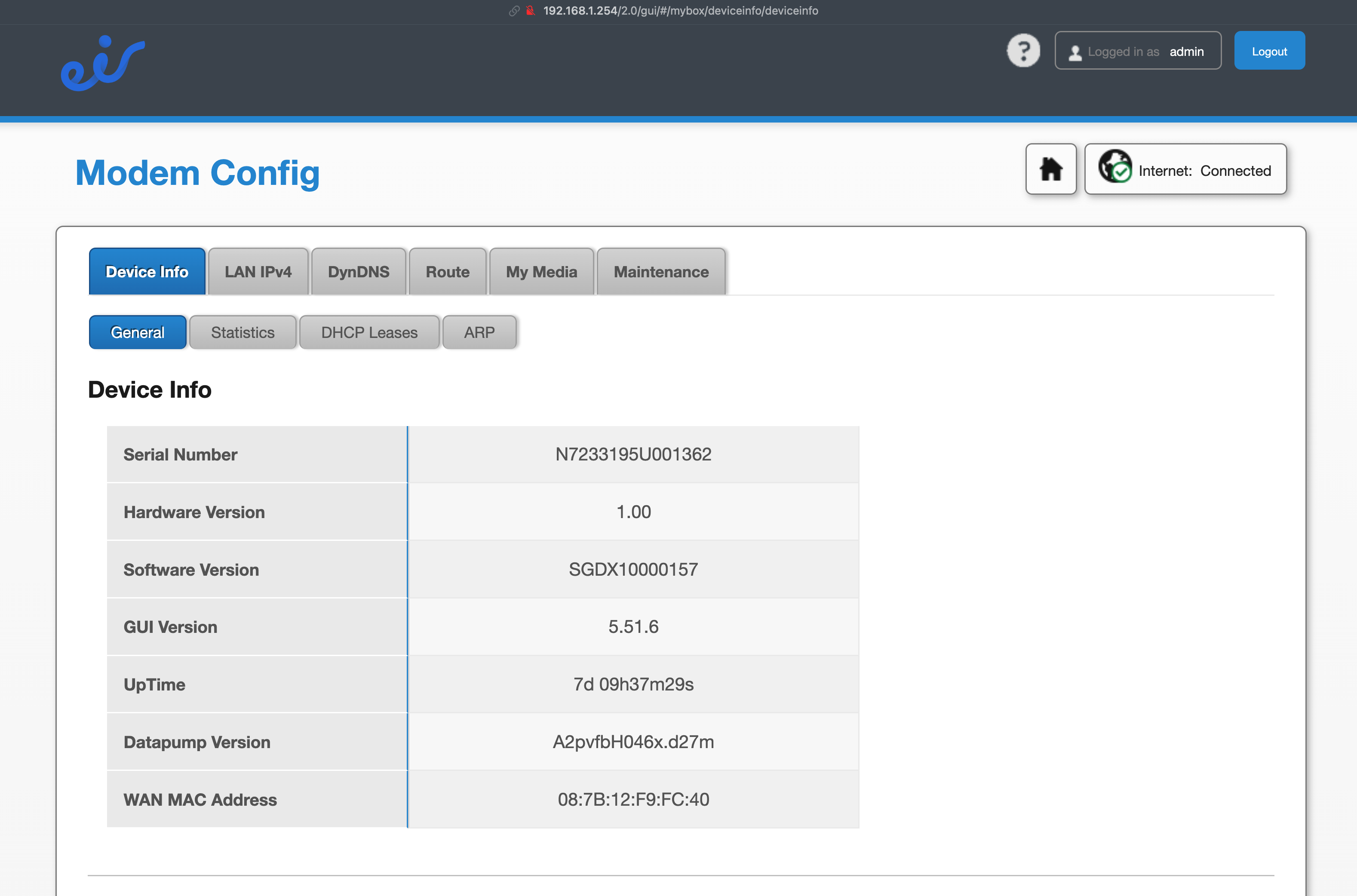

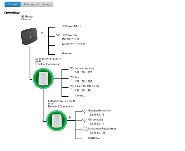

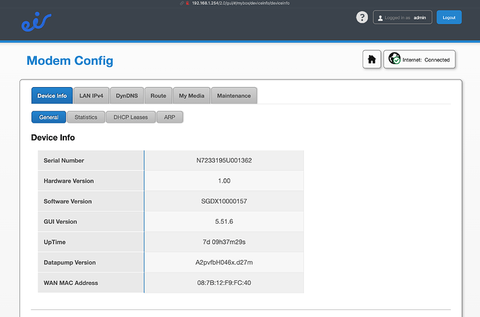

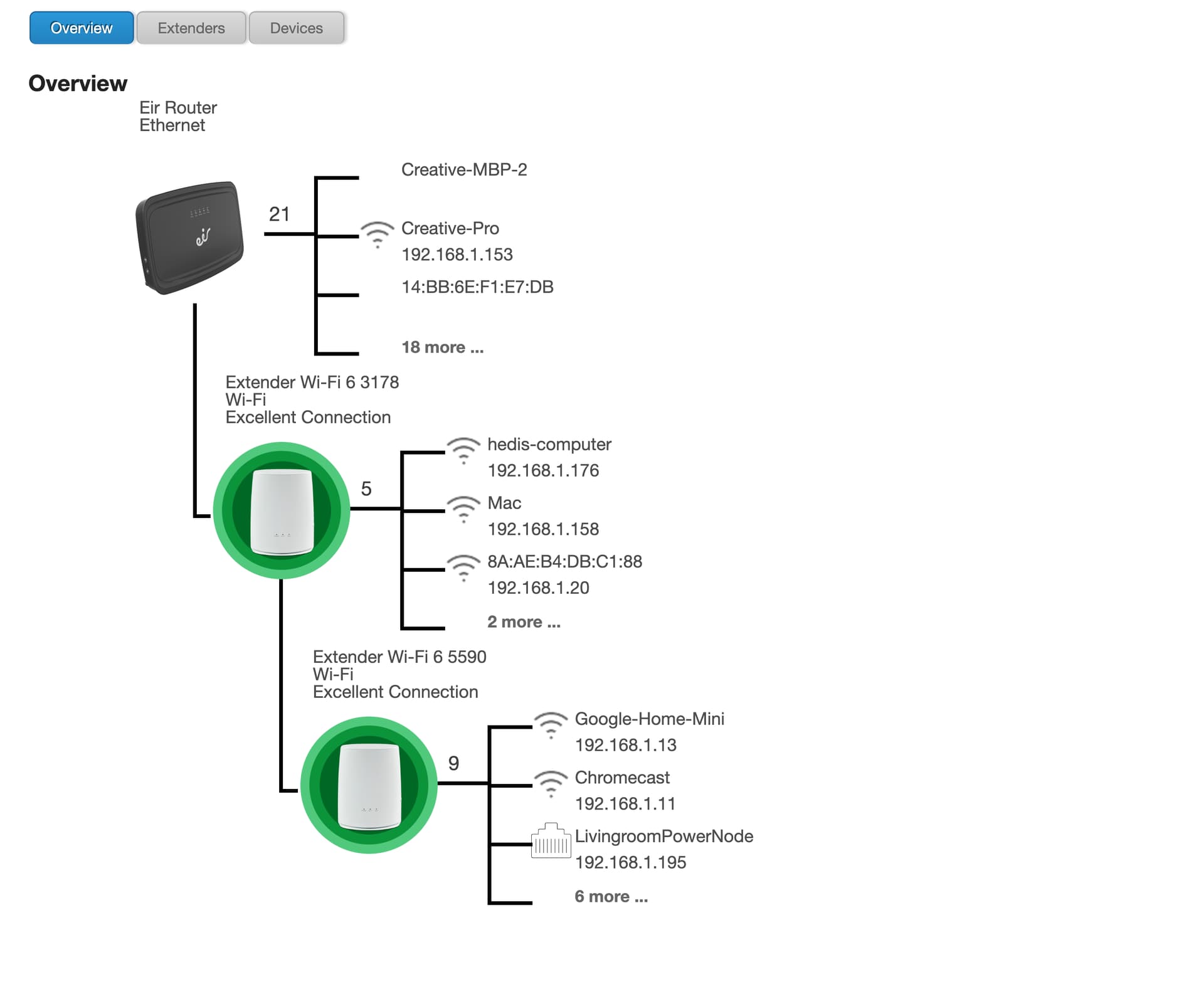

First, please share a description of your router and any managed network hardware (like switches or access points or mesh nodes) servicing these BluOS endpoints.

Hi Connor and thank you for coming back to me. Roon/Roon Server already had automatic access granted inside that Privacy & Security → Local Network settings area. Inside my office my Node2i is connected to my main broadband provider Eir router (Sagemcom). I have 1GB Fibre to the Home Broadband with 100GB upload speeds. I personally think it must be something else, as this stopping issue does not happen when I’m using my Bluesound Desktop app as my primary audio controller and controller of my grouped Bluesound Devices, it only happens when I use Roon as my primary music player software.
Please see attached some additional screenshots of my Network setup. I’m not super technical, so apologies if I struggle to get you the exact info you need.

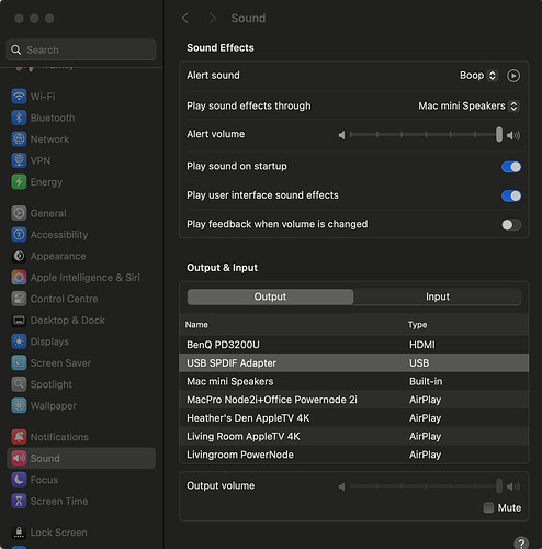

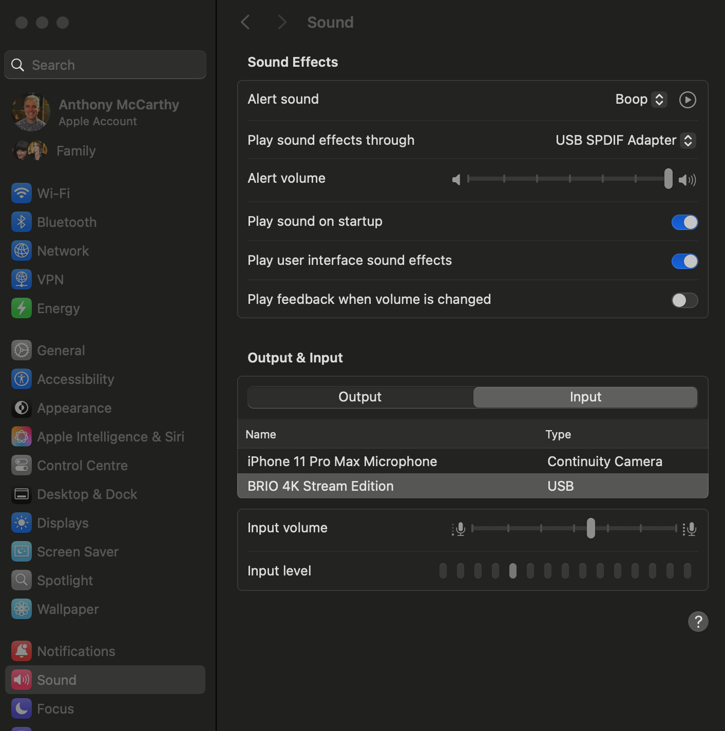

I also just noticed right now while I was getting these screenshots for you and also playing an album using Roon, was that as soon as I took a screenshot using my Parallels Toolbox software the audio instantly stopped playing. I also noticed last night that while I was listening again to an album using Roon and I went on my browser to check out my X social media account the audio instantly stopped also. I reckon it’s something else… I just noticed now also that when I reverted back to using my Bluesound app to play my music… and I selected my Tidal app to play an album, but selected the Node2i and Office PowerNode as a group, and selected the Tidal Connect option… I then tried a another screen grab using my Parallels Toolbox screencapture app, it instantly went from playing my music through the Tidal Connect output feature to the System default. Could it be something to do with the system audio… so that when a screen capture is done it normally makes a click or photo shutter type sound and the audio that outputs changes the settings in some way… not sure if that makes any sense… if I do the same screen capture while using the Bluesound app audio device grouping using the system default settings, the image captures, makes the shutter noise and the album playing in the background continues playing without interruption.
More screenshots
I hope this helps a little more.

Looks like you are both playing your MacOS sounds and roon through the same spdif adapter into the bluesound ? That can’t work …
Also tidal (MQA)trough the usb input of the node is known to be a issue

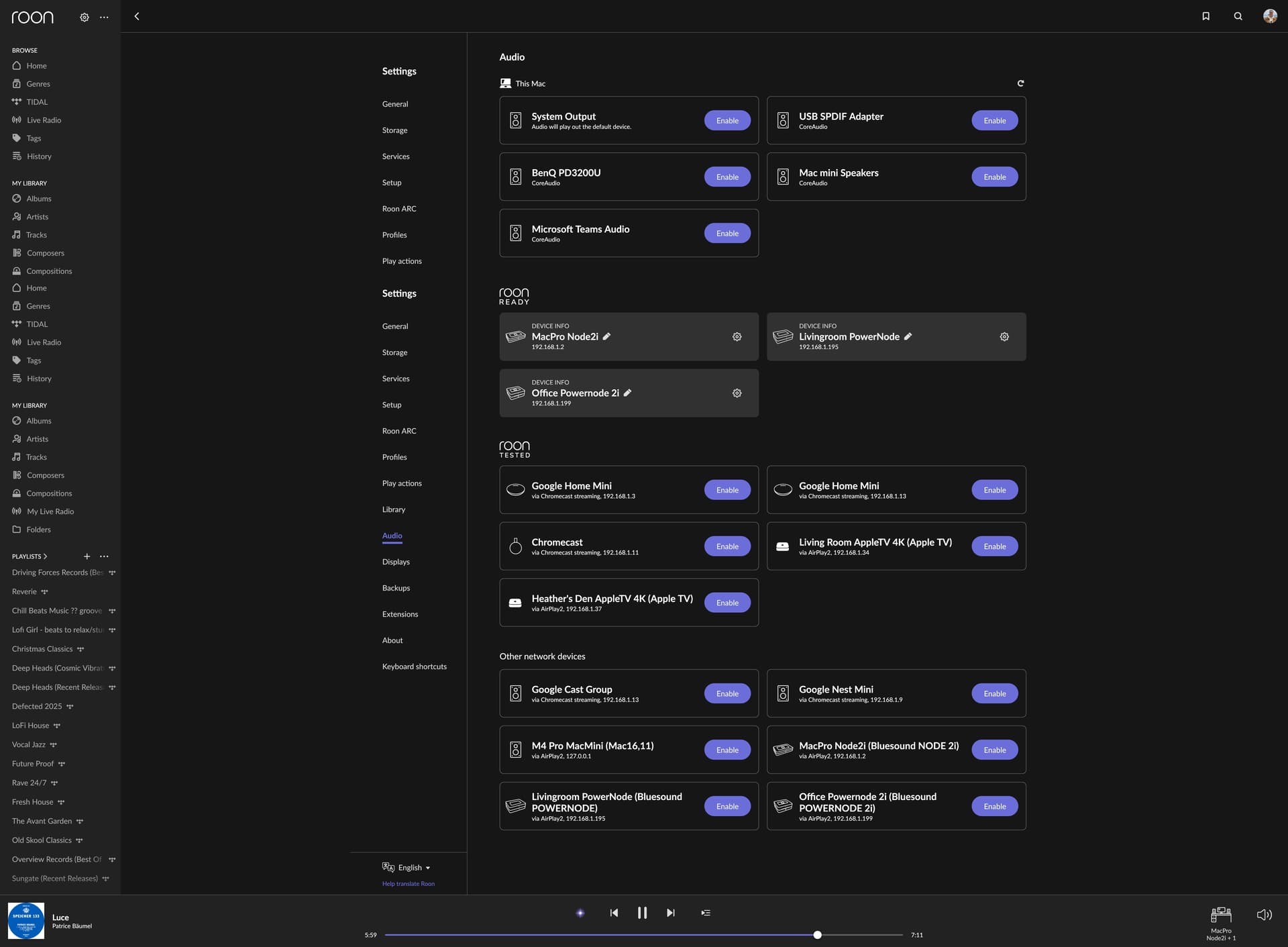

OK… so I have changed that to having the macOS sounds play out through my monitor speakers and that seems to be working better for now for sure. Can you have a look at this screenshot of my audio setup inside Roon to see if there’s any other stand out problems I might have created…?

Your roon settings look alright.
I believe there was a glitch with bluesound devices doing the MQA unfolding through USB .
I would just avoid MQA.
