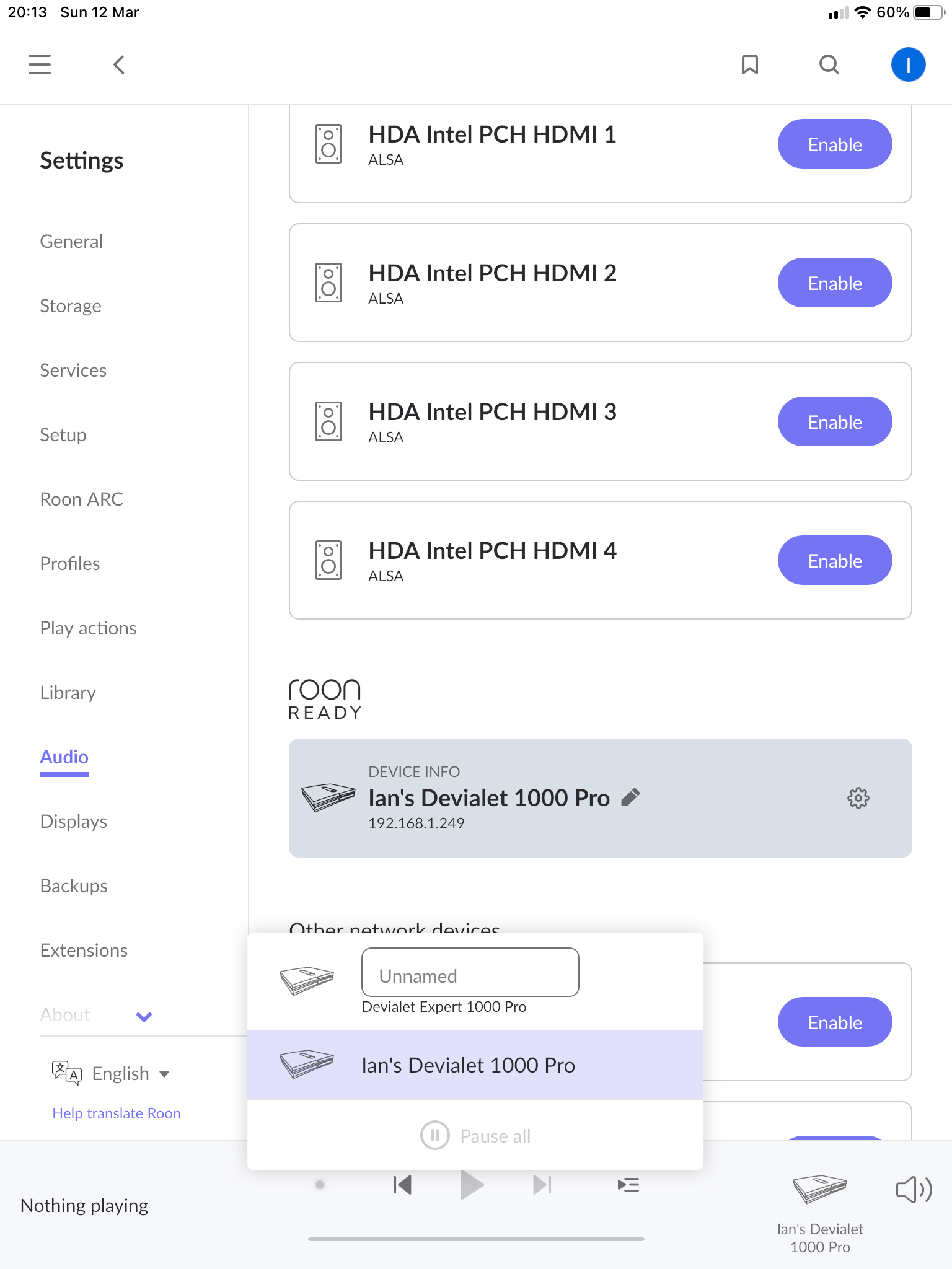

Audio Zone deleting... and playback reliability issues!? đŸ˜©
Intel NUC i5 Roon Core Machine
BT Broadband and router, network switch and Ethernet to Devialet, using Devialet Air
I have only just Re-started using Roon again
after a couple of years with no setup, etc

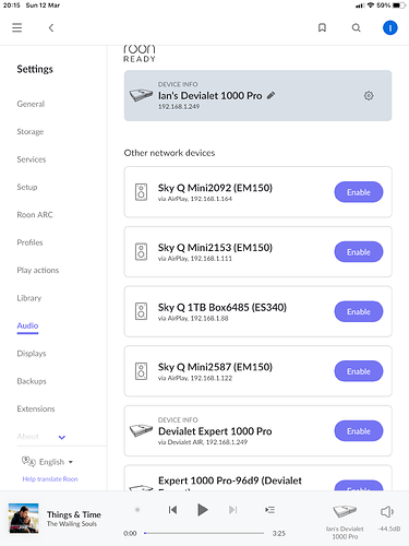

Hi, my internet speed seems fine, but my system reliability to actually stream music is very poor.

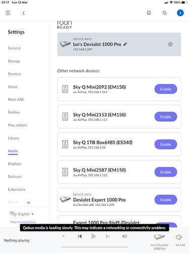

It seems that it either states that my Devialet is already in use, or that I may have two
or more Devialet outputs
I want to DELETE (not simply ‘disable’) all possible ambiguity in the system, but it seems there is no simple answer?! Whyever not, as surely we should be able to delete unwanted items!?
HB. This is my very first question here
please help?
Thanks in advance, Ian

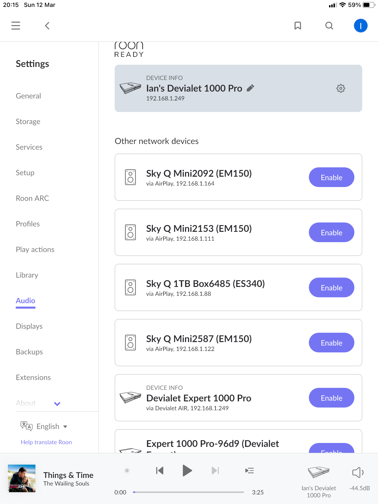

PS. It appears I may seem to have three Devialet item options with identical IP addresses ending in 249?
I wish to delete two of them; how can I do this?

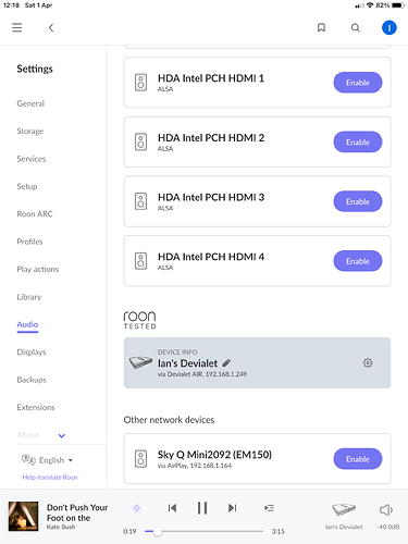

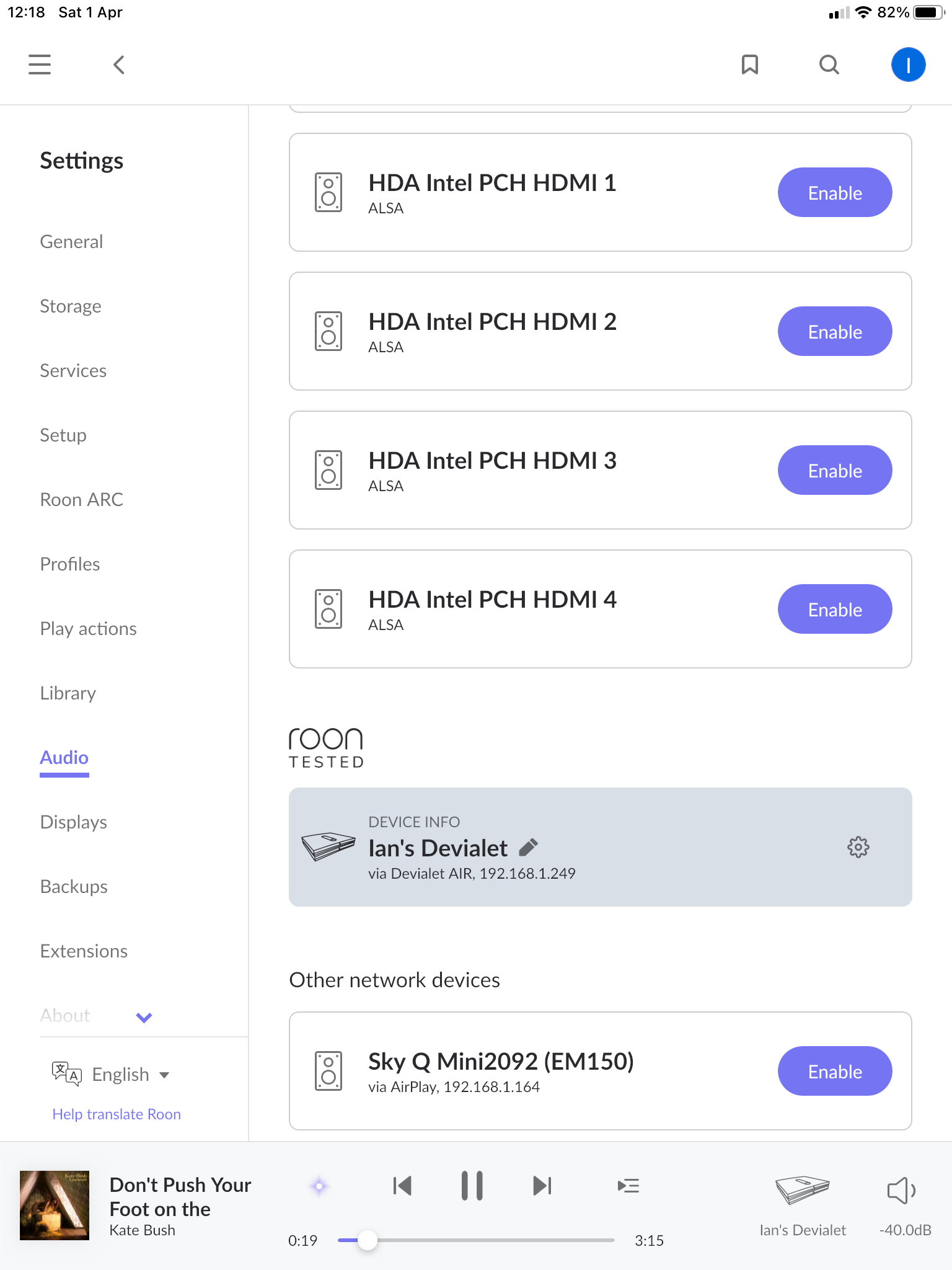

The Devialet appearing several times in the Audio Settings is not an issue. If a device supports more than one option, e.g., Roon Ready, Devialet AIR, and Chromecast or whatever, it will show up in Settings > Audio for each of them. One user might prefer Devialet AIR and another Roon Ready, for instance.
You can’t delete them because then how would you later switch to another variant if you want? This is the Audio Settings configuration, it shows everything that is available from your devices. Just don’t enable the variants you don’t need and forget about it.
Any device / variant that you enable here in the Audio Settings you can then choose from the zone output button. If you enable two variants for your device, you can choose either as a zone. Should normally not hurt but clutters up the zone menu.

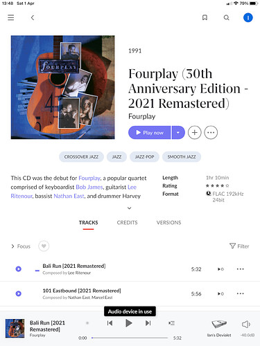

Hi there, I am still getting intermittent issues with the connection to my Devialet using the NUC. I’m assuming it is some sort of network issue, as you suggest
but I am no expert and I am at a loss.
The Devialet should have a fixed IP address surely
and so should the Roon Core, etc?

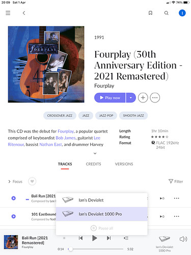

On some occasions (relatively few) the correct Devialet name is recognised and plays flawlessly, but mostly the correct named Devialet is not recognised, another is somehow substituted
and the bloody thing will not play at all.
Sometimes I get as far as being able to select the correct device name
and it may even start playing for a few seconds, but then it stops and gives me the message that no zone is chosen!? Surely the whole thing should work more reliably and simply than this!? Why can I not delete all incorrectly named devices!?
Ian’s Devialet 1000 Pro is the ONLY device that should be recognised, so why the heavens can I not get rid of the others!?
I definitely need more help with figuring this out. Thankfully I have a CD player and turntable that always work reliably through the Devialet.
Any simplified and clear advice steps gratefully received by this network semi-Luddite. :weary::crossed_fingers:

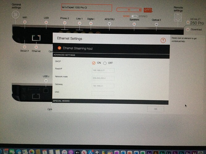

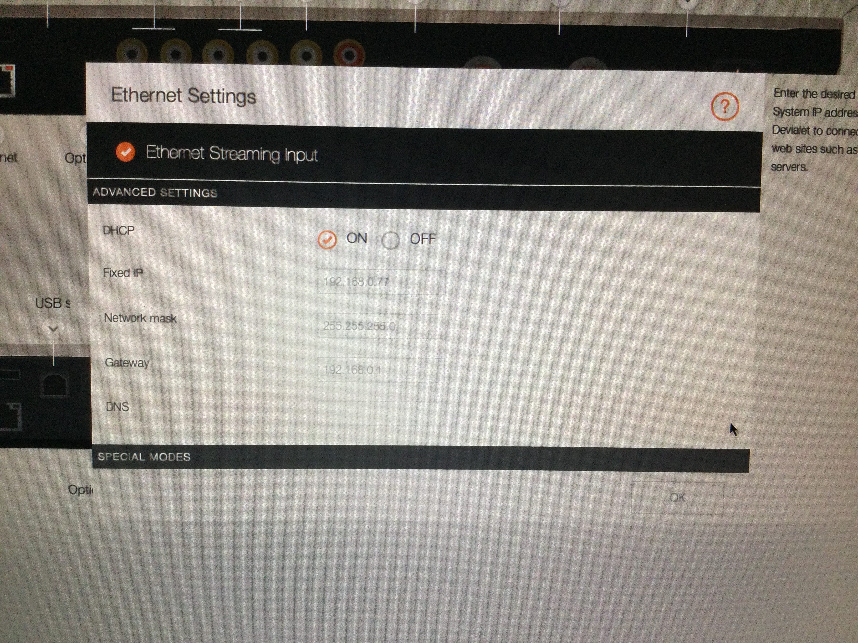

I have checked in the Devialet Configuration and for the Ethernet I see the following:
Add images
DHCP is ticked as ON
However
 there is a background fade as shown in the attached photo:
Fixed IP 192.168.0.77
Network mask. 255.255.255.0
Gateway 192.168.0.1

Seems like the screenshot didn’t upload correctly
Hi, it seems to be an issue at the moment. :thinking:

The settings for DHCP are looking good. If they always were like that and rebooting didn’t help, this seems not the issue then. But probably nevertheless some other networking issue, I would guess
