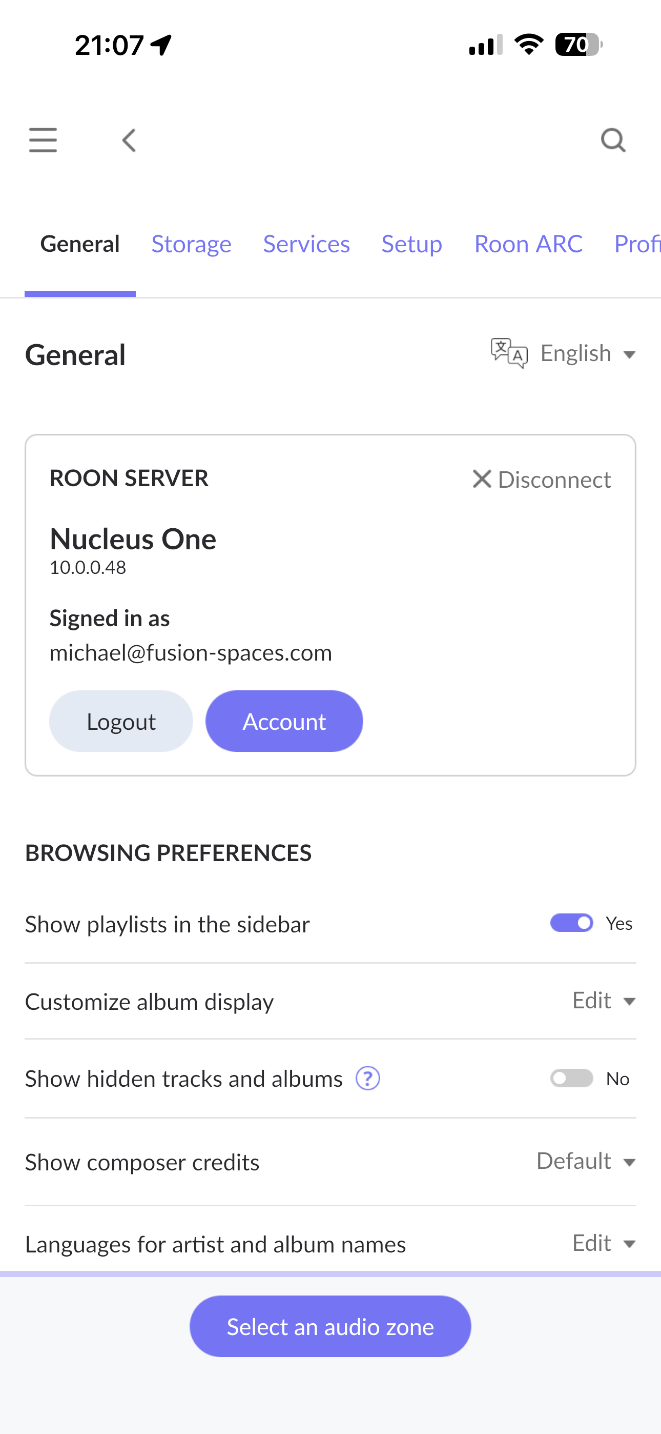

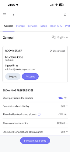

I received the Nucleus One approx 3 weeks ago and it has been working perfectly until the last update.
See attached screenshot showing it associated to my account.
Hi Daniel, I have turned off the Mac mini and put now is showing the rooms/speaskers on the remote app. However my Lyngdorf TDA-1120 in my office is not. I have gone to the web UI for this and it is all on line and connected via an ethernet cable, still not showing as an audio device. My JBL Synthesis is and this is connected on ethernet as well. Any ideas why?
