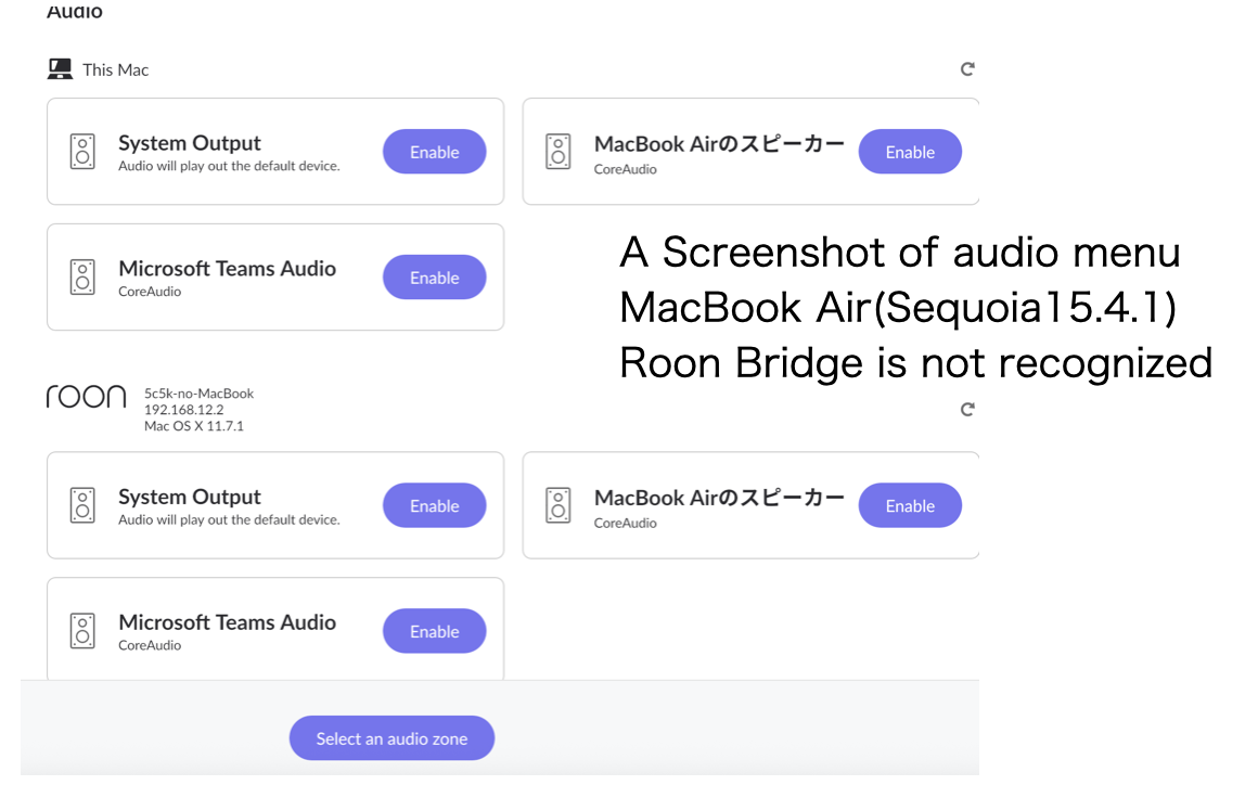

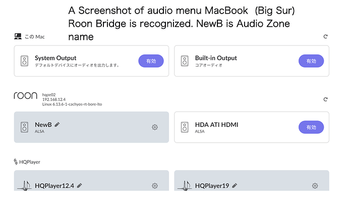

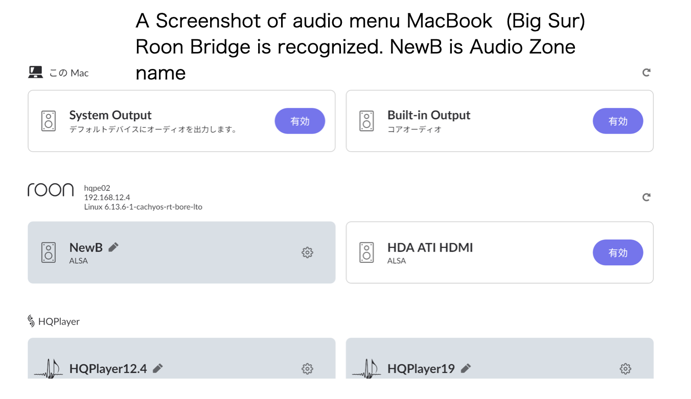

for your information, I’m uploading a screenshot of the Roon audio settings running on Big Sur 11.7. When using the Roon server on Big Sur, the Roon Bridge is recognized and the audio zones are displayed.
Today, Roon was updated, so I tried updating the Roon server on Sequoia 15.4 as well, but the Roon Bridge was not recognized and no audio zones were shown. (Of course, the Local Network setting was turned ON/OFF during testing.)

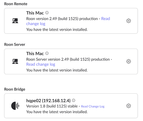

Thanks for the additional information. Can you please share a screenshot of how your Roon Settings → Audio page looks like? I know you mentioned you having both a Big Sur and the Macbook air, but what is strange is that they are both showing as having the same IP, perhaps this is an IP conflict?
Hi noris-san
As I mentioned earlier, the audio network is connected via wired Ethernet and there is no Wi-Fi. Also, since there is only one Ethernet adapter, I switch it between the Big Sur Mac and the Sequoia Mac.
Because the addresses are assigned via DHCP, both Macs are given the same IP address, but they are not used simultaneously.
I’ve attached a screenshot of the Audio menu.
Today, an update for Sequoia was released, so I installed it, but the issue was not resolved.

Thank you for the screenshots, it does look like the Mac is not detecting the Roon Bridge for some reason. The Roon Server is hosted on the other Mac, is that correct? Can you try to perform a reinstall of Roon using the below instructions on the Macbook Air (not on the main Roon Server) and let us know if this helps? Thanks!
