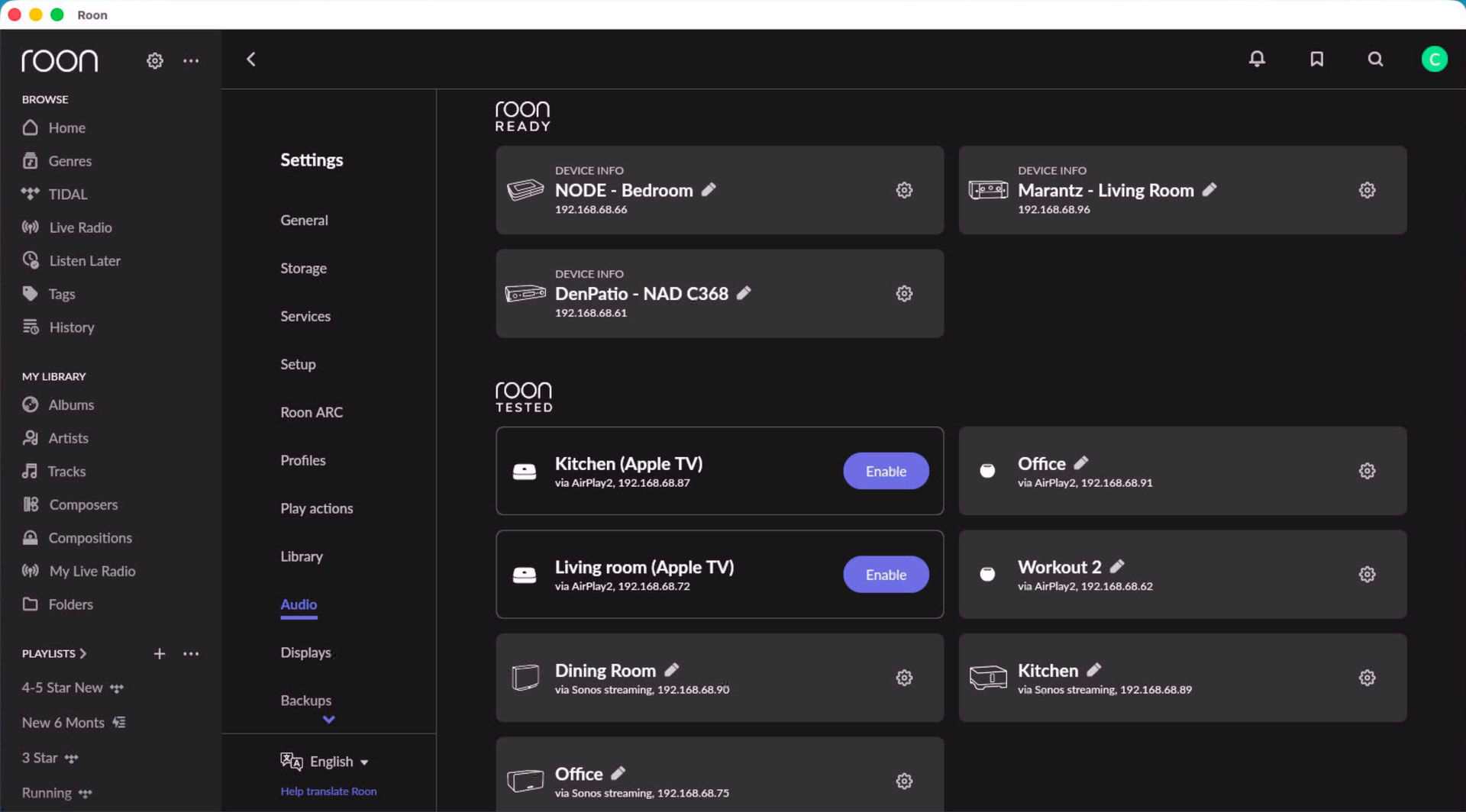

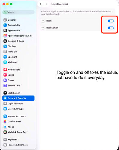

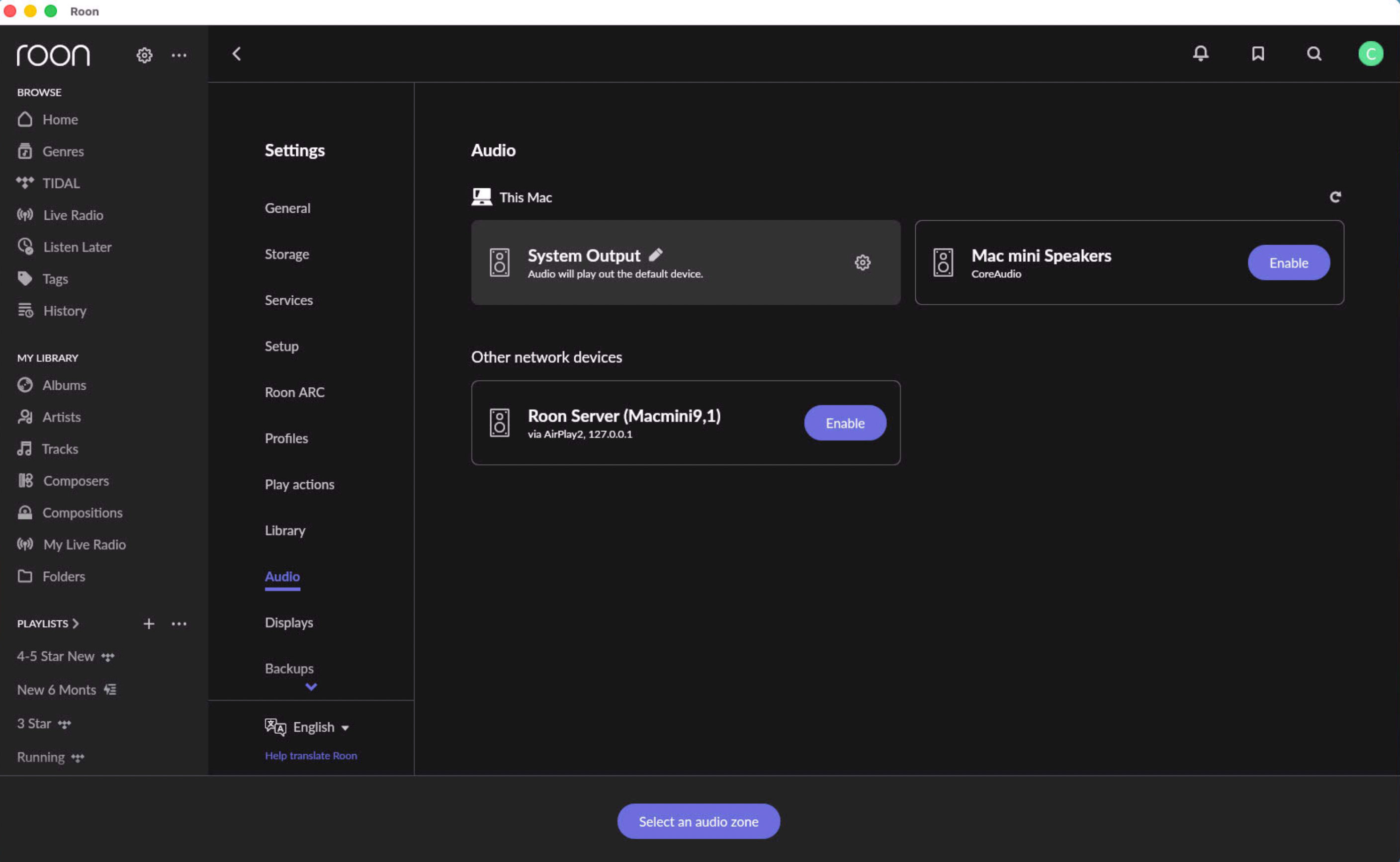

Audio zones not showing up after Mac computer restart. I have to toggle Local Network access on and off after every startup. Did not have this problem until Roon updated recently.
Mac mini M1 (ethernet), Tahoe 26.4, Roon Server 2.64 (build 1646)
Mesh Network - Deco XE75
All audio devices affected.
Mesh Network - Deco XE75, Mac mini connected to main Deco unit via ethernet.

Thanks for sending the screenshots.
Please note the exact local date and time when the Zones are missing, and then the time when toggling Local Network access brings them back and let us know here.
Do you also have Full Disk Access enabled for Roon, and does anything change with regard to the behavior if you turn that on?
