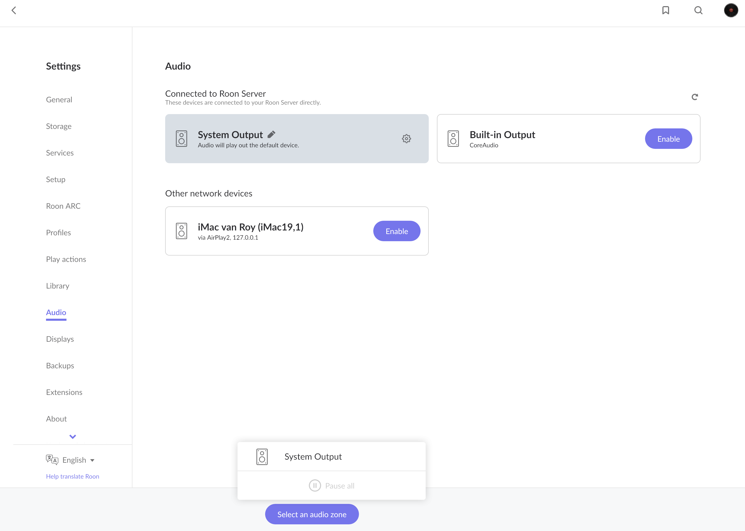

After every update all audio zones are missing. I allways have to restart the Roon app on the server (iMac 27") to get the audio zones back. After the restart everything works fine. Not a big issue but it is annoying.
Everything is connected to one cable modem/router (Ziggo)

It appears that you’re affected by a known issue currently under investigation by our R&D and Support teams.
We’ve enabled diagnostics on your account and have successfully collected logs from your devices. As an additional data point, we would greatly appreciate it if you could share the macOS crash report that occurred after the upgrade.
If you’re willing, please check the Console app (Applications → Utilities) for any crash reports related to RAATServer and Roon , and upload them using the following link at your convenience: Log Uploader
