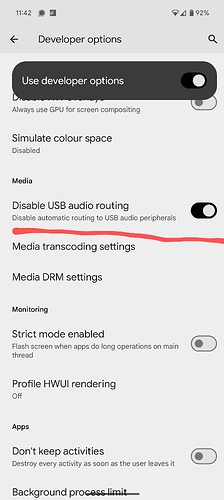

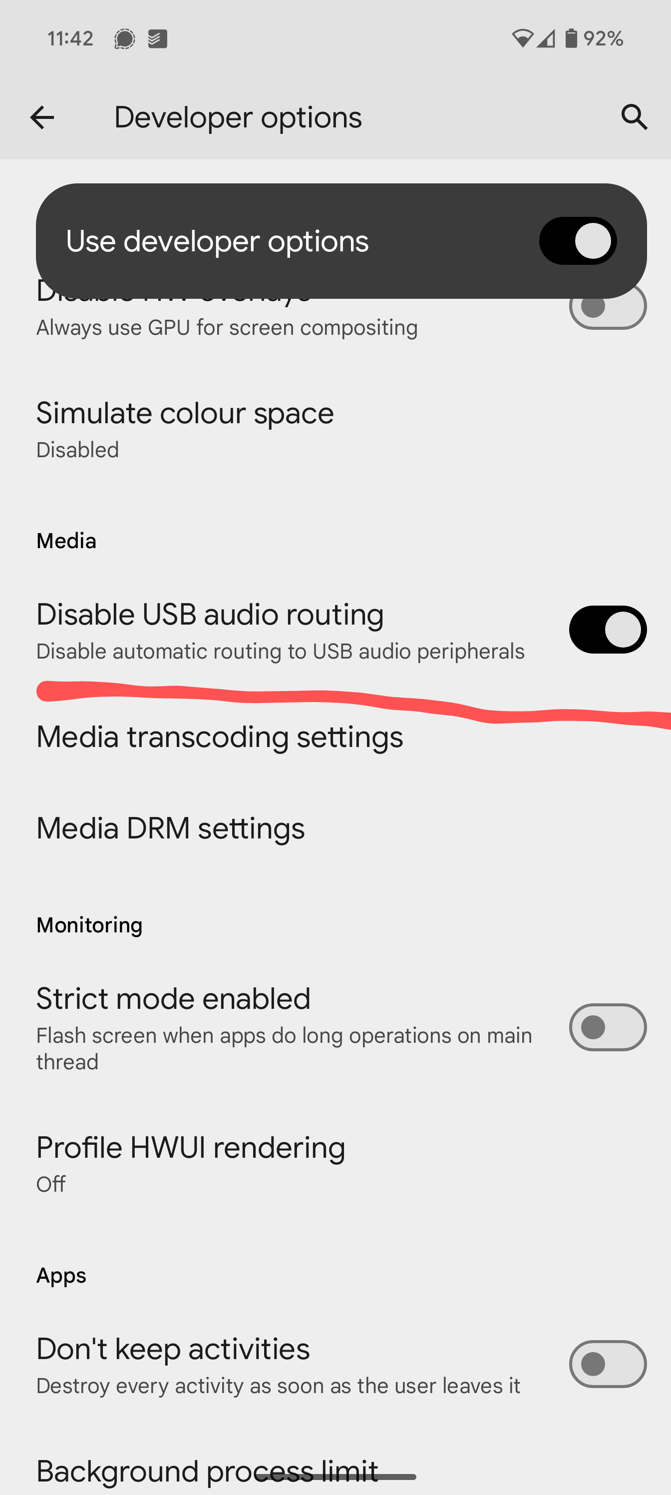

Managed to fix this issue almost immediately after posting this. Thought i’d add a follow up for anyone having the same issue in the future on newer versions of android …
Disabling USB audio routing in the developer options will fix this. These options aren’t visible by default but are very easy to enable
