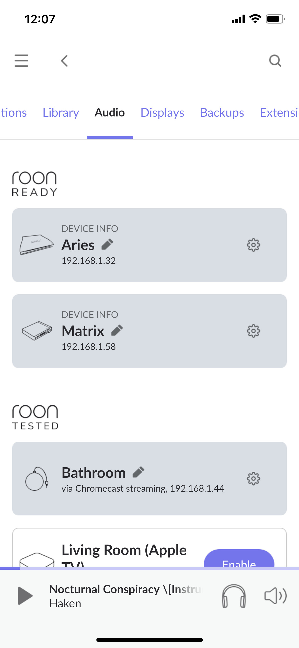

I normally use the Aries connected via Coax to a Heed DAC. The Aries icon has been showing correctly for years. Lately I tested the Aries on a USB DAC (Teac UD507) and used the TEAC Icon for that zone. Now I reverted back to the Heed DAC via Coax but the icon is stuck with the Teac one. I can see the Aries is recognised and see its icon in the set up screen, however when I try to change it in the zone icons list I only get the TEAC as default one (see screenshot).

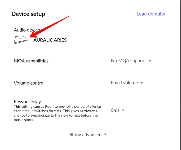

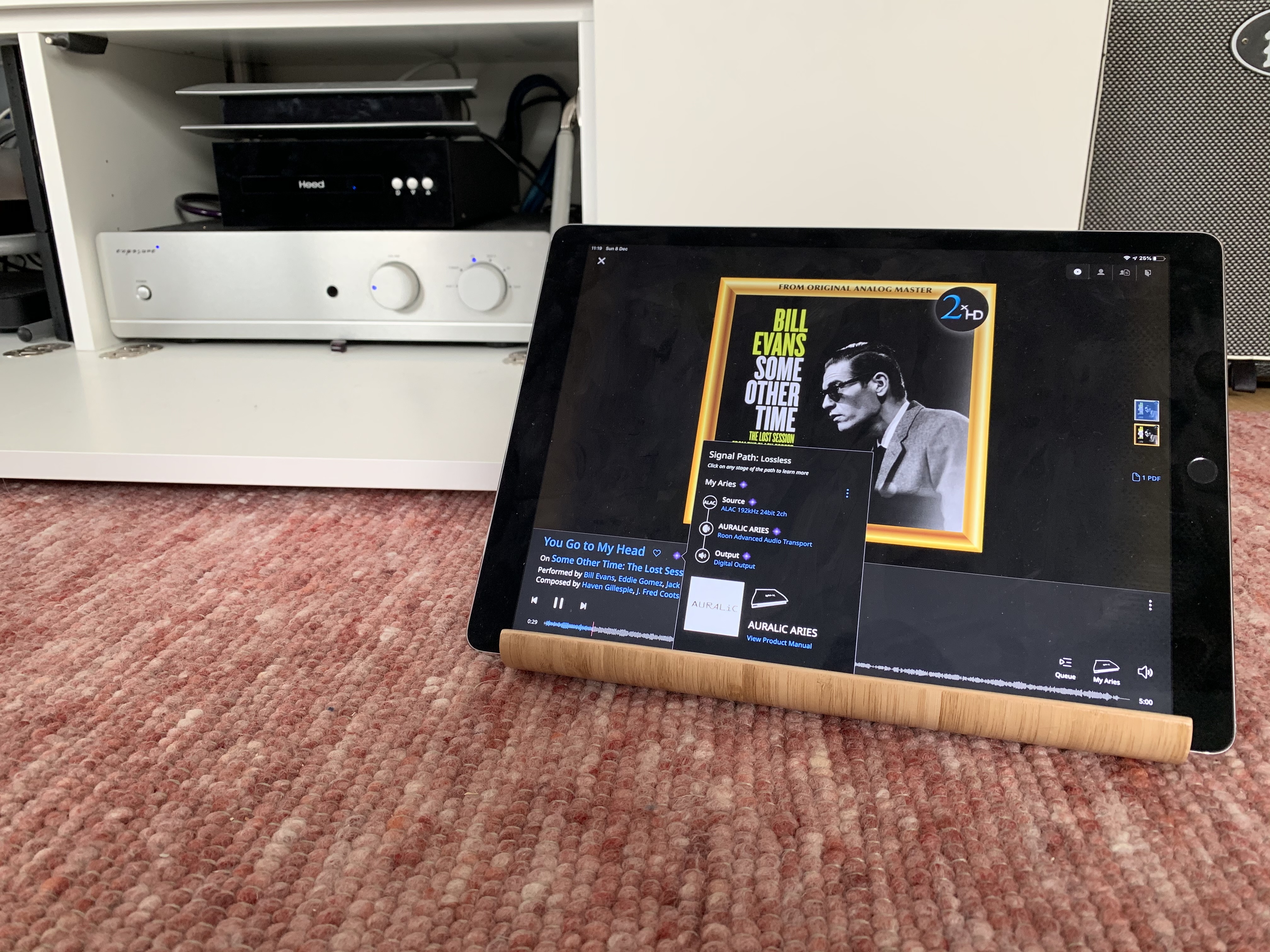

Here is an old screenshot of the Aries icon correctly showing

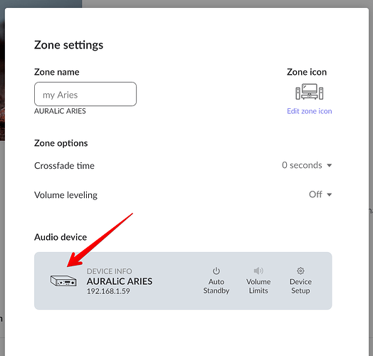

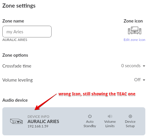

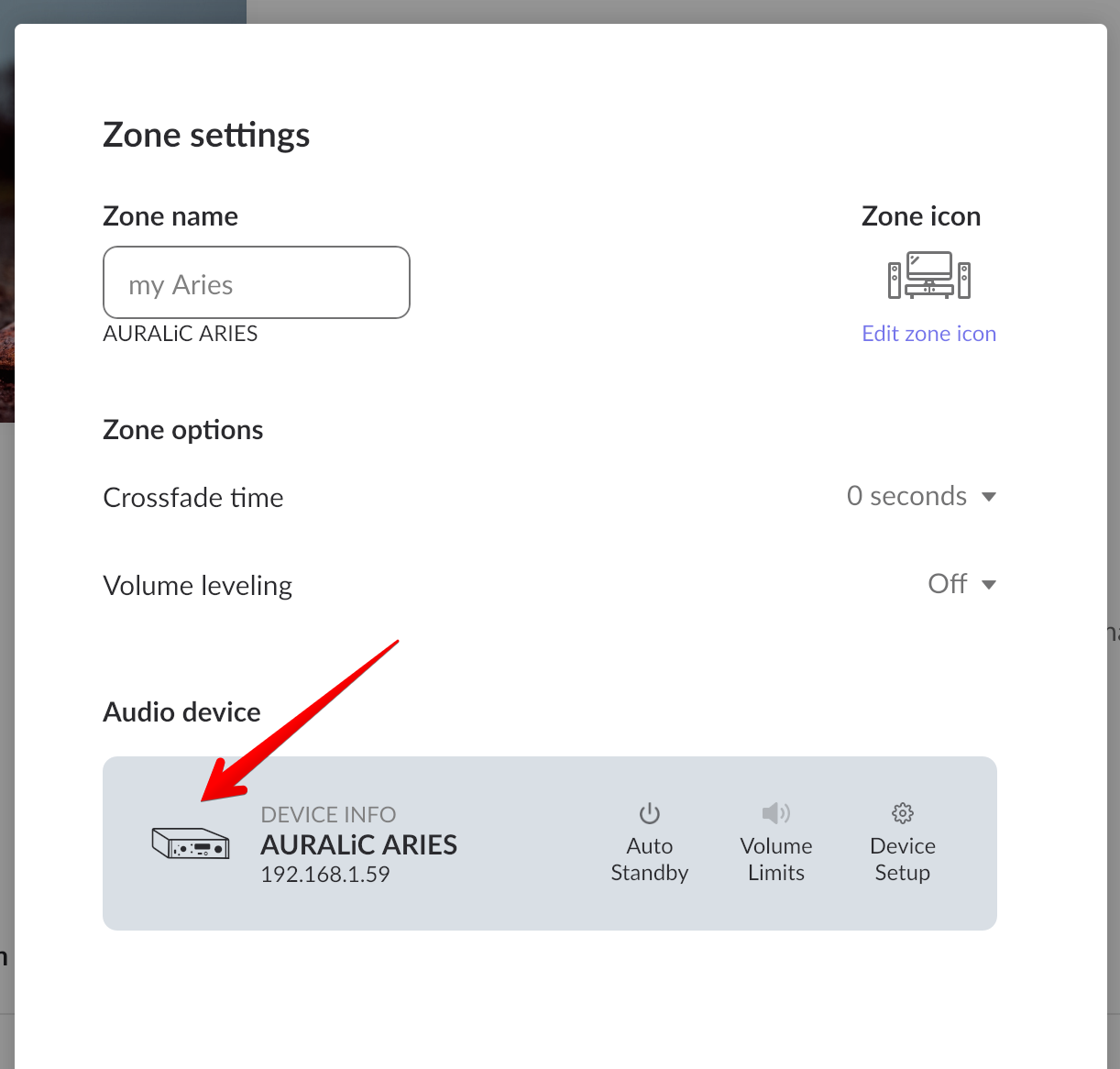

the icon shown on the “Zone Setitngs” is incorrect because that is the TEAC icon:

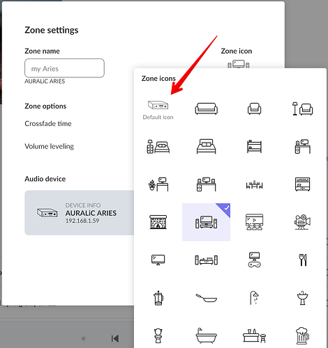

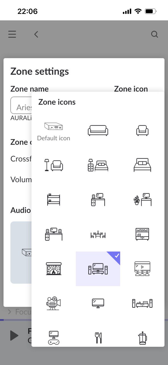

When I click “Edit Zone Icon” I get an incorrect icon again because it’s showing the TEAC as the default one and then different Roon icons. The Aries Icon is not there:

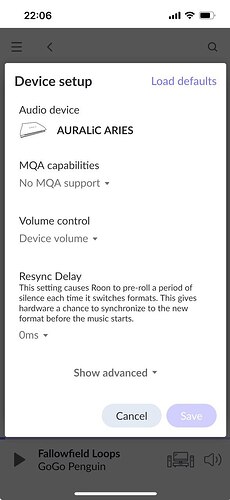

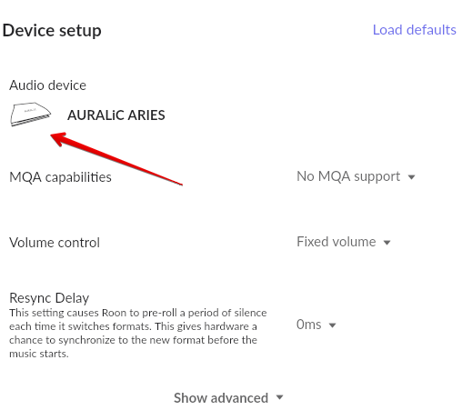

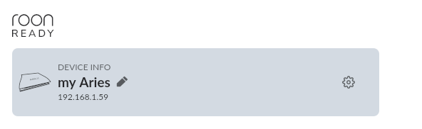

the icon shown in the “device set up” screen is the correct one:

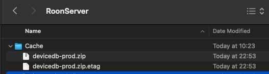

  4. Open the folder named “Cache” inside your Roon folder
  5. Delete the file named “Devicedb-prod.zip” and “Devicedb-prod.zip.etag” if you have that file as well
  6. Start Roon once more on the server machine from WebUI
Let us know if this helps!
thanks Noris,
I did this procedure as well
The 2 files deleted were immediately re created as soon as I started the server again :
Unfortunately it did not work and I still see the wrong icon :frowning:
The correct one is available only in the device setup screen:

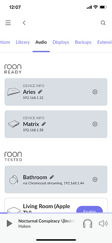

Yes, the Aries is connected via Roon Ready:
