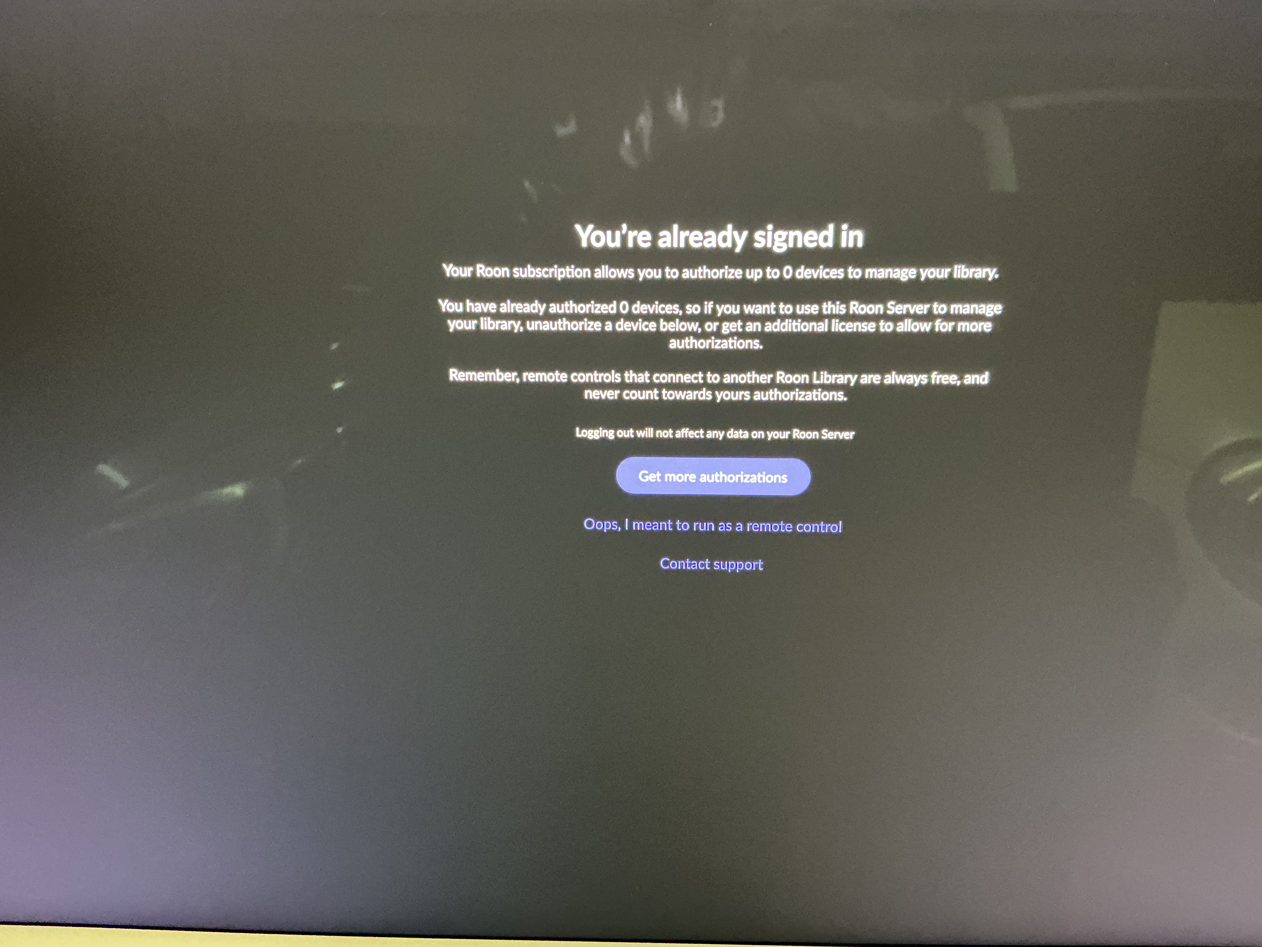

Authentication issue post-update with lifetime subscription (ref#WYRDTF)
· After updating tells me I am already signed in and then tells me to get more authentication then wants me to subscribe but I have a lifetime subscription
· Roon is on an iMac and the music is stored downstairs on a hard drive
Is this screen photo complete? Does it show the whole screen?

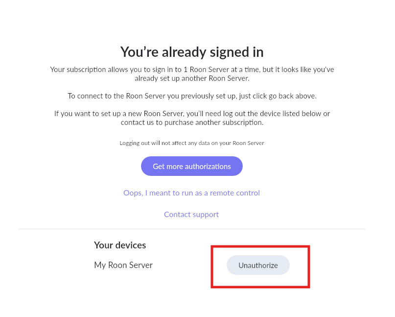

Normally, when that screen is shown, there is an ‘unauthorize’ button in the bottom right of the screen. Selecting this will remove the association of your licence with any previously used server and allow you to set it up on the new one. No Roon database or music storage is lost during this procedure.
One reason that this is sometimes required is that Roon occasionally gets confused over Server machine identity and thinks you are trying to use a different server when in fact the same server is being used.
The strange thing is that it normally says „your subscription allows you to sign in to 1 Roon Servers at a time“, like here (and shows the Unauthorize button):
But in @keyse1’s case it says „authorize up to 0 devices“, so that text (and other text pieces) differs a bit and „0“ seems strange.
And I believe we see the bottom edge of the screen in @keyse1‘s photo, where the Unauthorize button should normally be. The button missing makes sense, I guess, if Roon thinks that there are „0“ subscriptions.

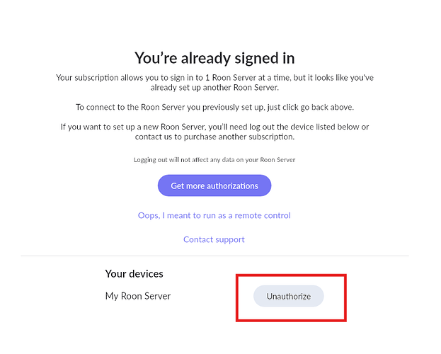

In this case, this is just the occasional Roon confusion. Click the Unauthorize button, then you can choose the iMac as your Roon Server again
I’m still confused by what it showed in your original photo, but maybe it doesn’t matter

What about the suggestion from suedkiez to use the de authorise button and then reselect the iMac as the server
Could that work
Ray
Hello @keyse1 ,
Yes, you can give the unauthorize button a try. Let us know if this helps!
It worked immediately :grinning_face:
Ray
It worked😀
