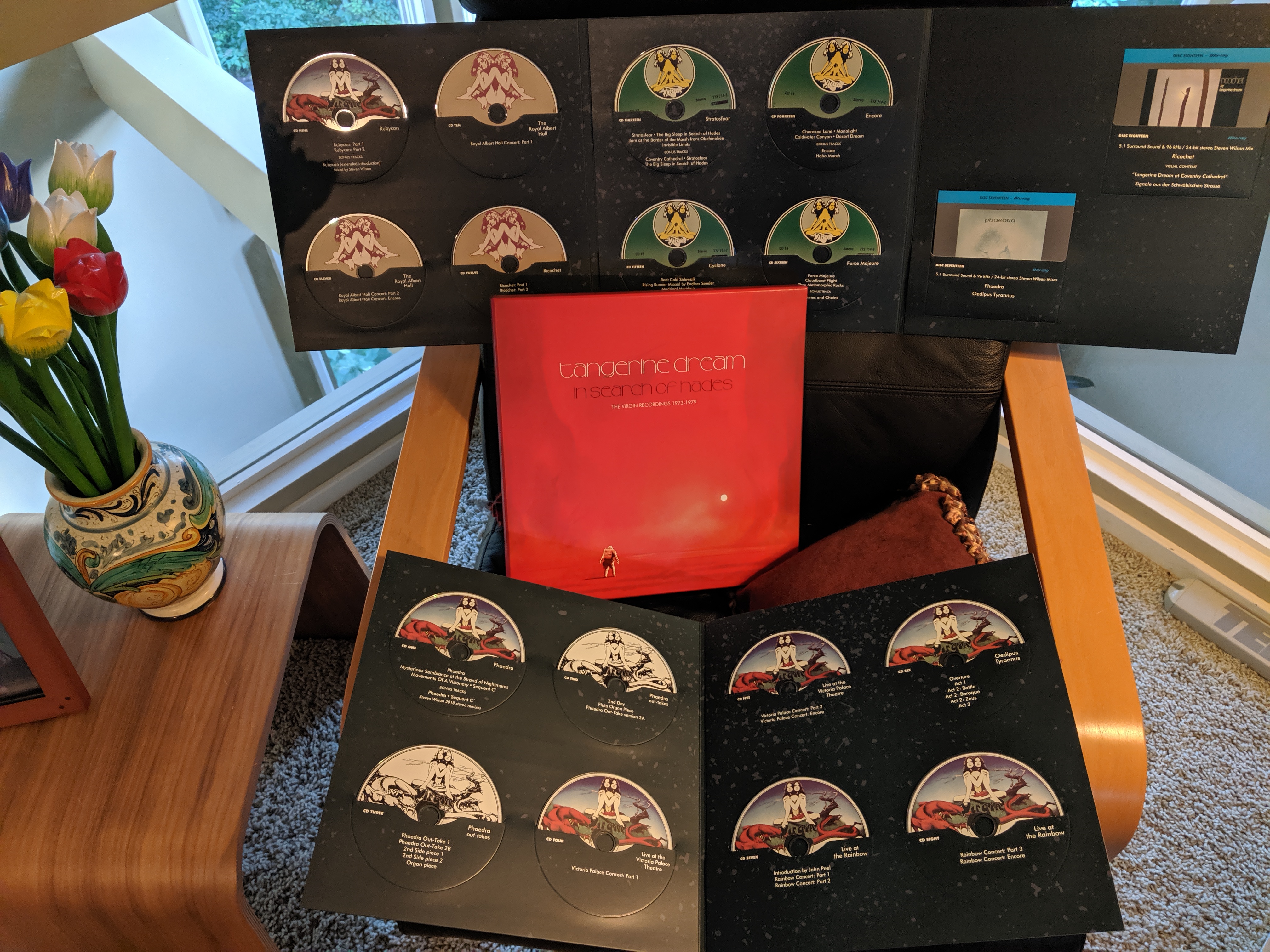

Just received this in the mail:
…all 18 discs. I checked AllMusic.com and the box set is listed:
but, of course, there is no way to label discs within a set (e.g. out-takes vs. live vs. original album). So, I am trying to decide if I want to (a) combine as a box set (i.e. Disc [N]) or as separate CDs with their own cover art and disc title.
I know the Roon folks have stated that they won’t “…just allow one to add a unique album art and title…” to solve the box set problem. But for my collection, that would 100% solve the issue.

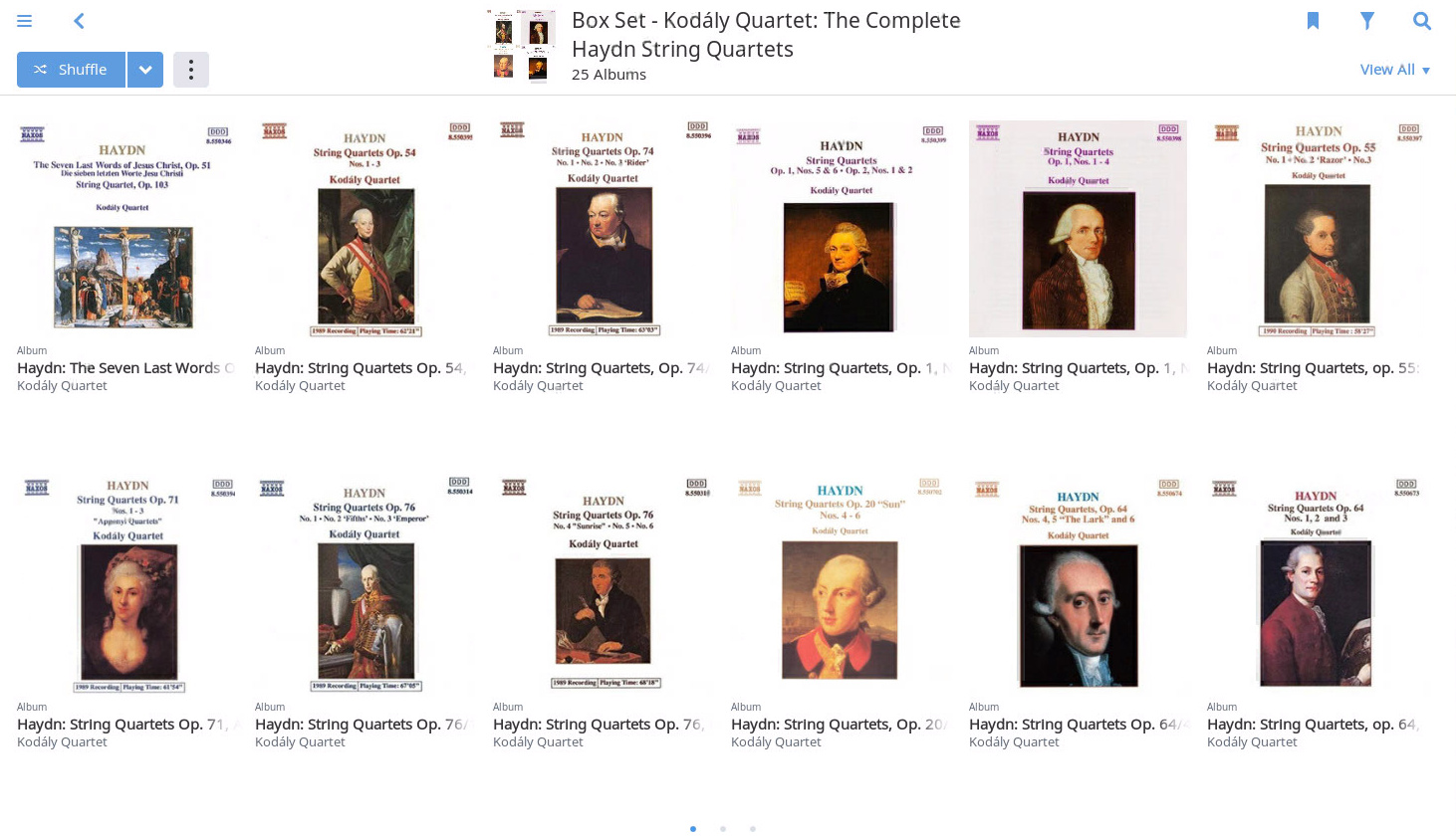

I’ve been using an external ripper (XLD) to create separate albums for each disc. That is, as individual CDs, not as a box set. This works if the box was also released as individual CDs, which is often the case for stuff in my collection (e.g. Haydn box sets from NAXOS).
Then, I restart Roon Server and let it discover the new music. Finally, I add a tag to each album in the box set. Now, I can browse box sets as a tagged collection and have unique cover art and title for each CD.
The missing piece of the puzzle: order of the CDs. You can sort by Date Added, Album Title, Composition (i.e. Work - I love that option), but there is no easy way to assign an ordinal to members of the tagged collection. Yes, I could add a number to the album title, but that’s not right and will create other problems.
Maybe order of the CDs in the box doesn’t matter that much, for things like the Haydn example. But, for other collections, it does (e.g. Simple Minds New Gold Dream Box - the original album, followed by 5 other discs of outtakes, etc.).
Maybe all I would need to solve this last problem would be the ability to designate a PRIMARY member of the tagged collection, which would shows that album cover for the tagged collection and always list that one first. For my non-classical box sets, that would be ideal for everything I currently own.
I use release date, and increment the individual “CDs” by 1 day and then the auto-sort. I just ripped the Michael Haydn: 20 symphonies box. Since they were all individually released prior it was easy identification. However, I wanted them in Symphony order, or I incremented the release date by 1 on each disk so they sorted that way.
