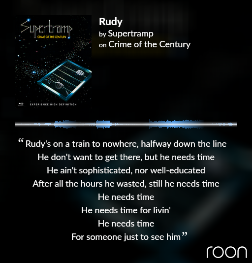

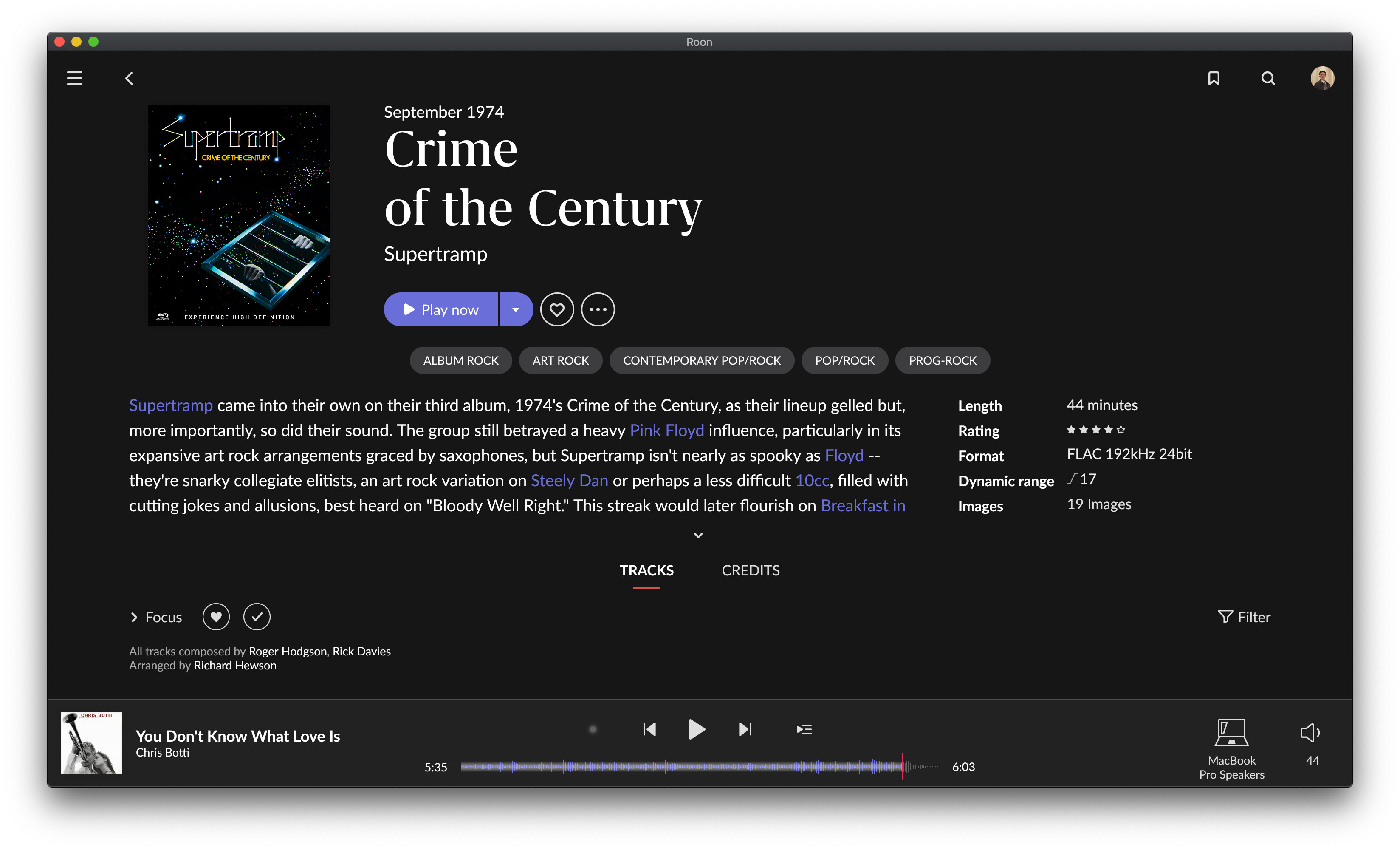

Funny that you asked. Blu-Ray 192kHz version of Supertramp “Crime of The Century” (DR 17+). Especially Track 6, “Rudy” (DR 21.4+).
LRA numbers like that are more typical of classical releases. I can imagine it being a problem trying to listen in a moving car, but the Tidal version (it’s probably the same 24/192 remaster) sounds good at home!
